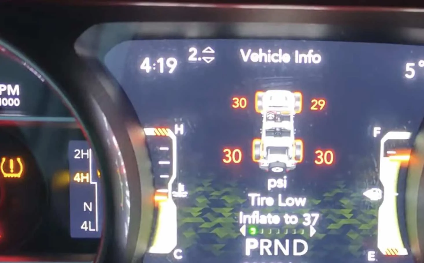

Yeah would not worry too much about your tire pressure dropping in cold temps. It is normal and will go back up once your tires heat up from driving. Since yours did - you should be ok. We leave ours at 30 with the low tire dash display icon lit up 24/7 since we like 30 cold. Allows the perfect contact patch for even tire wear and better wet grip. So does not bother us at all.
To get rid of it - just inflate to 37 and drive a bit and it will go away. Or buy a device to make the icon not illuminate. For skiing - Jay Peak looks like a nice resort.

Actually normal. Even here in FL every once in a while we’ll get a cold (ok, cooler) morning and the tire sensors in my wife’s Rubicon will yell at her to inflate to 37. It doesn’t seem to happen as often in my Willys for some reason.

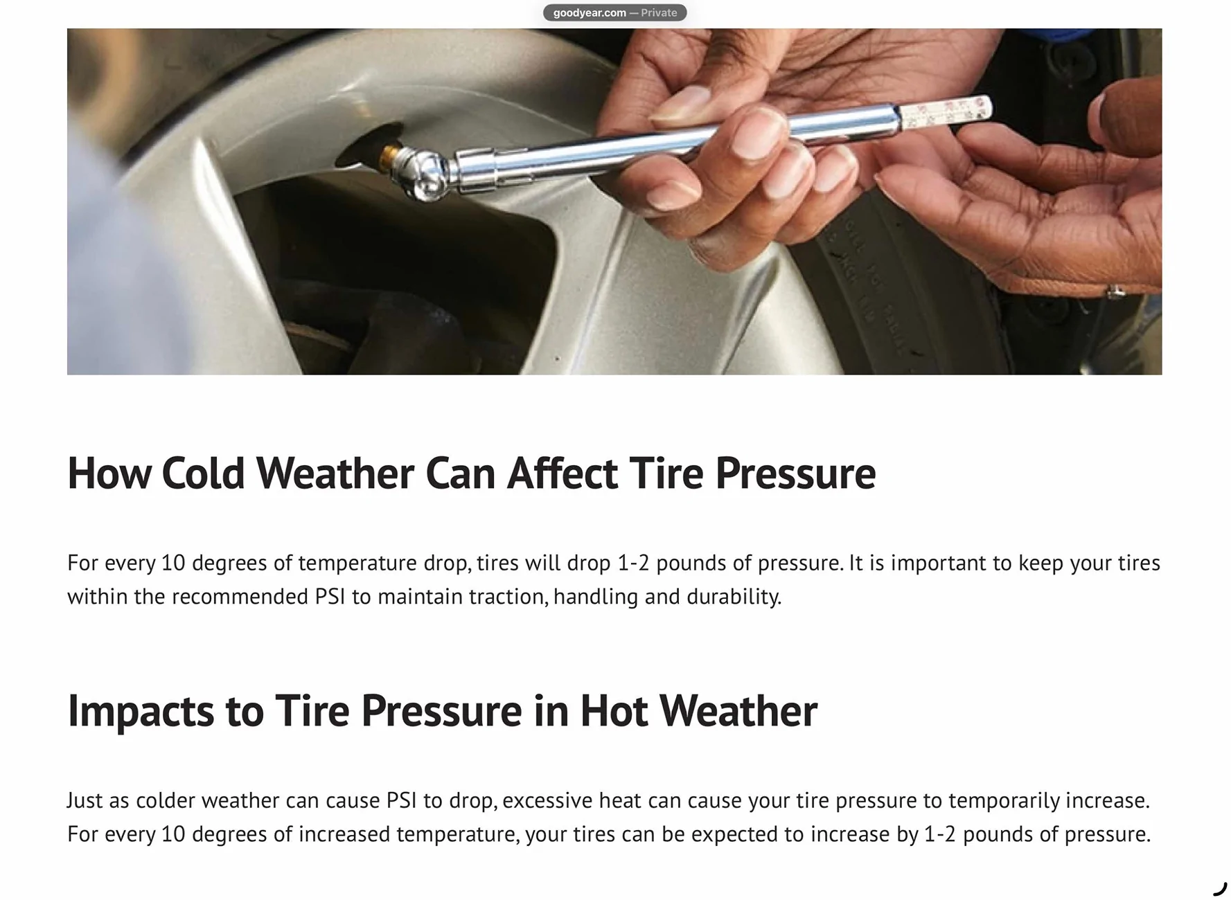

Hello all, since this is the first winter I've not been able to use my garage, I'm wondering what's going on.
The other evening I went out and it was -4 outside. My tire pressure lights came on, and they were at 20. About ten minutes into the trip they were at 30. I have the stock 33 mud tires that came with my Willys.
This evening it's 24 degrees and they're now at 31. The dash is telling me to inflate them to 37.
Is this normal, and should I inflate them to 37 tomorrow? Am I going to damage something riding around like this?
I have a Sport that I keep in Tinmouth, VT. Usually the first really colder fall day activates the low tire warning, and I then just fill the tires to 37 and typically don't have to touch them until the next fall. You shouldn't see more than a few PSI variation between hot and cold tire pressure, not enough to activate the low TPMS.

My target pressure is always the "normal operating" pressure.
If I decide that, say 30 psi is where I determined is where the vehicle handles best, wears best, mpg compromise, (or a chalk test is best), etc., that is the target pressure for "normal operation". If the testing showed me 30 psi is what works best all around, I want that pressure when driving all the time. Not cold.
So, most of the time, that's pretty easy around socal in the summer months. I can put ~27 psi in them "cold" and expect about 30-31 psi on the highway, once warmed up. In the socal winter (🤣), I can see maybe 4-5 psi gain from a cold (ha!) morning to freeway hot, maybe more. So, it's pretty predicable with predicable weather and a predicable trip. I just set the pressures about 4-5 psi lower than the target pressure and I'm usually pretty close.
But, since I'm retired, I often go weeks driving just a couple miles and back on surface streets. During that time, pressures will only rise 1-2 psi on the trip. So, my cold pressure has to be raised when I'm in that routine to get the average "normal operating" pressure reasonably close to my tested target pressure. Otherwise, I'm driving most of the time around town at 25-26 psi and the handling feels squirmy.
