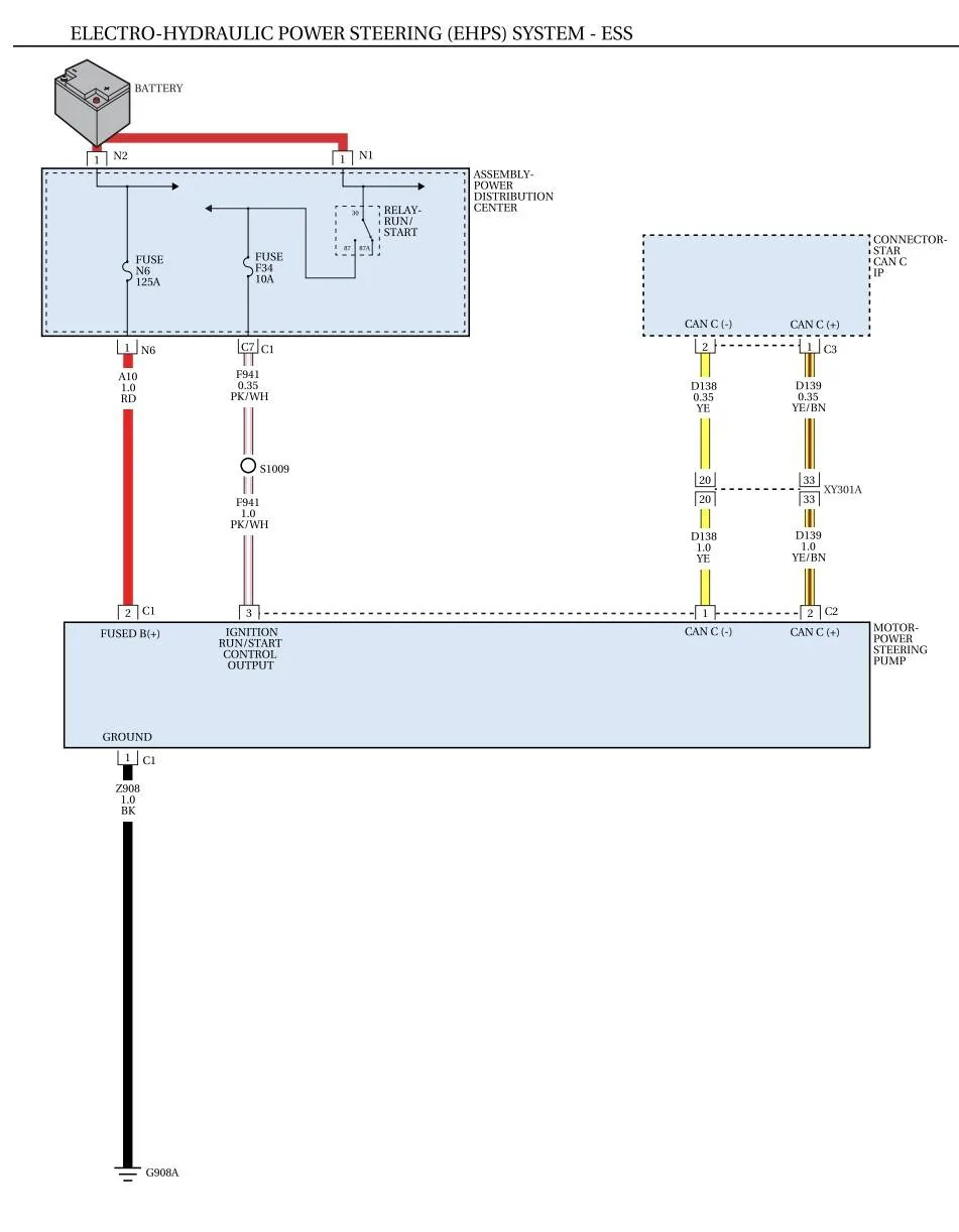

Here's the power steering schematic
Jeep Wrangler JL Lost Power steering Power Steering

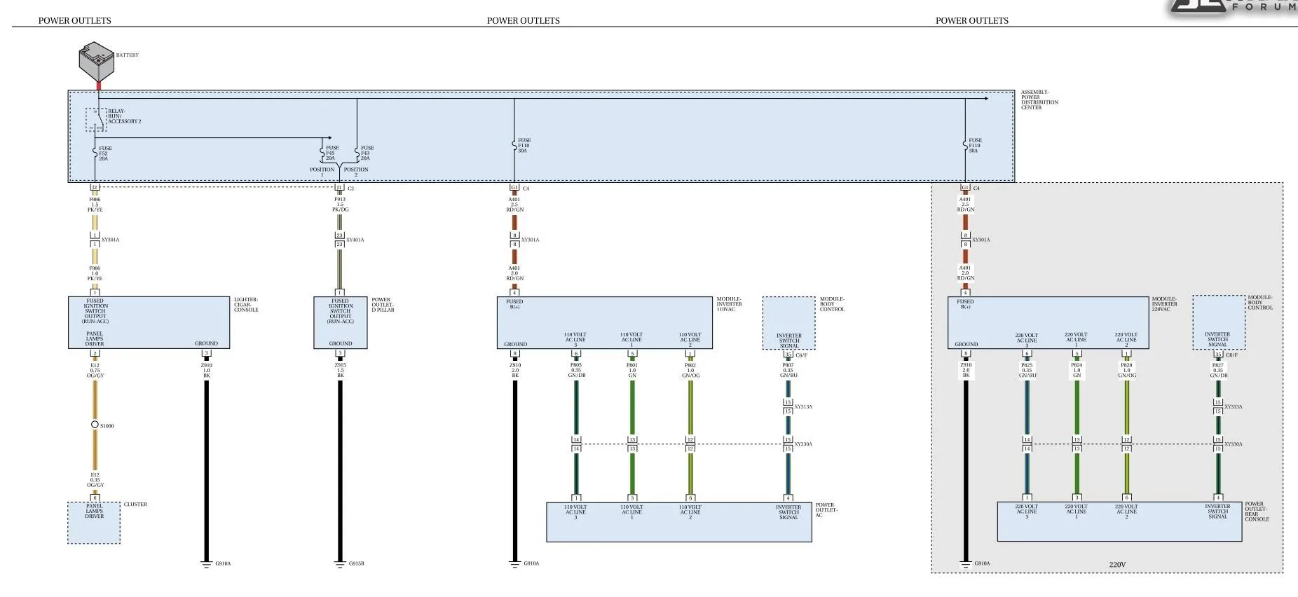

Power outlets.
Jeep Wrangler JL Lost Power steering power outlets

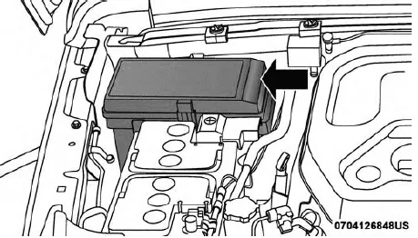

Power Distribution Center (PDC)
compartment near the battery. This center contains cartridge fuses, mini fuses, and relays. The PDC top cover is labelled with each serviceable fuse/relay location, function, and size.
Jeep Wrangler JL Lost Power steering Power%2BDistribution%2BCenter%2B%2528PDC%2529
