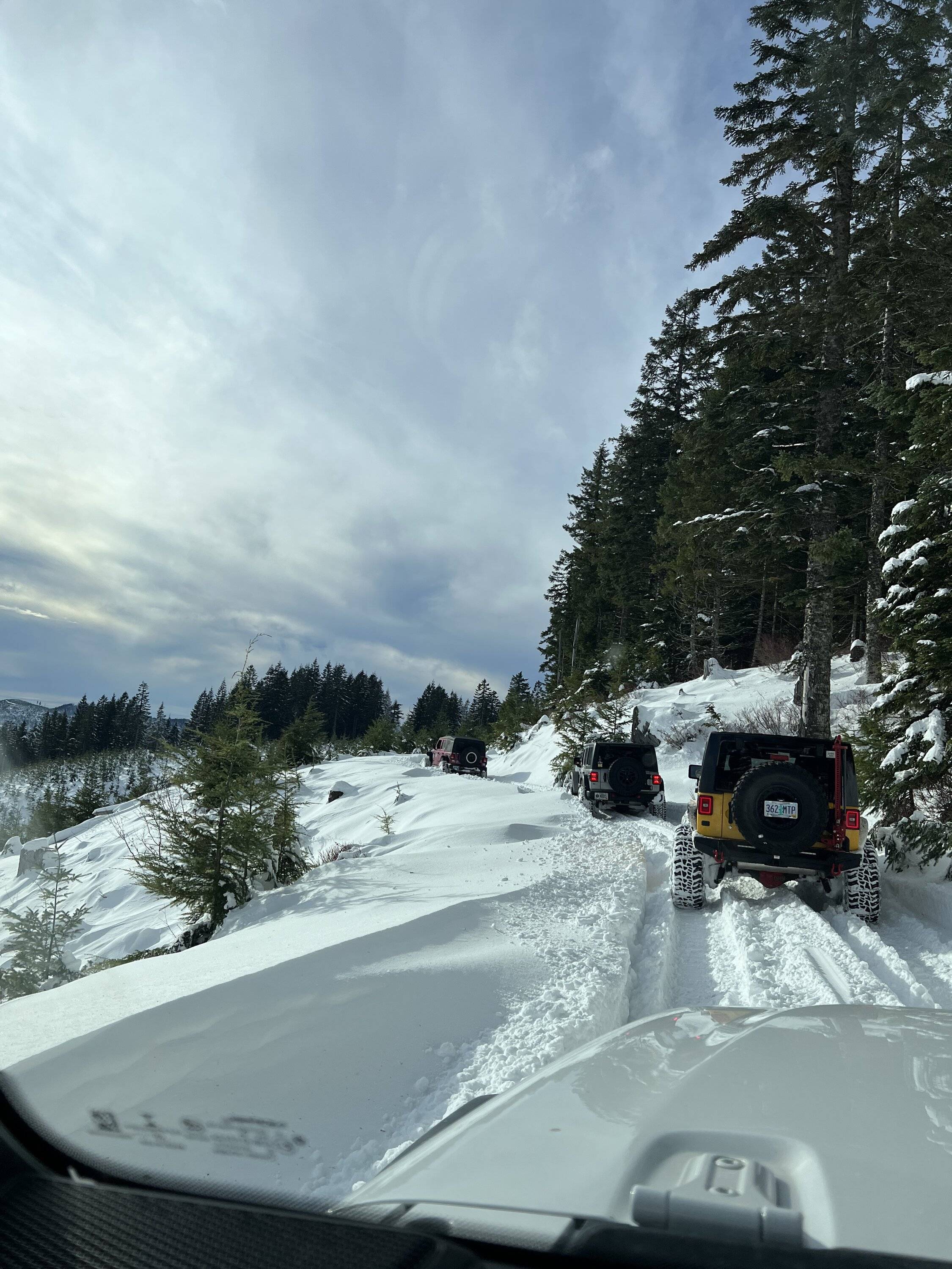

Got a few good photos for my trouble though!
