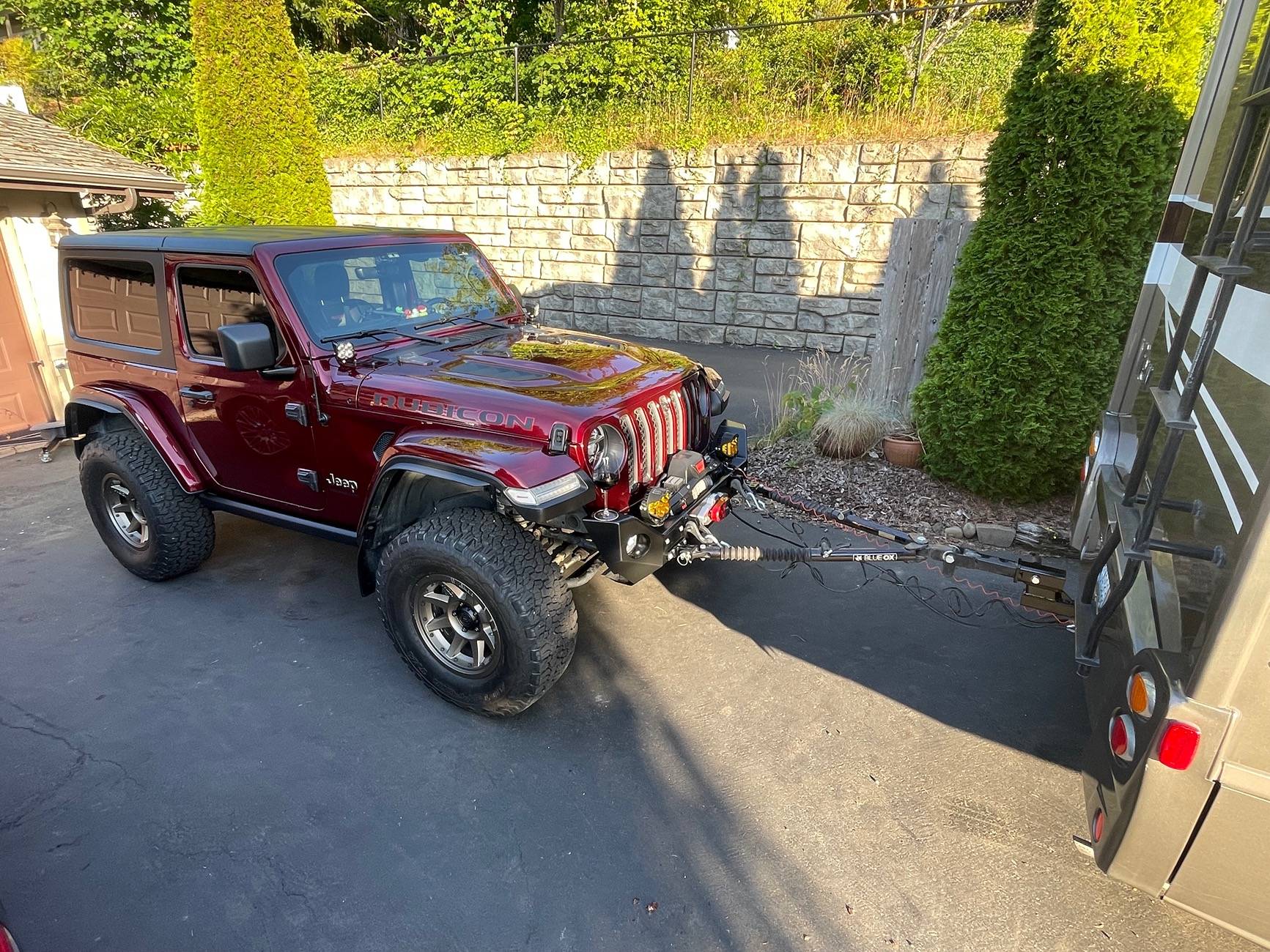

I have a Winnabego View Class C RV that I flat tow my 22 JLR 2dr w/315s. Before I started towing, I installed a Hellwig rear sway bar on the RV. Made a world of difference in the RV handling.
I use a Blue Ox Ascent tow bar that ties directly into the Jeep frame ends via clevis fittings on my RockHard4x4 Patriot bumper.
Also installed an RoadMaster Exact Center steering stabilizer to replace the weak OEM SS. You may want to give RoadMaster a call for recommendations as they are available with different load ratings. They have pretty good customer support in figuring what is best set up.
