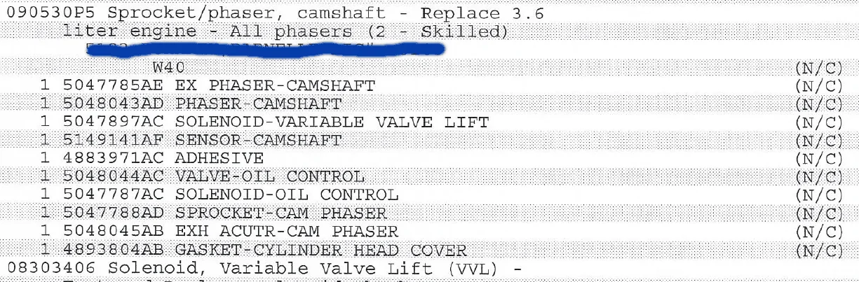

3. During 10 days of working with Jeep Engineering the following was replaced(Ive attached a picture of the parts list)
Solenoid VVL - Test and replace solenoid bank 2 rear, solenoid 2/2
Solenoid VVL - Test and replace solenoid bank 2 front, solenoid 2/1
Solenoid VVL - Test and replace solenoid bank 1 rear, solenoid 1/2
Solenoid VVL - Test and replace solenoid bank 1 front, solenoid 1/1

My question is should I have any long term concerns with this engine after needing these repairs at 3500 miles?

It literally all depends on the quality of work they performed. If they half assed the job, missed bits and pieces, then yea you're gna have a problem down the road.
My engine has had the top end removed twice due to bad rocker arms/cams and the transmission has been removed TWICE for a clutch replacement.... The best thing you can do is go with the flow, considering dumping it if a bunch of issues start to come up further down the road.

Those repairs aren’t all that major, to be honest. Just a defective part or two here and there. If you don’t have Major problems within 1000 miles of their work being done, the most significant problem you are going to find is probably oil leaks.
