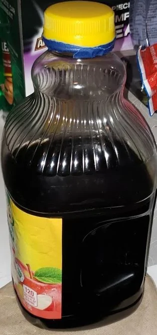

The dealers can deny it, but they can't say i'm making this up. This is how much oil I had to remove.
That's a lot. But honestly, they don't care. They're going to say you're making this up even if you show them the bottle, that's just how they do business. They're obviously not being held accountable by corporate since they all keep doing it. Jeep dealers have lost 100% my trust and business.
There's been stories from Jeep owners here going to the dealers with proof and they still deny it... or reluctantly doing the oil change again, and doing it wrong.... again....
I had to explain to 3 dealers how the front seat "easy entry" system on the 2 door works... they had 0 clue, all of them, they have minimal idea how these vehicles are built. They probably don't even know the difference between a JK and a JL and that's why they are putting 6 qts on them, and the worst part? it is almost 2020 and they are all still doing it. Corporate is doing absolutely nothing about it. 0.
