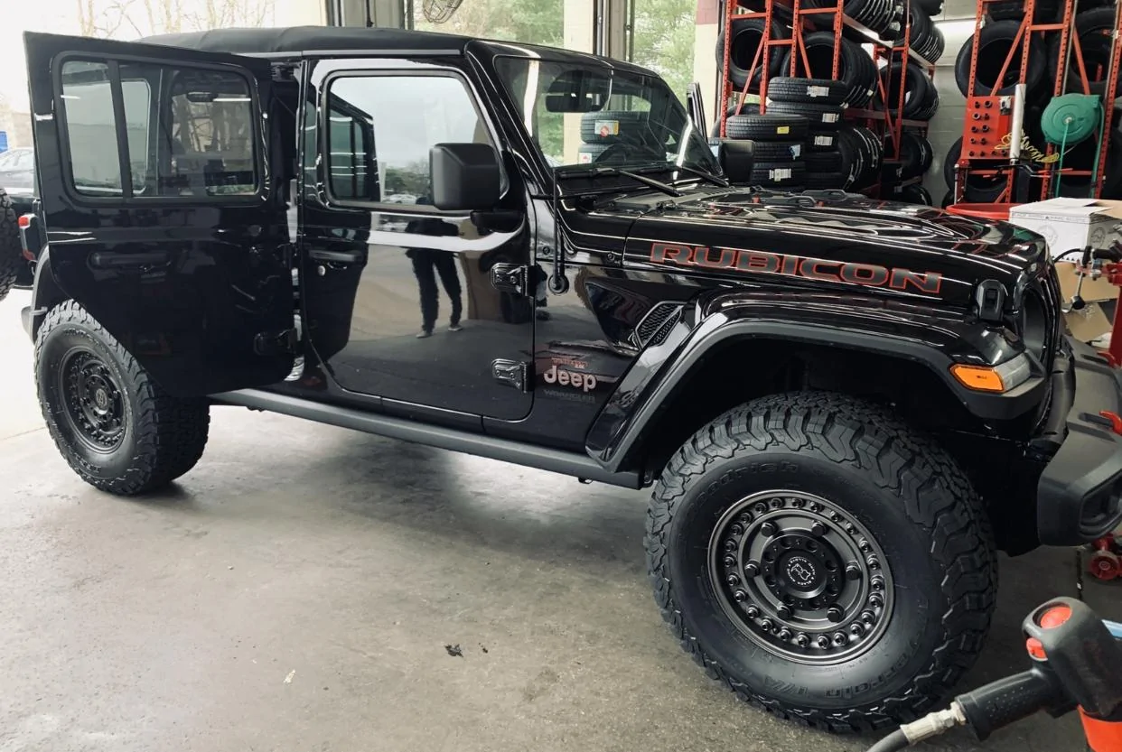

Update - got the wheels and tires. The ride is slightly firmer...not at all bad. Very happy.
Jeep Wrangler JL Load range e2? Ko2 - any advice would be appreciated! 308E0CAC-5601-454C-AF46-DB1E6AE28B12
