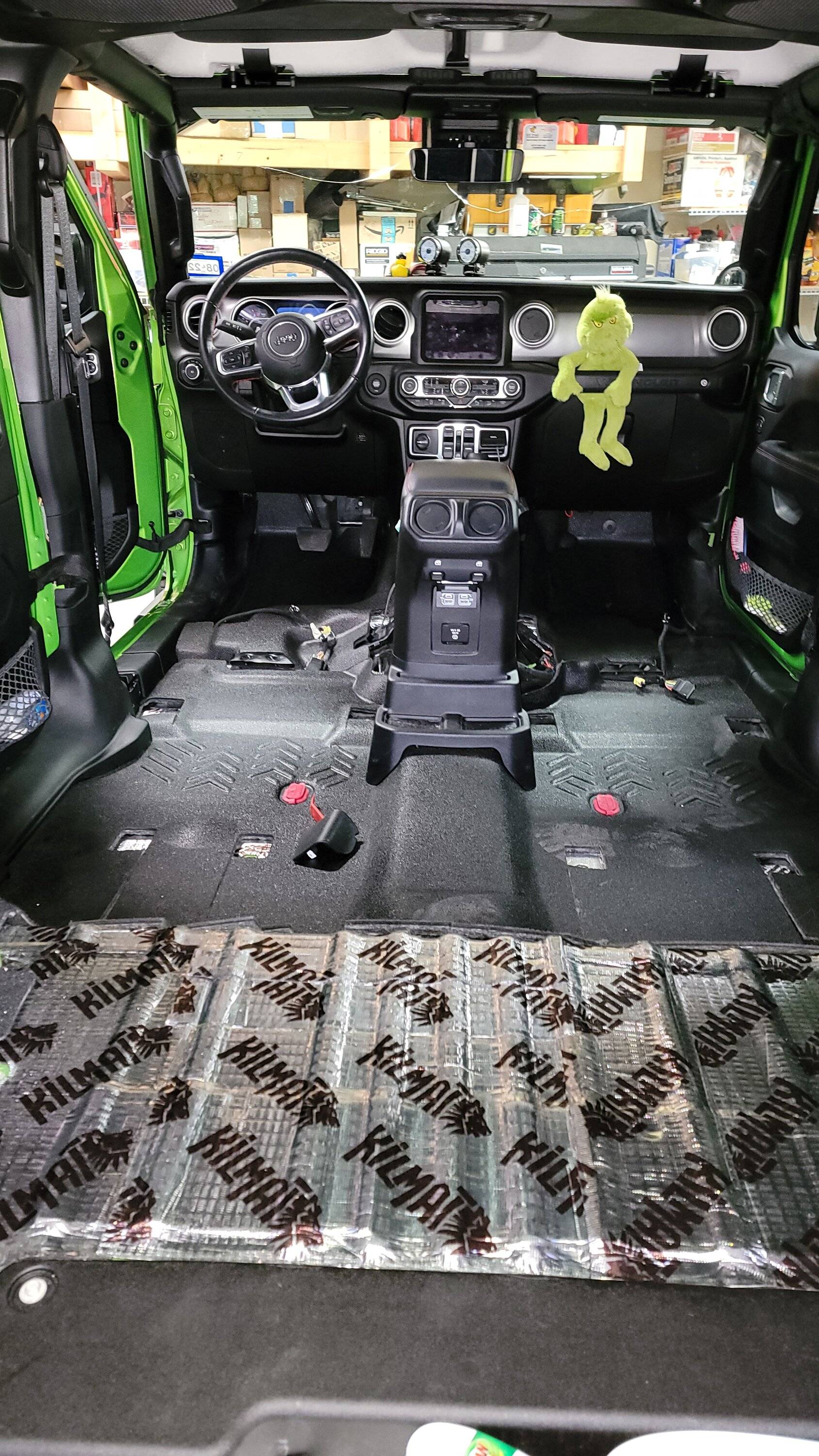

@M_Pluto - you can see what is under the carpet in these photos of my Kilmat installation. I would think that only spraying in bedliner (unless 3/16"-5/16" thick) is going to exponentially increase the heat and road noise.
Jeep Wrangler JL Living without Carpets 20220228_114122
Jeep Wrangler JL Living without Carpets 20220228_175451

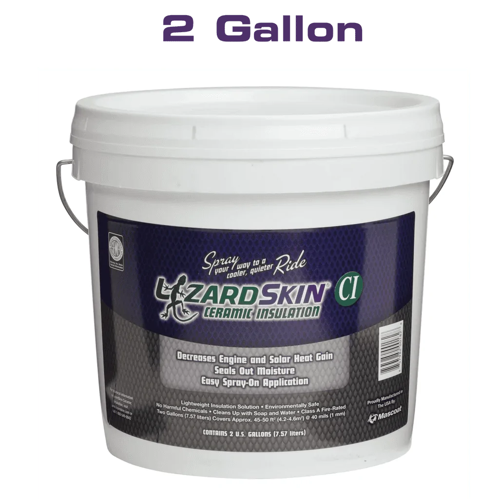

I plan on using this product to manage the heat:
Jeep Wrangler JL Living without Carpets 1673637040578

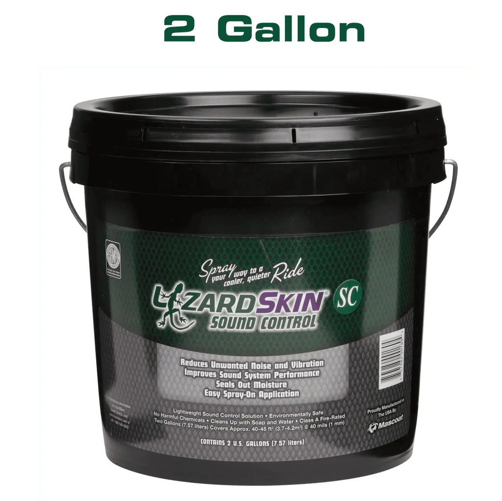

And this product for the sound:
Jeep Wrangler JL Living without Carpets 1673637076968
They are more purpose made to being used for controlling sound & heat than and less at protection like a traditional bed liner is.

I agree that the product you DON'T WANT, the same product that has been mentioned in almost every response, isn't for everyone.
I think your biggest issue will be the seat wiring and heat/air ductwork running under the seat. You'll have to remove all that stuff to properly get the floor sprayed.
If I make any changes to mine, that will be the route I take.
Honestly, the biggest thing for me will be cost of labour, as this requires a lot of OCD and a little less ADHD for the teardown (keeping track of parts, bolts, nuts, etc). Even more so especially for the taping & prep work. For the install it's a 2 day minimum job, as the first product needs a full 24 hours of curing before you can move onto the second one. I've watched a few full tear down videos of jeeps to have an idea of just how much work is involved with it. I'll probably try to do as much of the tear down as I can to cut down on labour costs, but it is still gonna be pricy.

You may also want to make sure that lizard skin doesn't contain the same cancerous off-gassing that nearly all bedliner products do. In the bed of a truck it's no problem; in a naked jeep, probably the same - but even then I wouldn't risk it, alongside the other issues of a less-than-seamless joining between the floor and the plastic trim, abrasiveness, noise and heat.

The buckets both say: No harmful chemicals and environmentally safe. I'd say the direct sunshine of an open Jeep poses a bigger threat. But sunshine is pretty good for ya too.

I feel like I've said this a couple times, but Lizard Skin isn't a bed liner technically speaking (they say this on their website, it is not a bed liner), it is meant for internal/inside applications. From what I've heard & from a vague recollection of a conversation with one of their people on the phone, off gassing isn't really a problem/consideration.
