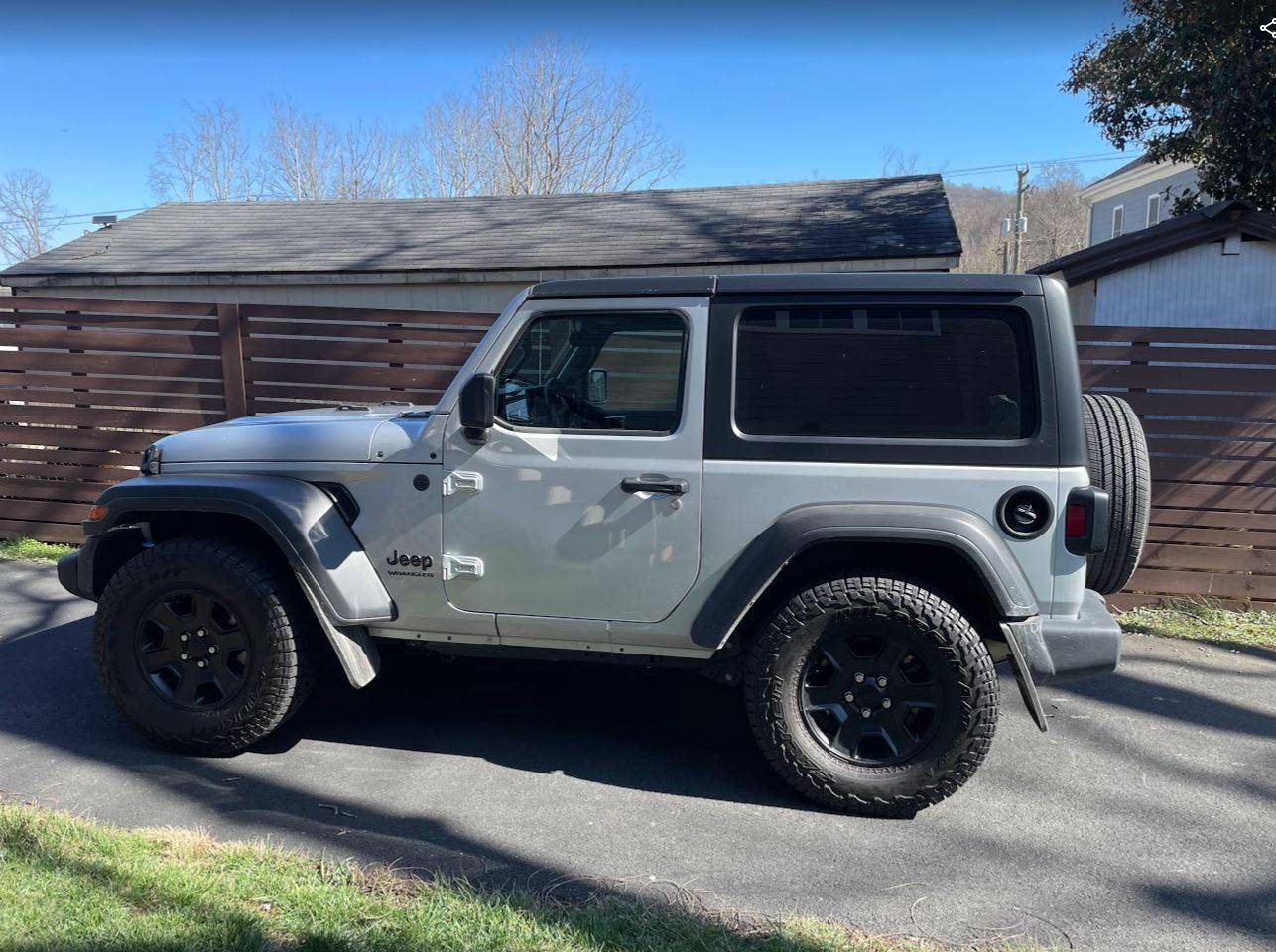

Also for what it's worth; those Gladiator 33's fit great with no lift. Pic of that:
