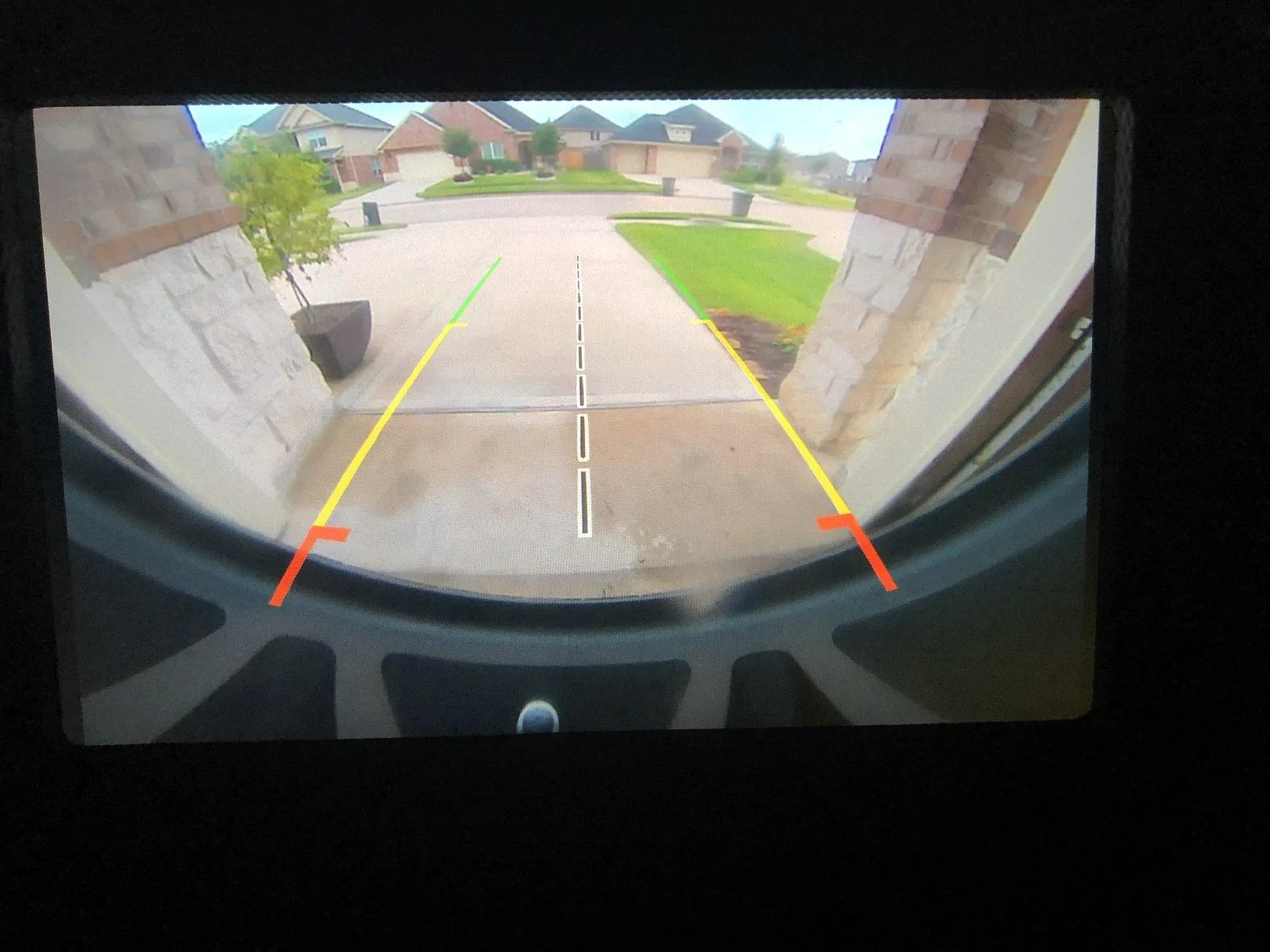

What you are seeing is the tire, here is my 315 mounted on a 17” wheel with a -12 offset

same view as mine......works good enough for me.

There must be a answer for both the camera view and the parking sensors????
My guess is it’s possible the camera can be relocated to give you a better view but as far as the parking sensors go I’m thinking not and the further the tire sticks out the more it can interfere with those sensors
You could possibly get a better view if you went to a wheel with not such an aggressive offset, my wheels have a -12 which pushes the wheel out a fair amount but if you went to say a -6 or 0 offset it would bring the wheel in closer
