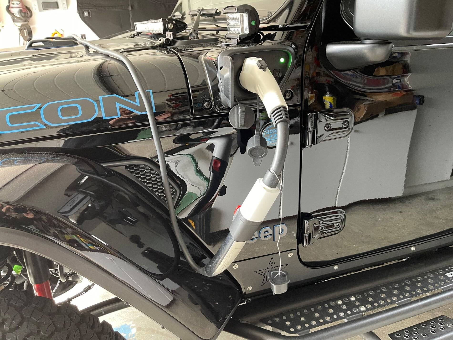

I bought the Lectron Tesla adapter on amazon, they have one on warehouse deals for $119
Are you having issues with it? Everyone else seems to say that none of the adapters work and in some cases cause a CEL issue.
Been Flawless for me plugged in right now and working fine.

I bought one, and it's hit and miss. Often, when I plug in to the 4xe, I quickly get a red charge fault light on the 4xe. If I then depower and repower the Tesla charger, it then works fine. My charger is from a 2015 Tesla Model S. I'd love to learn how to avoid this issue, but there it is.
I have the Electron Tesla Adapter and my Charge cord is from my 2015 Tesla and works 100% of the time. I am using the cord that plugs into a 14-50 wall outlet not the Tesla on wall charger...

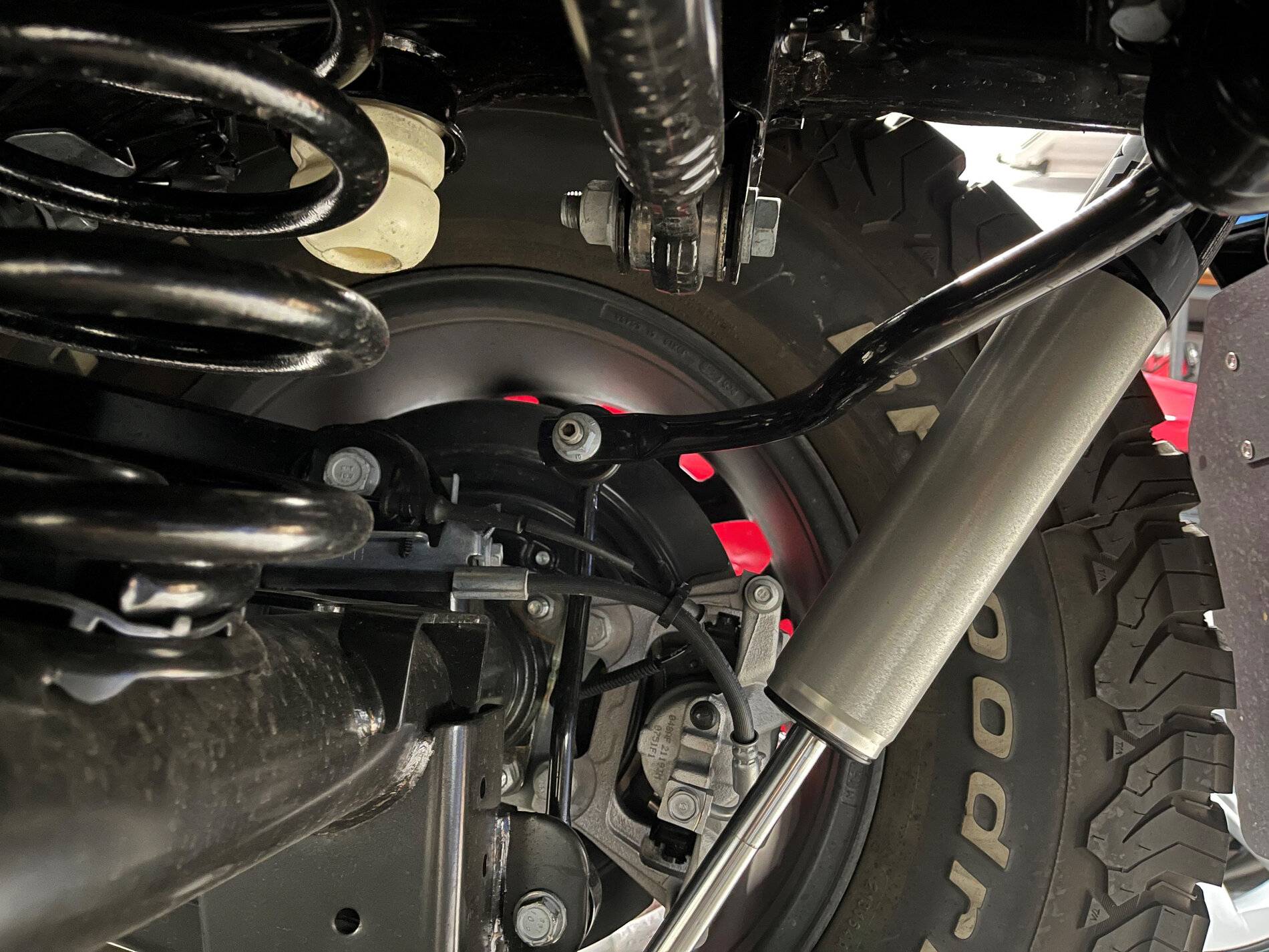

Before you changed shocks, Did you have any issues with the ST1 kit? it doesnt have any shock extensions, Correct? I really want to do an ST1 on my Rubicon, but continue to have some concerns. I'd like to keep my factory shocks if possible and just add the ST1. Are the Fox shocks any longer than stock? Thanks
Let me add, with the 1.5" teraflex and stock shocks I had some minor body roll, when I installed the Fox 2.0 that eliminated that roll as the Fox a 3000PSI compared to about 2000psi of the stock shocks. Also notice in the picture the sway bar is supposed to be 10-15 degrees angle and it is at 27-degrees at near full flex it comes in contact with the shock hence the need for longer 11" sway bar links (stock are 9" rear)
