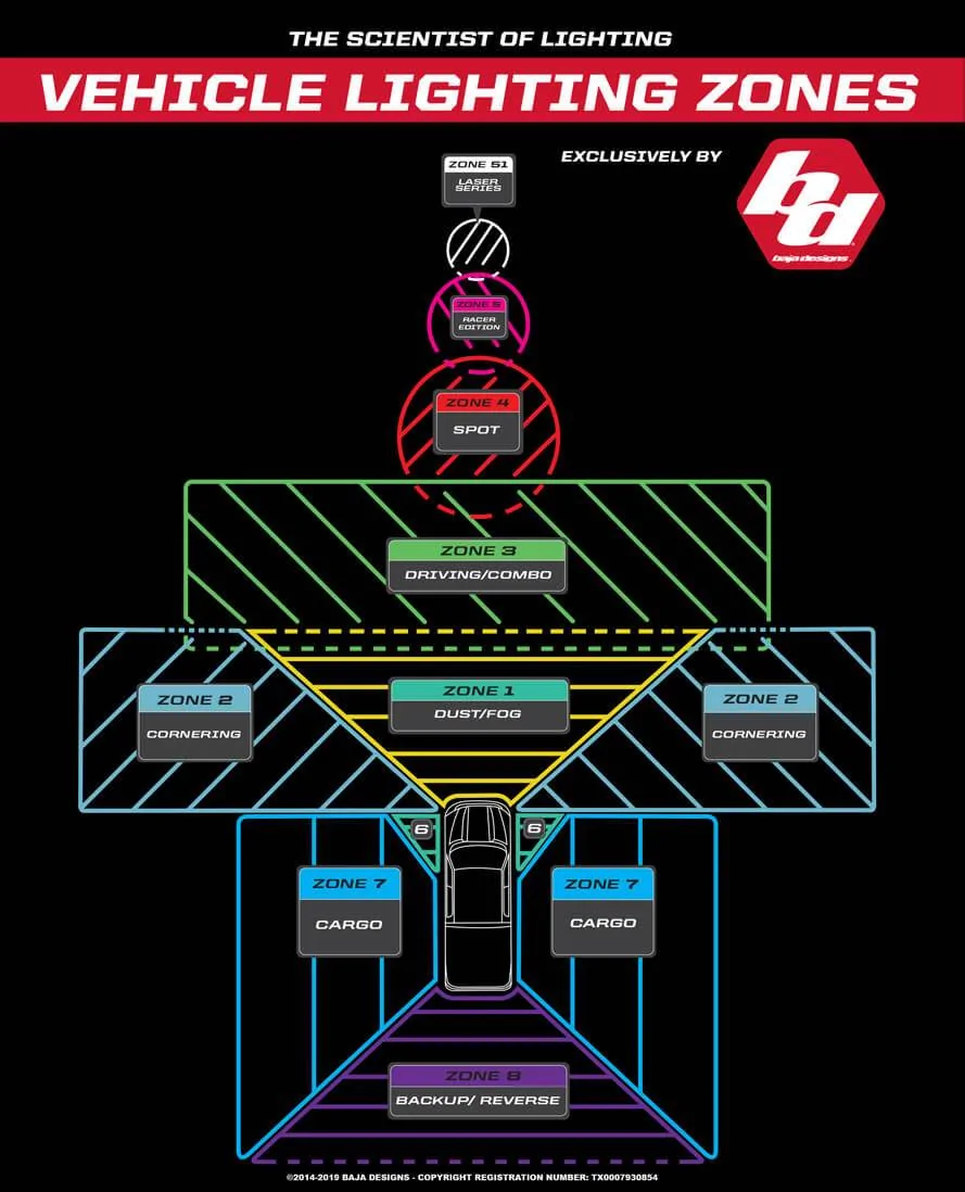

For an easy guide I posted a lighting zone chart below, this can give you an idea of how certain lights will be better used in different areas. The lighting zone chart helps you establish your needs and or wants. They help you mix and match the right lights and lenses.
Lighting Zone Video Walk-through LINK

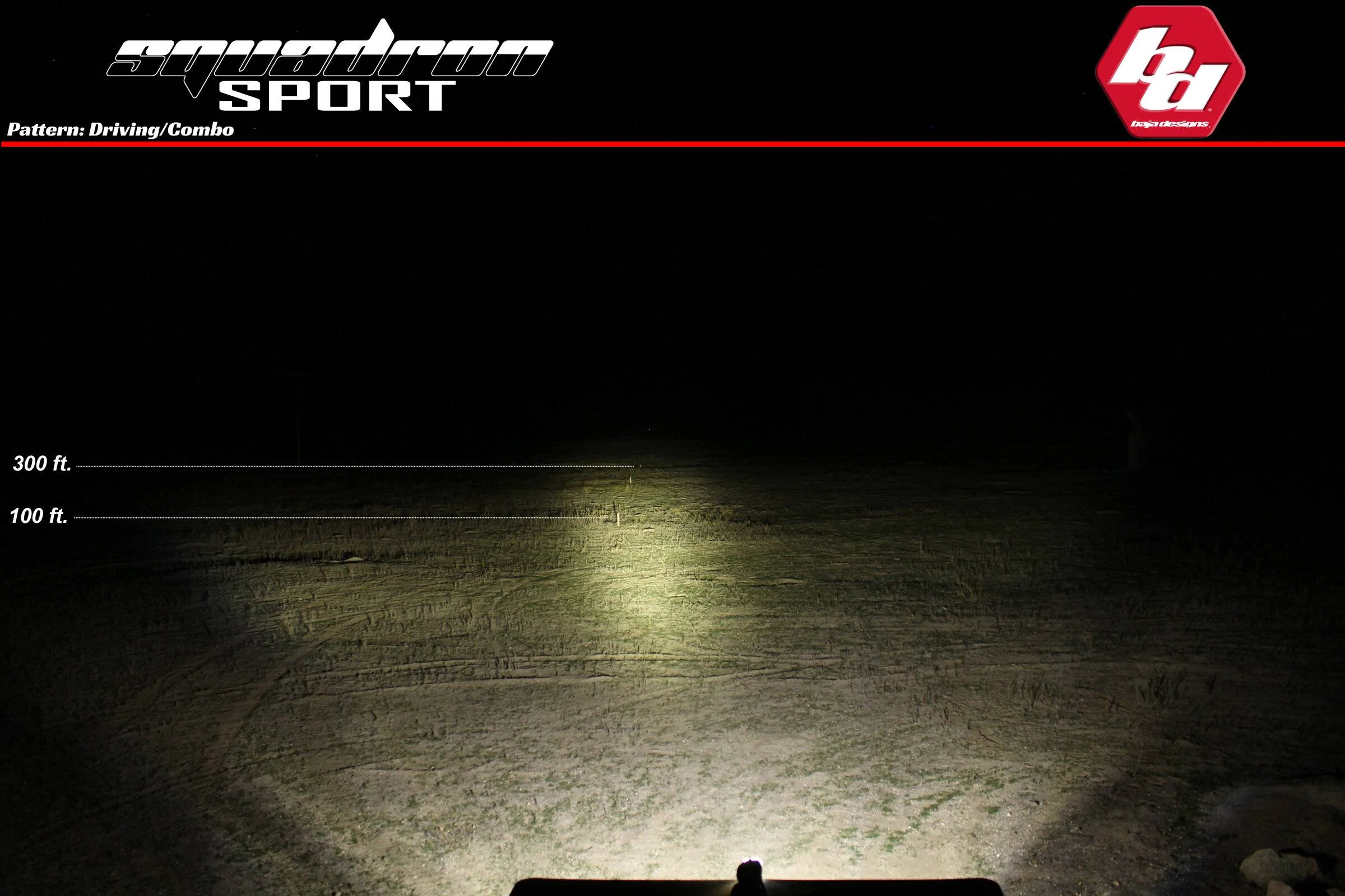

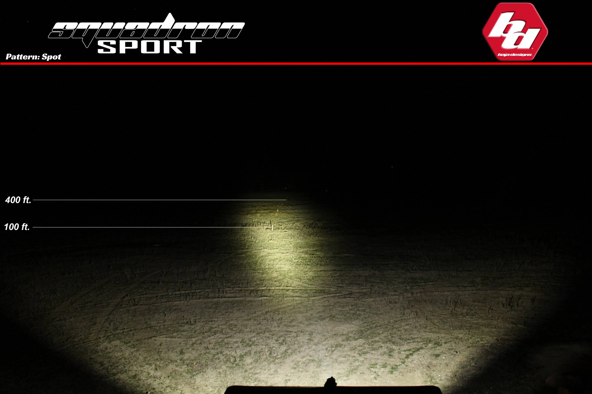

After you decide on the light you want; the next major question is what lenses do you want. There are a few lens options that will manipulate the light to how you want it. This is important because to much light in one location will cause hot spots or glare. A hot spot is the abundance of light in a single location, this effect your ability to locate hazards as well as cause eye fatigue and strain. For reference on lenses I included this link. Also I added two photos of the same light with different lenses, check out the difference on how the light is projected. A combo lens projects light slightly wider however it does not go as far, the spot lens is the opposite slightly farther but not as wide.
Lenses Link
As you can see there are a number of possibilities and it comes down to what suits your needs.
Best,
Brock Brunkhorst
Driving/Combo Lens
Jeep Wrangler JL Lighting recommendations? Night Shots - Squadron Sport Combo
Spot Lens
Jeep Wrangler JL Lighting recommendations? Night Shots - Squadron Sport Spot
Jeep Wrangler JL Lighting recommendations? light zon
