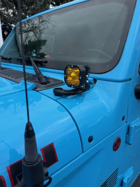

I've got a pair of pod lights on mounts at the cowl/pillar, and a small light bar in the gap of the hoop over my winch on the front bumper. I've just got them switched by an AUX switch, not tied to headlights. Mine are Auxbeam off the Amazon, with a 'combo' lens. One pair throws an impressive beam to front and sides. For driving through the hills mountains and open spaces in Oregon, they are amazing. I don't feel a need to slow down unless I see that animals are out close to the road, since I see them from a safe distance. The only way I see a deer making it in front of me with those lights on is if it was a deliberate kamikaze attack. If the pods were mounted on the bumper I would lose a little range (probably not noticeable), still more than enough though.
