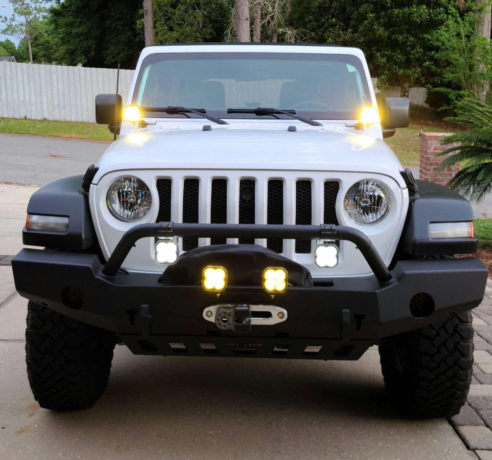

Ambers work better when mounted lower. And best when they have a spot lense or a distinct cutoff line. Ambers are great for cutting through fog, dust, rain, and snow to illuminate objects in the distance. But if the light floods too far upward into your immediate sight line, it will still glare out your view of what's ahead. Not as bad as white light, but still enough to sorta defeat the point of having ambers to cut through.
I found this out during a couple of decent snow storms last winter. I have white lighting on my a-pillars and ambers on my front bumper. The ambers were only available with spot/flood combo lenses, and I was getting more glare back than I previously expected. As soon as the company releases spot lenses for the ambers, I plan on switching over the center pair. I'll leave the combos on the outer pair, as I have them wired to 2 separate switches.

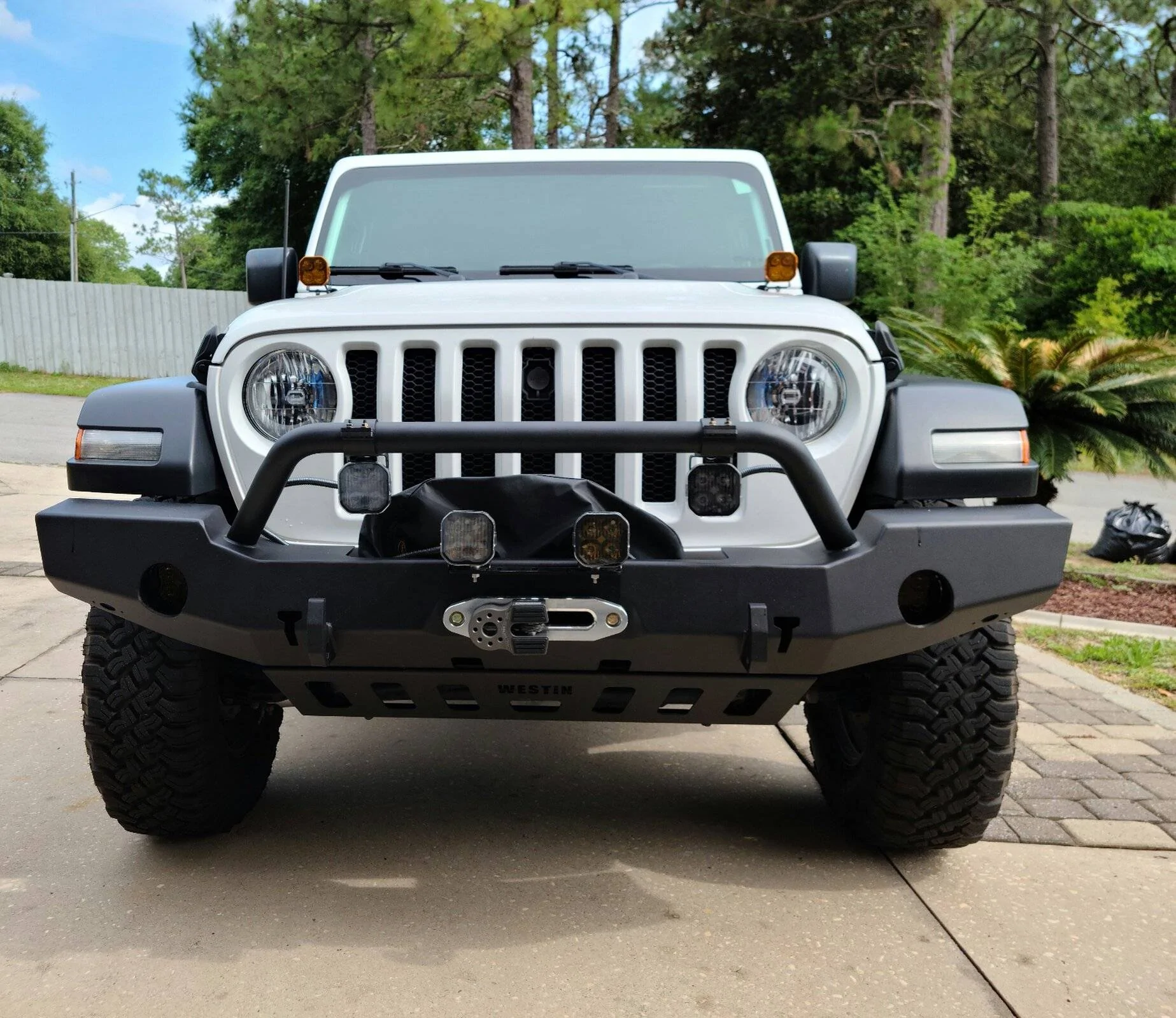

I just installed Diode Dynamic SS3 driving pattern lights. One set is yellow and one set is white. Currently I have both yellow lights mounted low atop the bumper and slightly spaced out from the center of the bumper and the white lights mounted hanging from my bull bar spread as wide as they can go. Both sets of lights are intended to be used for highway and back country road driving. Florida allows for auxiliary driving lights at a min and max height. Nothing about color other than no red of blue and can not shine into vehicles and blind drivers, etc. Figured I could use the white lights in light rain and those times where headlights are not quite needed yet. The yellow would be used for heavy rain and fog. No snow but definitely gets foggy at times when I get off of work in the morning. What setups are people running?
Finally got the lights the way I wanted them. Initially the lights hanging from the bullbar had the wires coming from halfway up the bullbar. I didnt like that so I routed them up higher and had the wires come down behind the lights. Unfortunately I had to use zip ties. Open to suggestions for replacing the zip ties that mount the wire looms to the bullbar.
