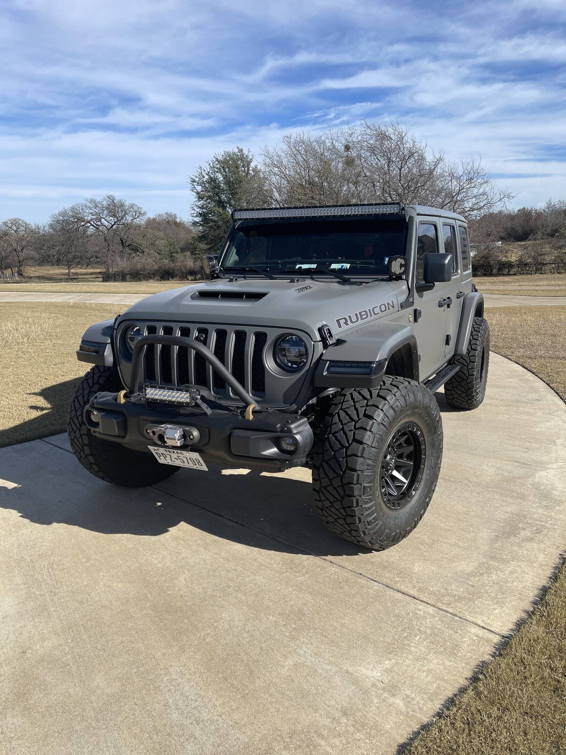

I copied Mcgunny. Bought an angle grinder and cut the Westin bracket a little bit at a time until it fit. My cut is not as Mcgunny’s but I will take it for my first try at using an angle grinder.

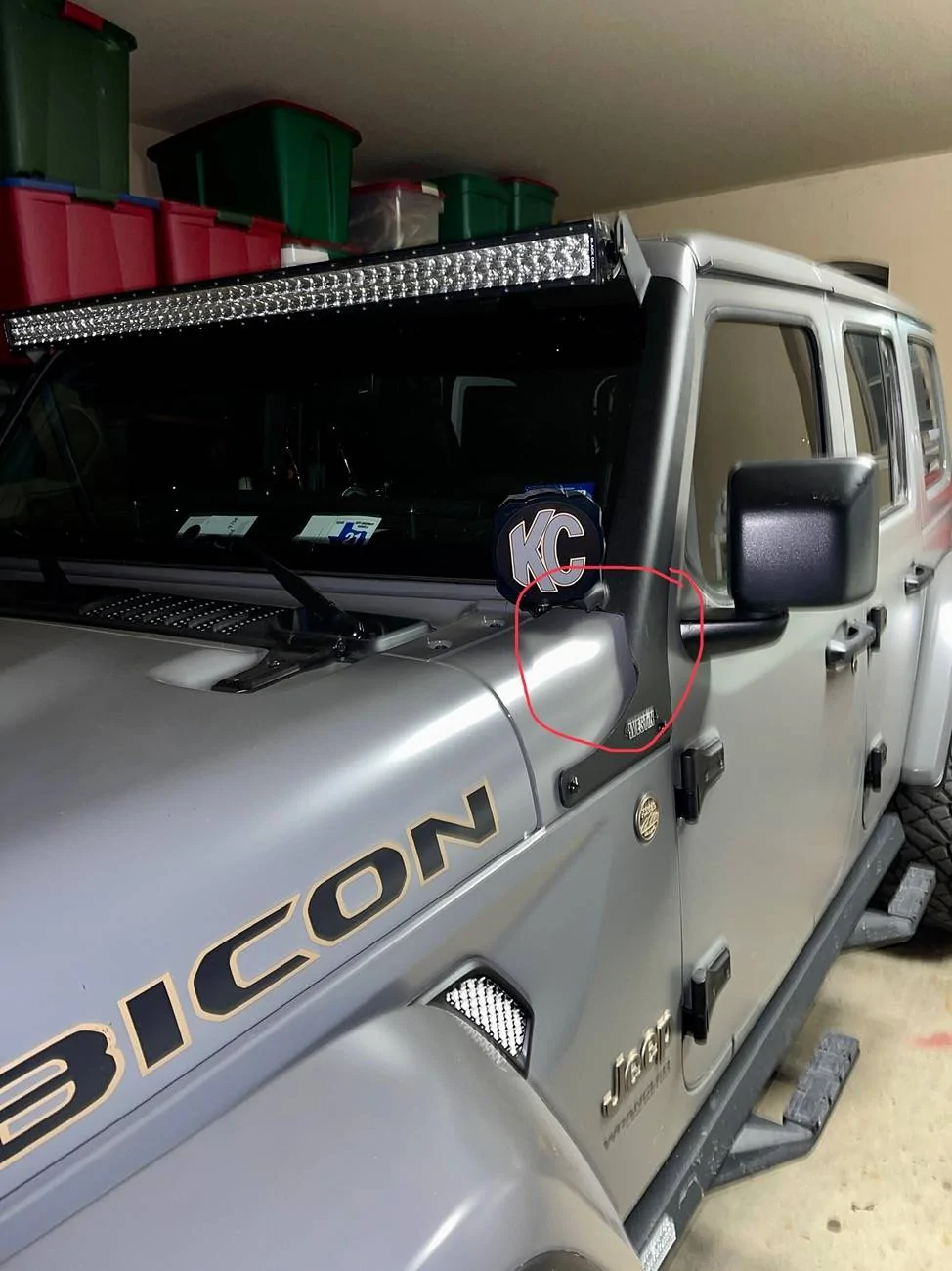

mattcarvette
Apr 17, 2021
Los Angeles
Rubicon 392
I modified the Westin Light Bar Mount to fit my 392. Didn't require bending or welding, just some removal of metal. I had to grind about half an inch off the front of the mount between the fender and windshield mounting points. It fits fine and with the KC Hi-Lites Pro6 Gravity LED light bar it works great. Keep in mind that if you order the light bar from KC Hi-Lites, the mount bars won't work, although KC tells me that they are working on a version of their mounting bars that will work with the 392 and the Mojave, I just couldn't wait that long :). So now here is one of the very few 392's with a light bar.
I know this post is a few years old, but I just barely got my 392. Can you post some pics of what you actually had to modify? Thanks
