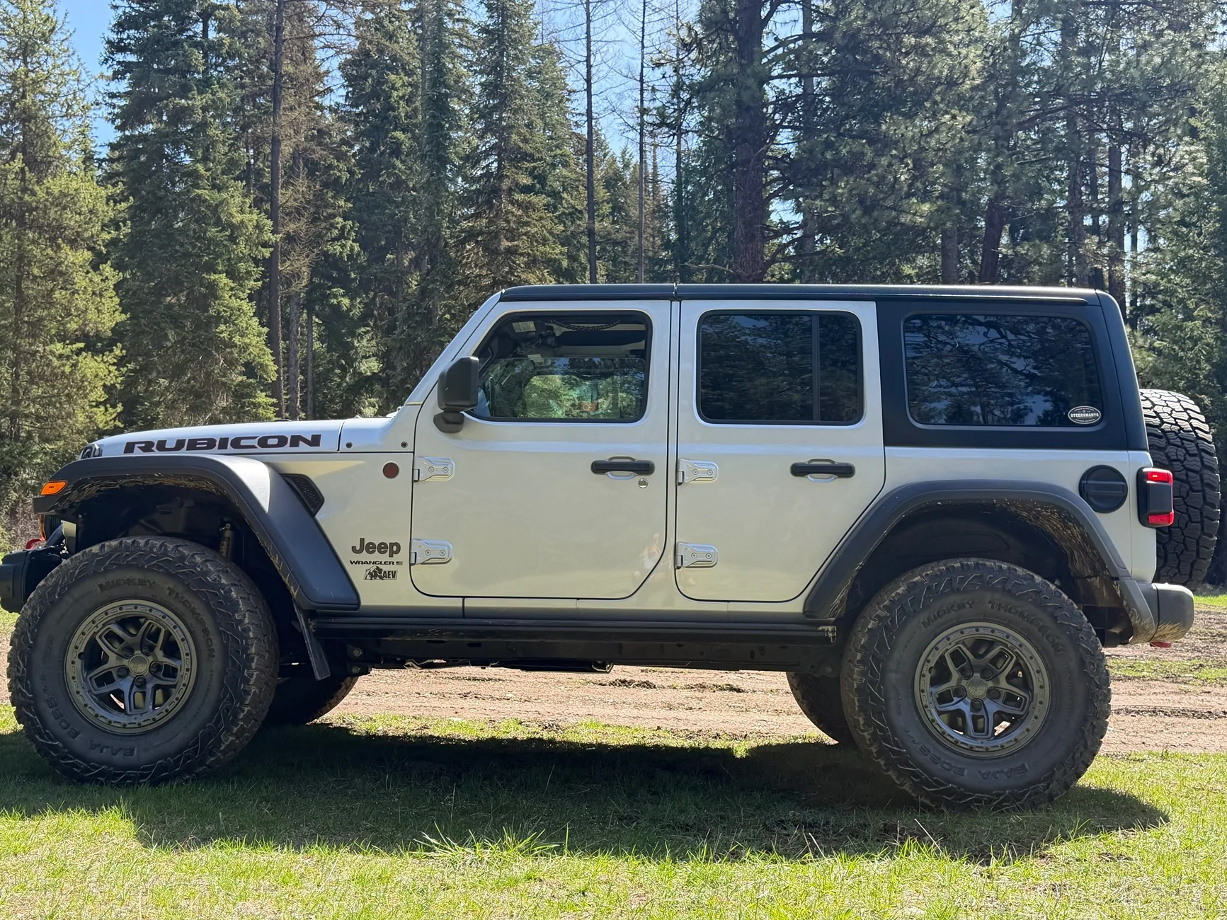

the bottom two pictures in the link below are my Rubicon with a 2.5” TeraFlex and 37” tires. The only reason I would do a 3.5” lift is if you think you will ever run 38s or 39s in the future. Otherwise keep the center of gravity as low as possible and minimize the impact of your caster and pinion angles.

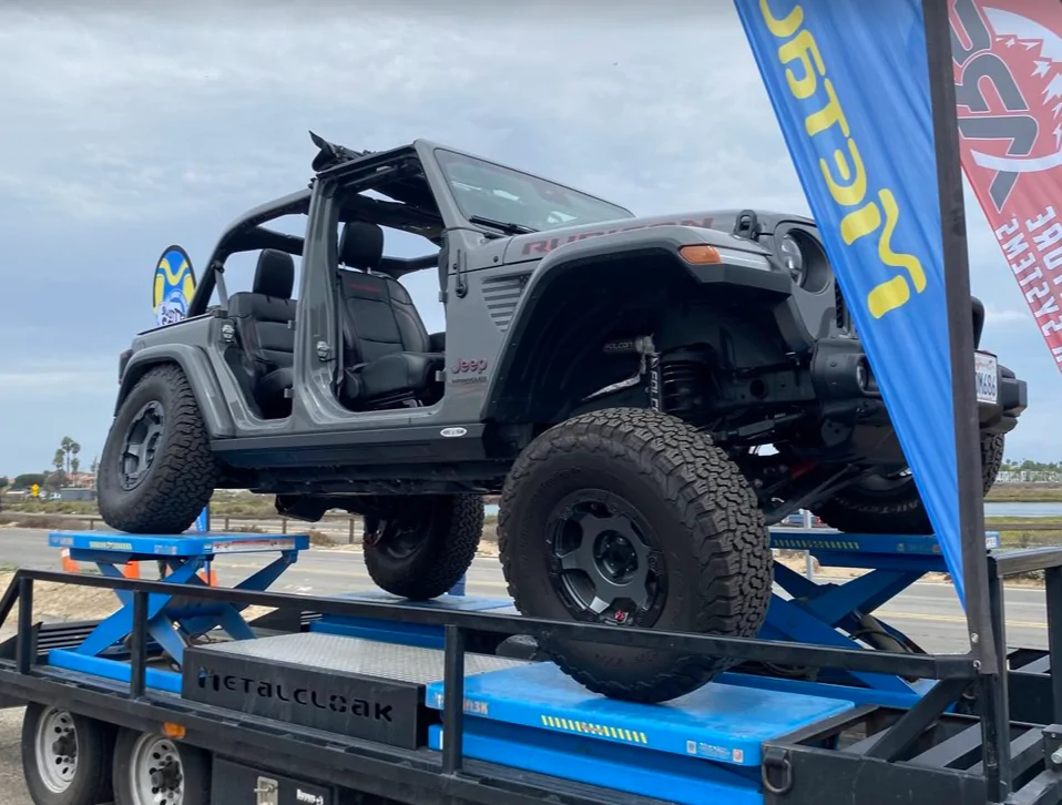

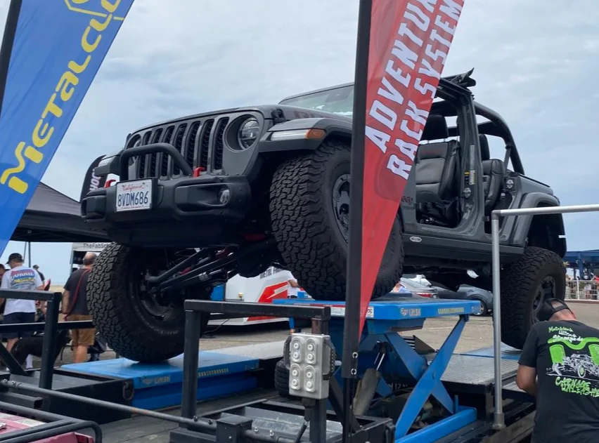

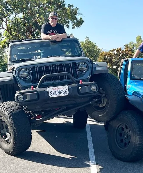

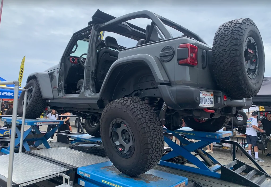

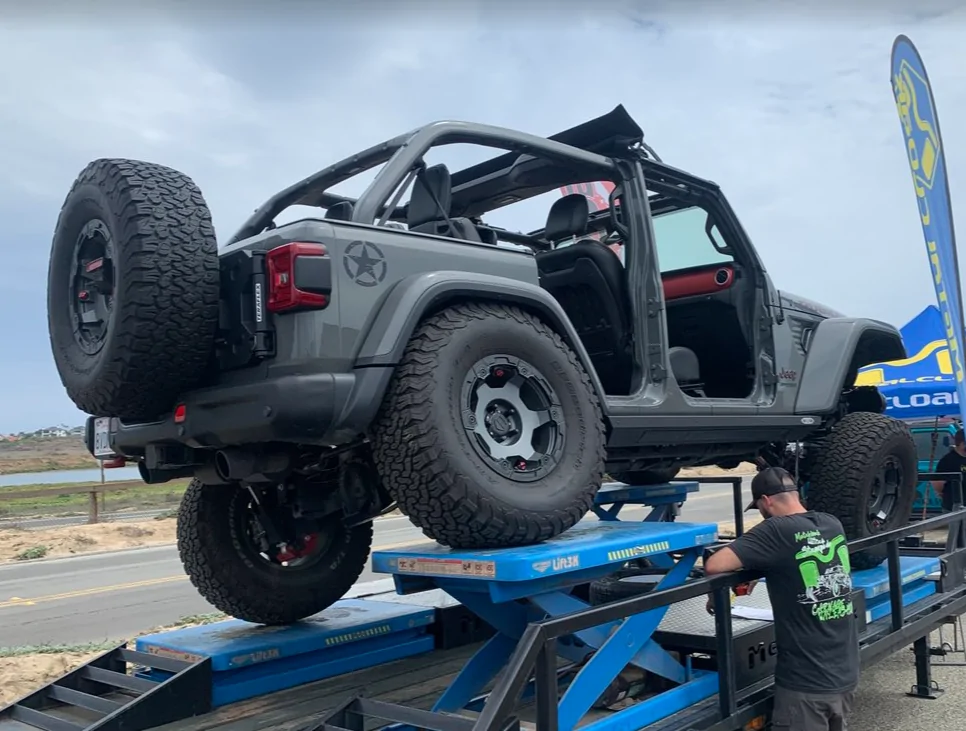

No rubbing at full flex. 2.5" TeraFlex lift with 37x12.5x17 BFG KO2 tires, and Teraflex Nomad wheels (4.75" back space, 8.5" wide). "Good" flex for a modified Jeep is between 700 and 800 on the CTI scale. I am in the middle at 750 with this setup.
