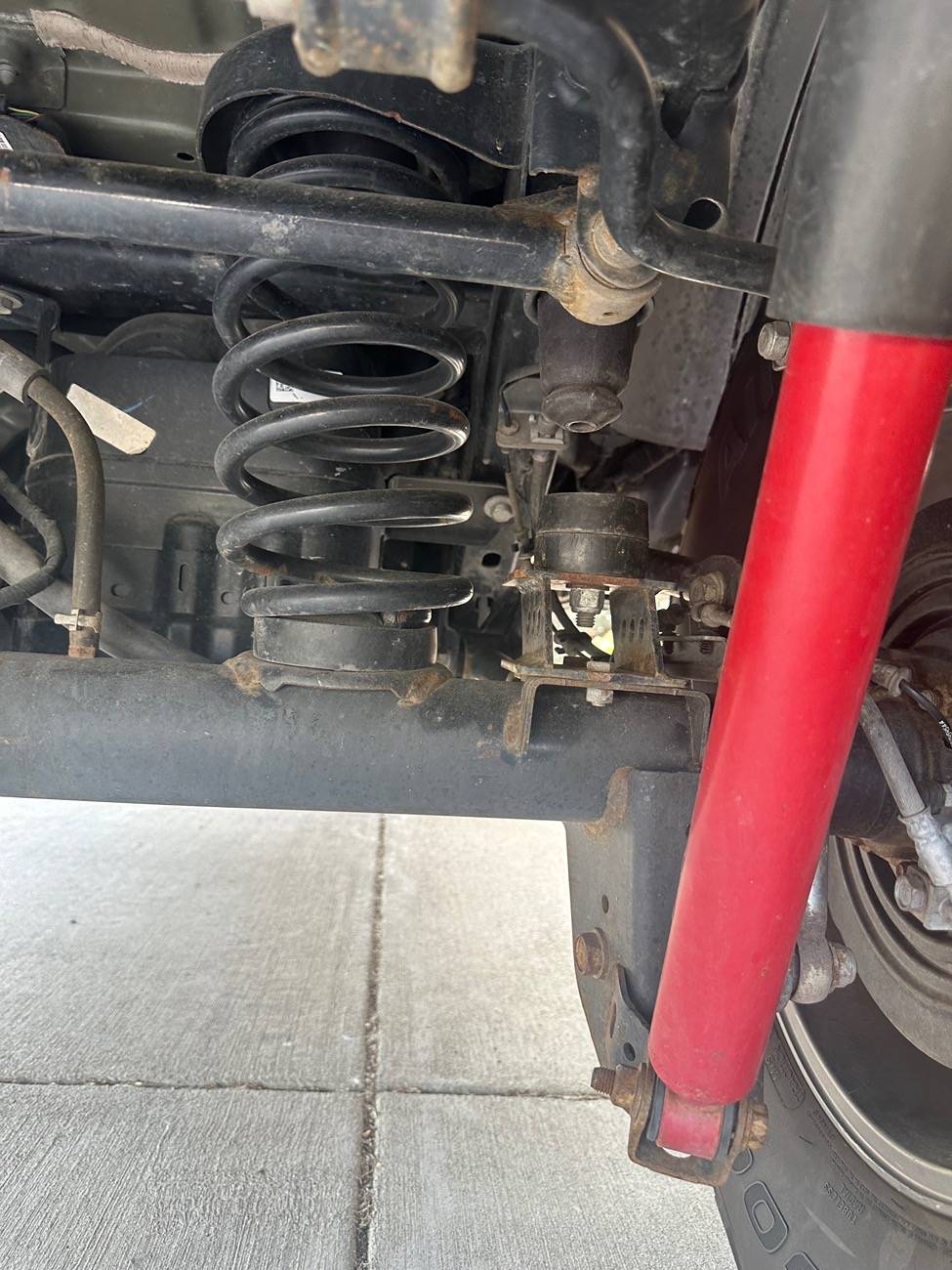

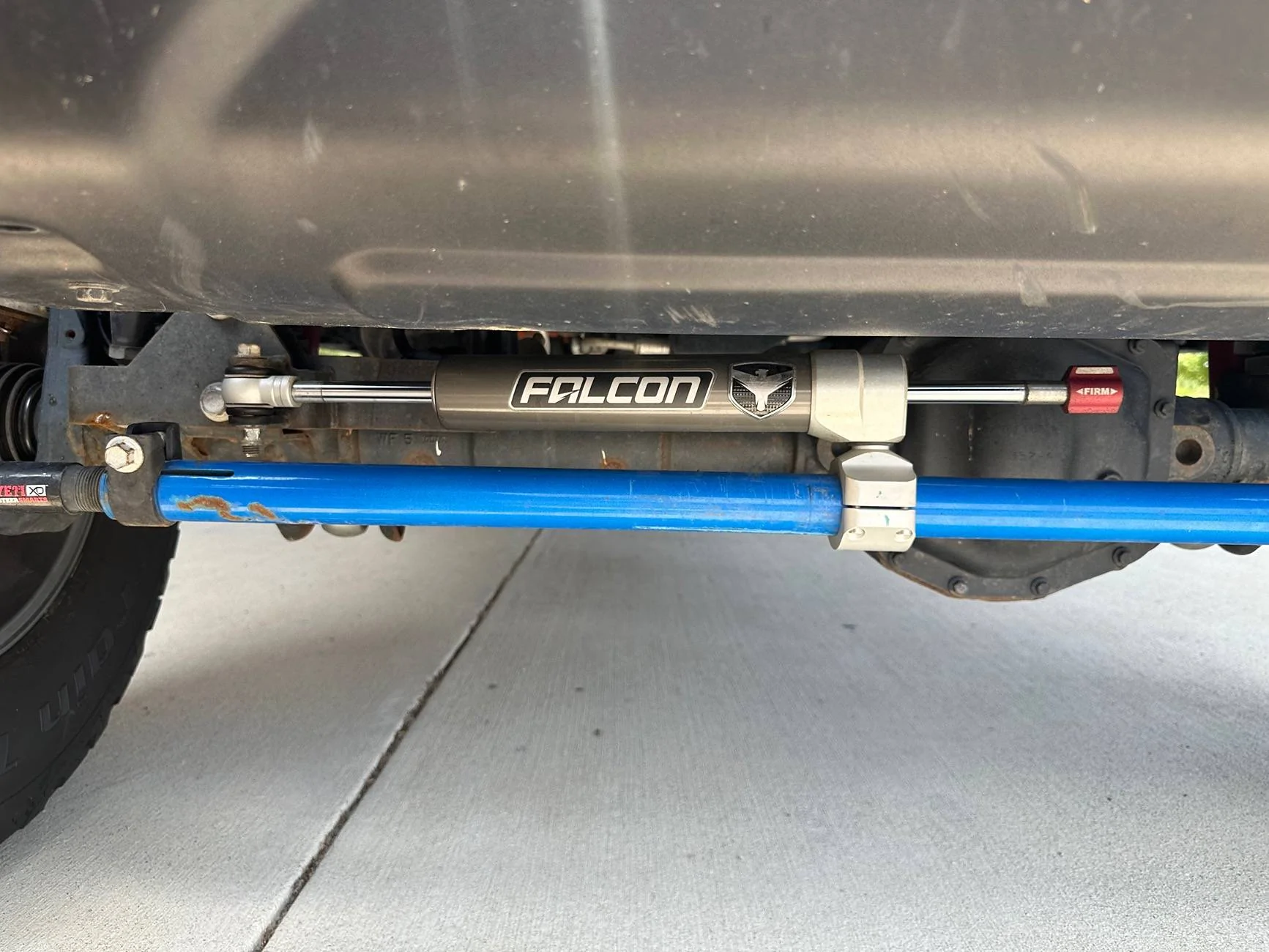

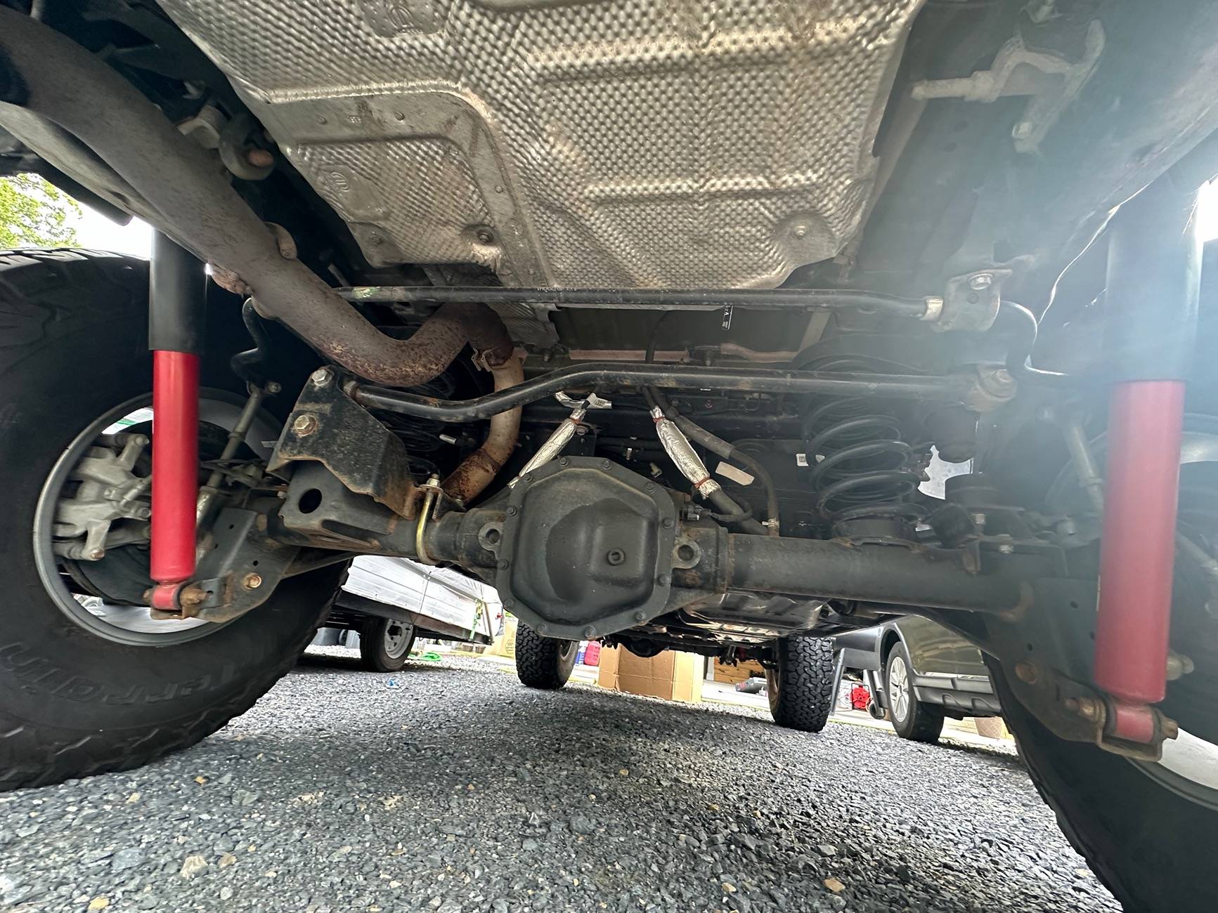

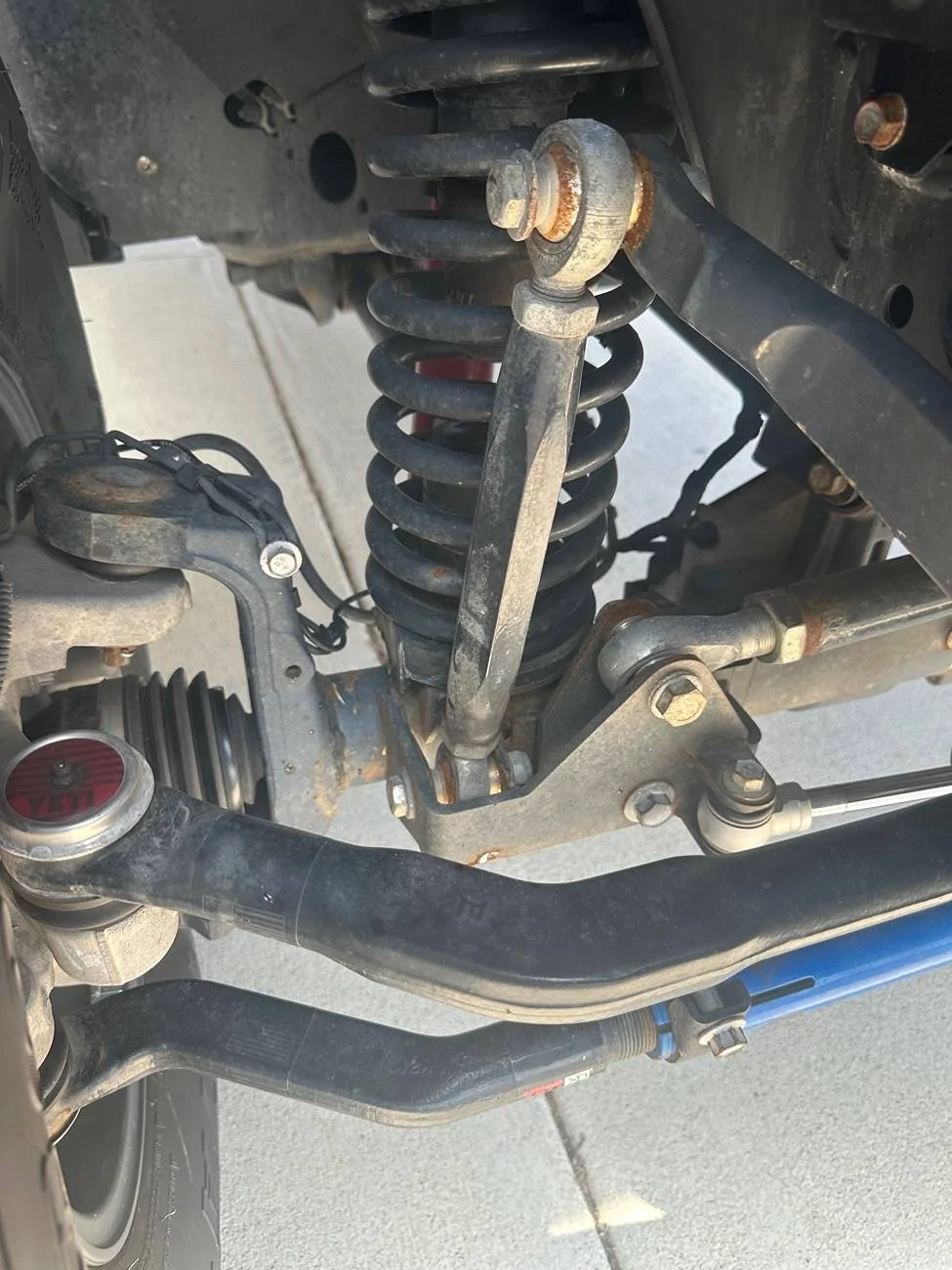

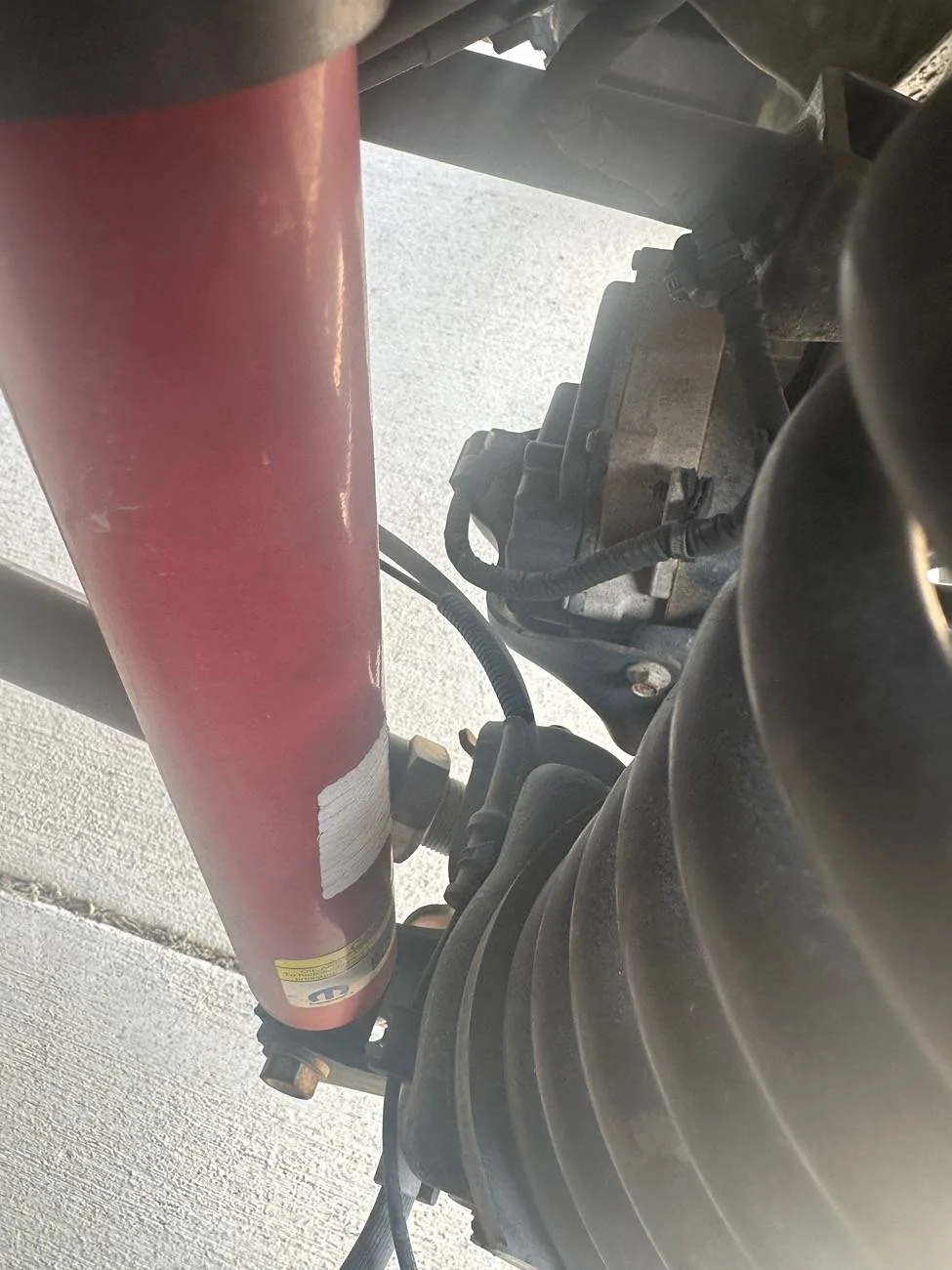

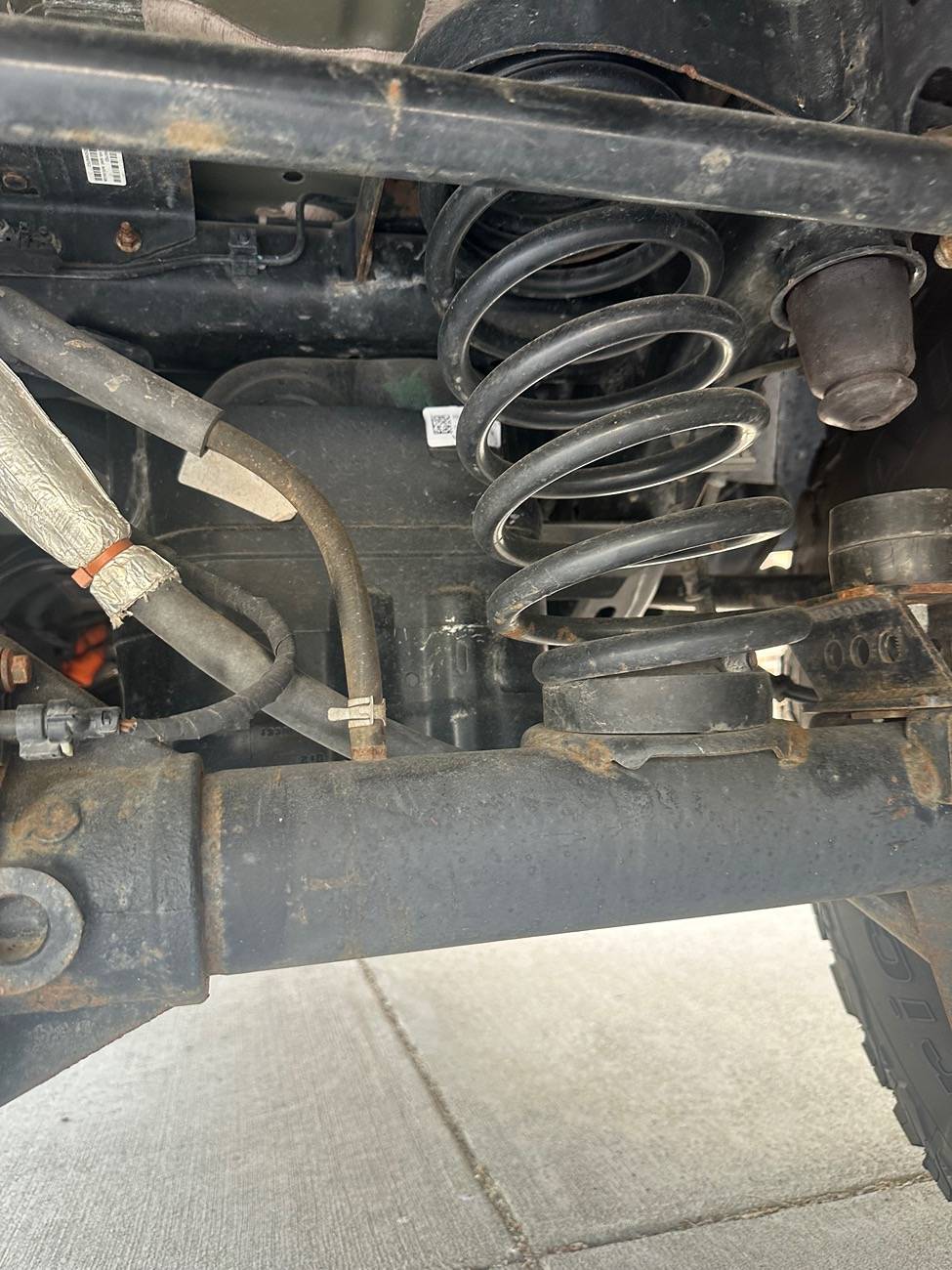

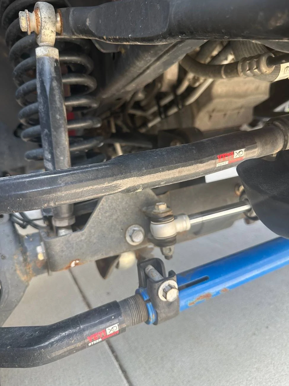

Looking at trading in my 2018 for a 2021 with a lot lower mileage, but it's got a lift kit on it already. Wondering if any of the lift gurus on here could help me identify the lift and know what to look for as far as potential problems, changes that need to be made, etc.

I'm not a guru but that looks like stock springs and shocks with spacers added for lift. The rear spacer should be on top of spring, not on bottom. Suspension articulation looks limited by stacked bump stops and stock shocks. Maybe they pulled a lift kit off and put stock items back on since they are selling the jeep. Maybe a true suspension guru can step in with more info.

The front sway bar end links look like rock krawler and the yeti steering links are also high quality. I'm guessing they pulled the rock krawler lift and threw spacers at it? I'd suggest me springs, shocks, and shorter bump stops, unless you're running 40s.. We don't ruin that much bump stop in the back with 39s and they don't rub.

I’m only guessing, but looks like a teraflex or RK lift and as @Rsarffs said they took the falcon shocks off or if it’s RK, they took springs and shocks off…and put oems back on to trade it….
The sway bar links are Rock Krawler No Limits sway bar links… it has a flipped drag link with a raised axle side track bar bracket….. drag link and tie rod are Steersmarts.

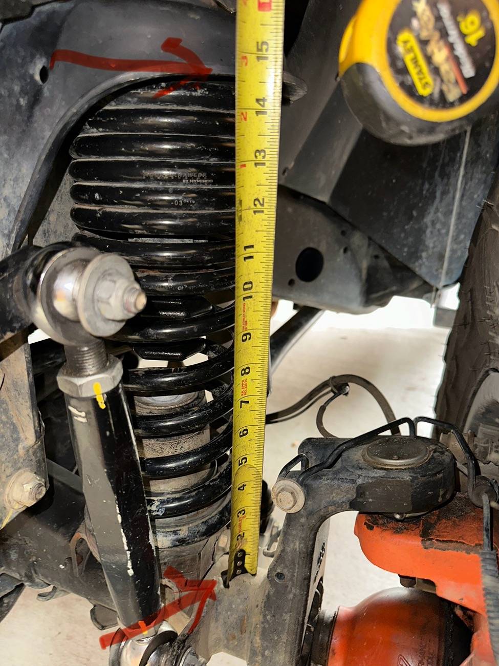

Look closer at the springs and see if they have Teraflex wrote on them anywhere…also I would like to see the other end of the rear track bar….. also measure from top of the front axle to bottom of the top coil housing like in pic…..

I got back under it just now and looking closely at the springs in front I did find that they say Rock Krawler on them.

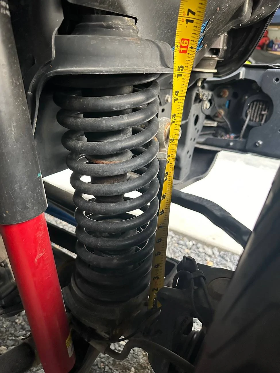

got a better picture of the rear track bar (I think) and measured from the axle to the coil housing too.

I’m not a mathemascientist . . . . but based on those measurements, the stock Rubi shocks have to be screaming!

Adjustable lower front control arms on there, try to see if there is full set and what brand.

STAY AWAY FROM THAT WRANGLER WITH THE RETARD LIFT!!!
If you do buy it, the first thing you need to do before you even take it off the dealer lot is to tell them to fix the rear suspension coil spacer. It MUST be on the top!
Seriously though, whoever the hell butchered the shit out of that Wrangler suspension along with those ridiculous bump stops, stay away from that vehicle, you don't know what else they ****ed up!
