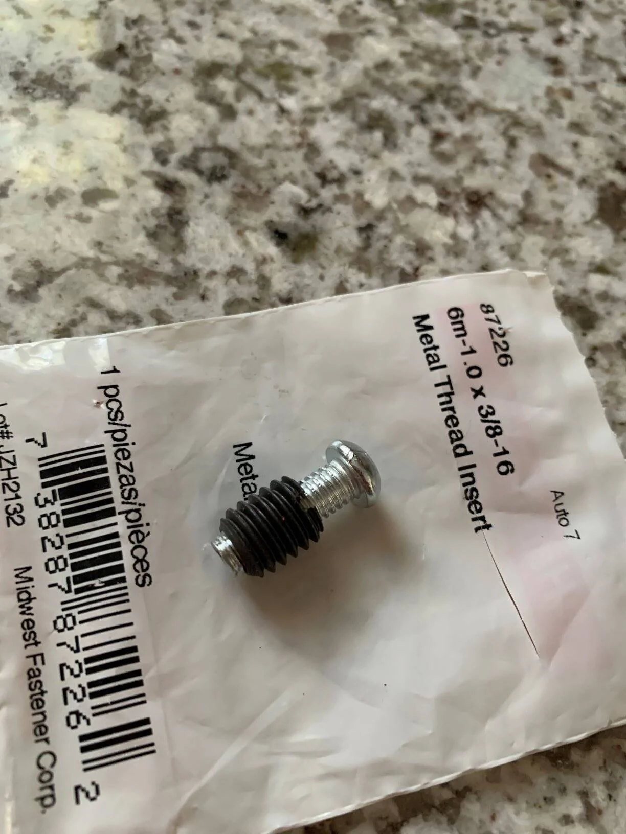

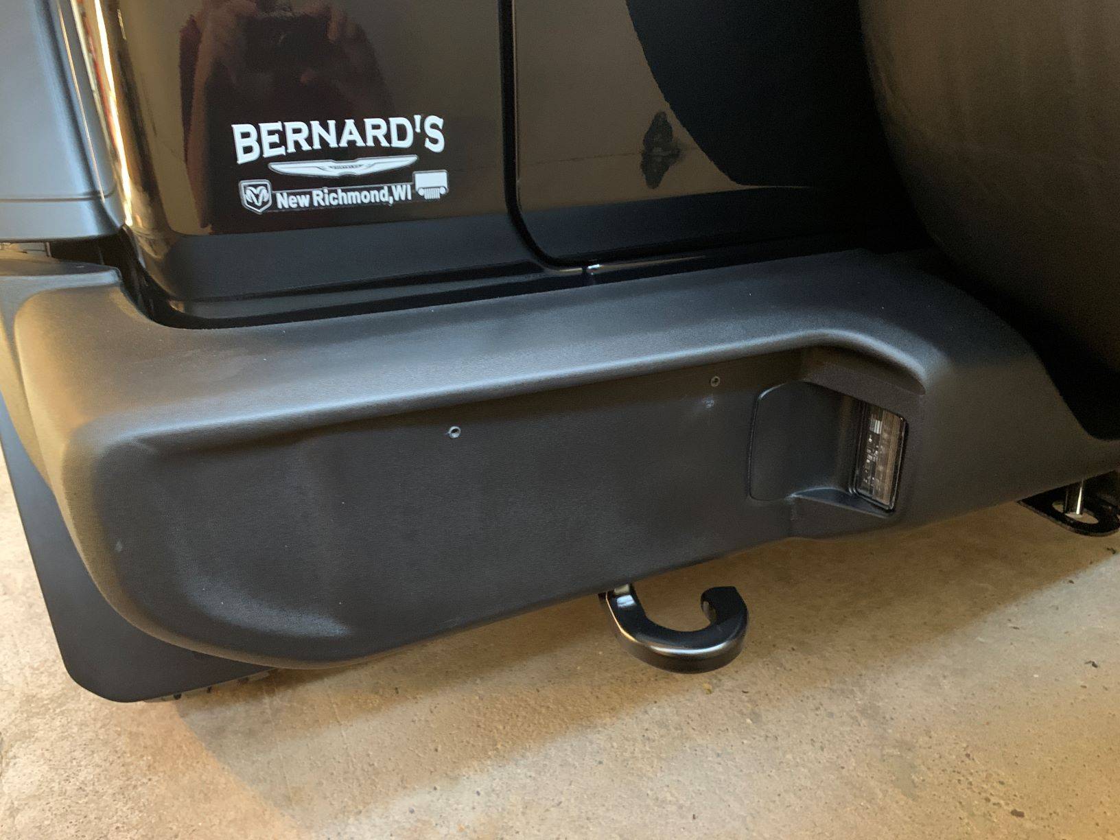

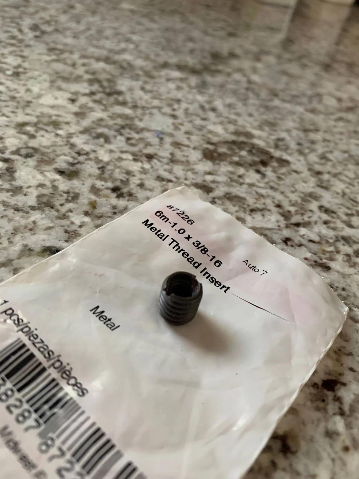

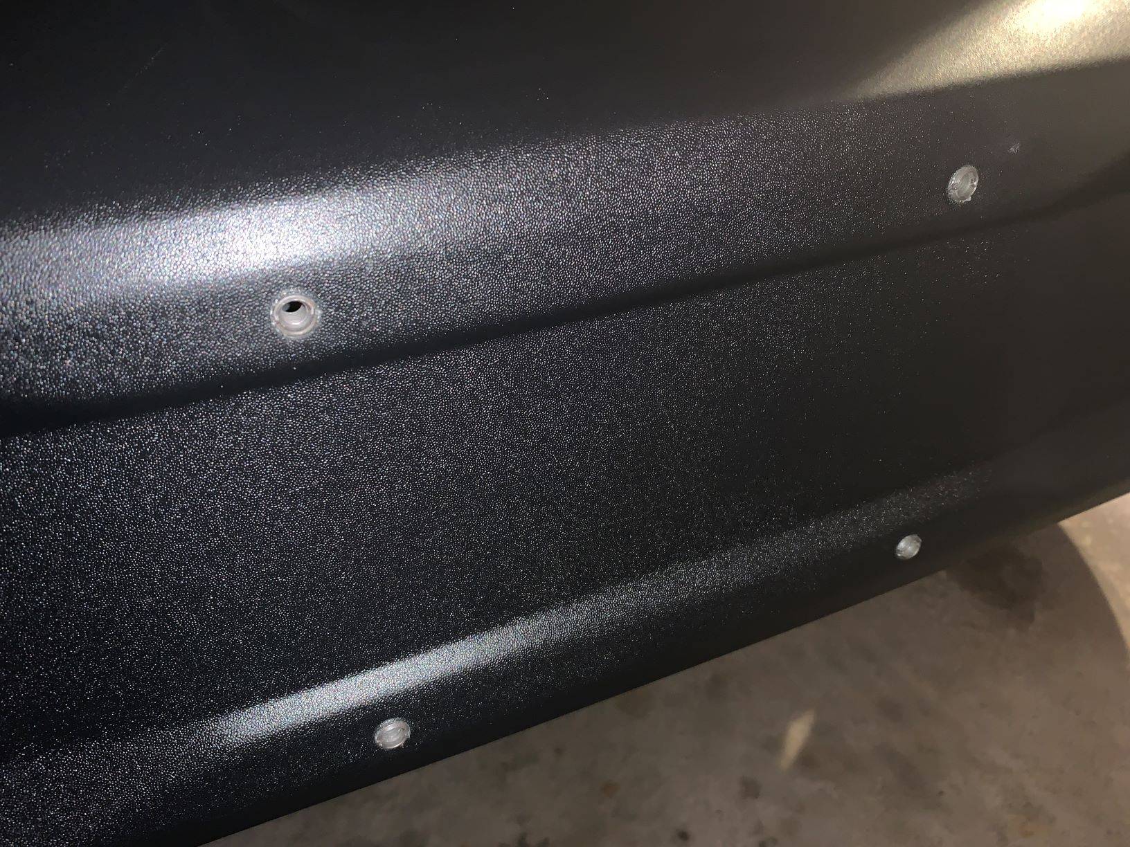

The one beef I have found about our new 2023 Wrangler Sport Altitude was the license plate fasteners. The dealer simply drilled a few holes in the front (front plates are required in Wisconsin) and screwed in a few lag screws, which I hate. The rear was the same way. I fixed that issue by drilling out appropriate size holes to install screw in inserts to accommodate the license plate attaching screws I purchased with a clear plate cover. Applied a little epoxy to the inserts to make sure they stayed in place. Cost me $18.00 for 8 inserts, $16.00 for a pair of clear covers/with hardware, and 20 minutes of my time. We are getting personalized plates so wanted to make them secure and a clean install.

Cool hack. I think I would have opted for some nutserts. If in plastic only, put a washer on the back side before flaring the nutsert to sandwich the insert to the plastic. I used nutserts when I installed mudflaps on my Jeep and they have held very well.

Both my Jeeps have had the lag screws in them too. Even with the steel bumper group option, the license plate area is a big plastic insert. OP, that looks really nice! Now you need to remove the dealers advert on the back corner. Takes away from the nice lines ;)

That's nice! Always thought the idea of screwing what's essentially a big wood screw into plastic was stupid and prone to irreversible wear.
