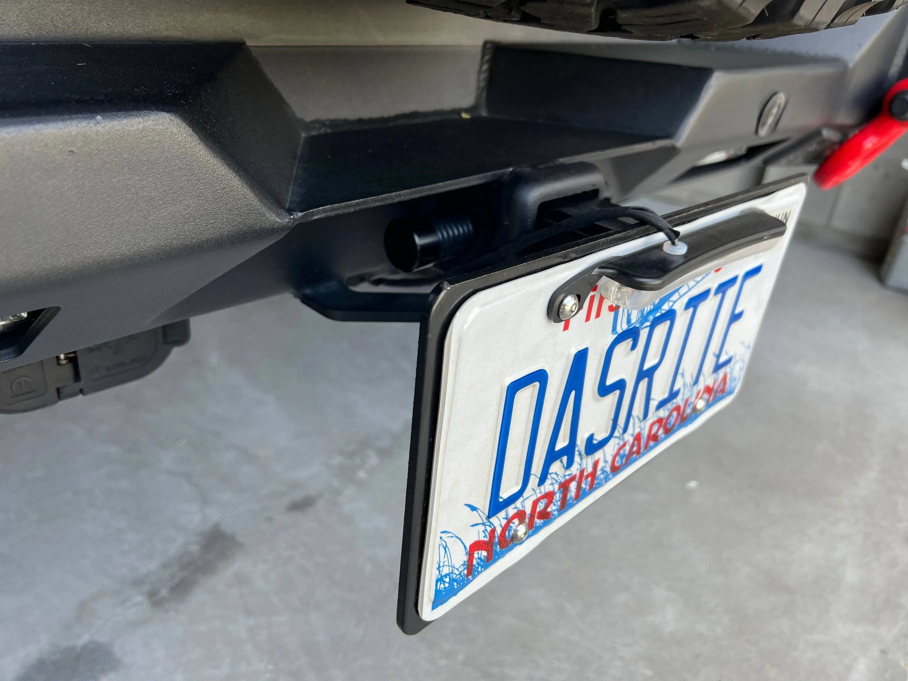

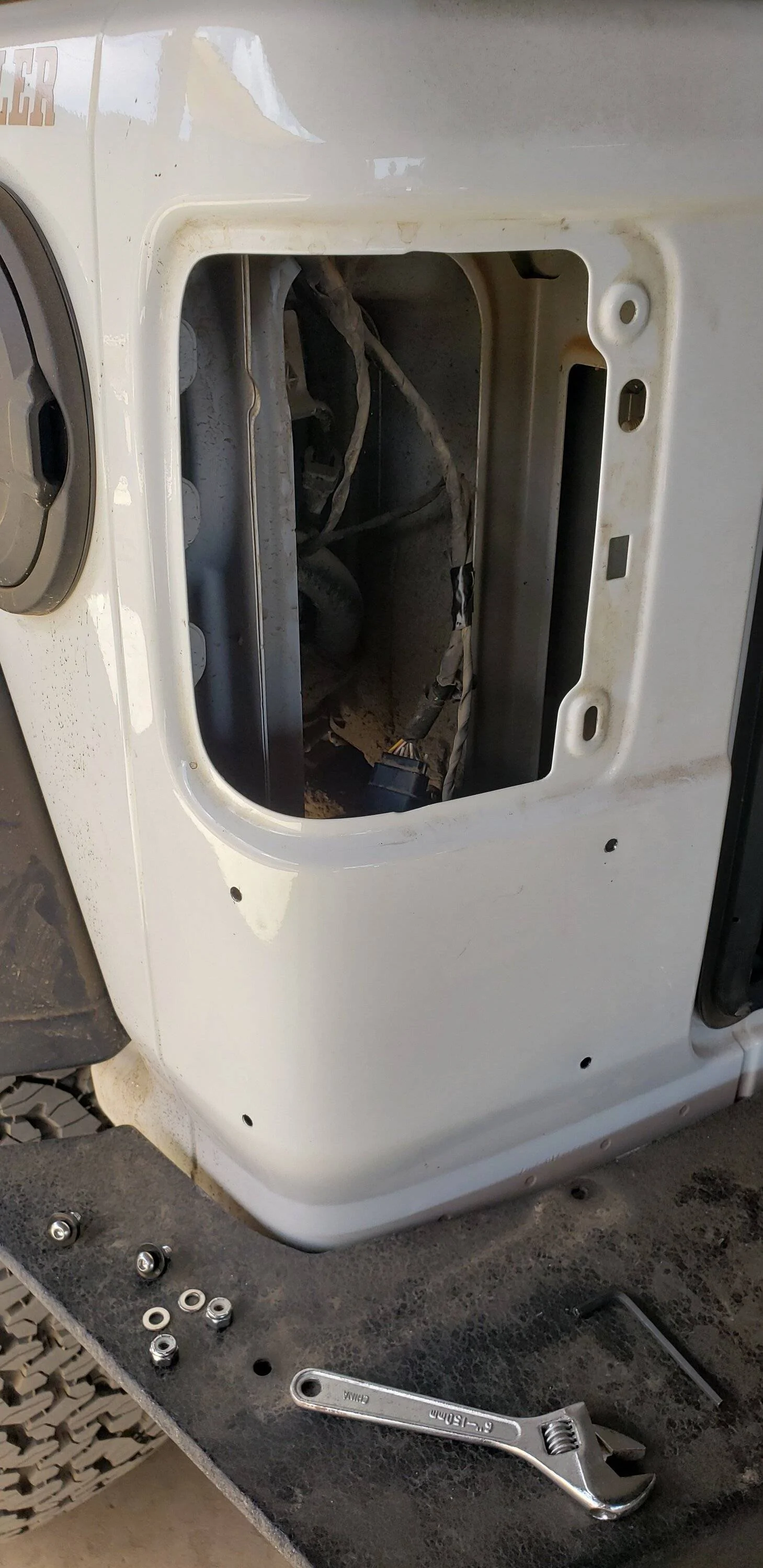

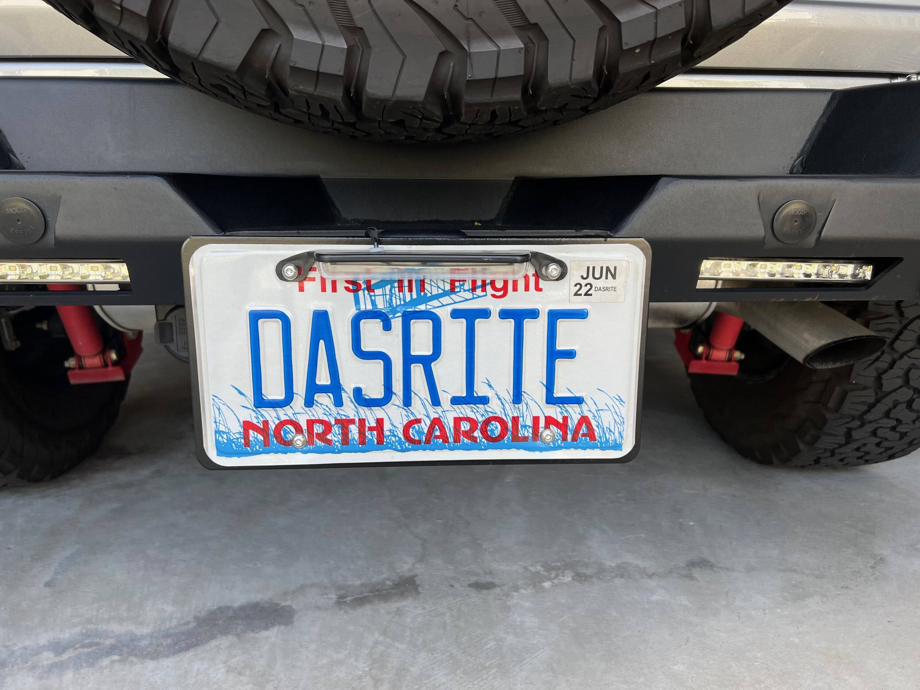

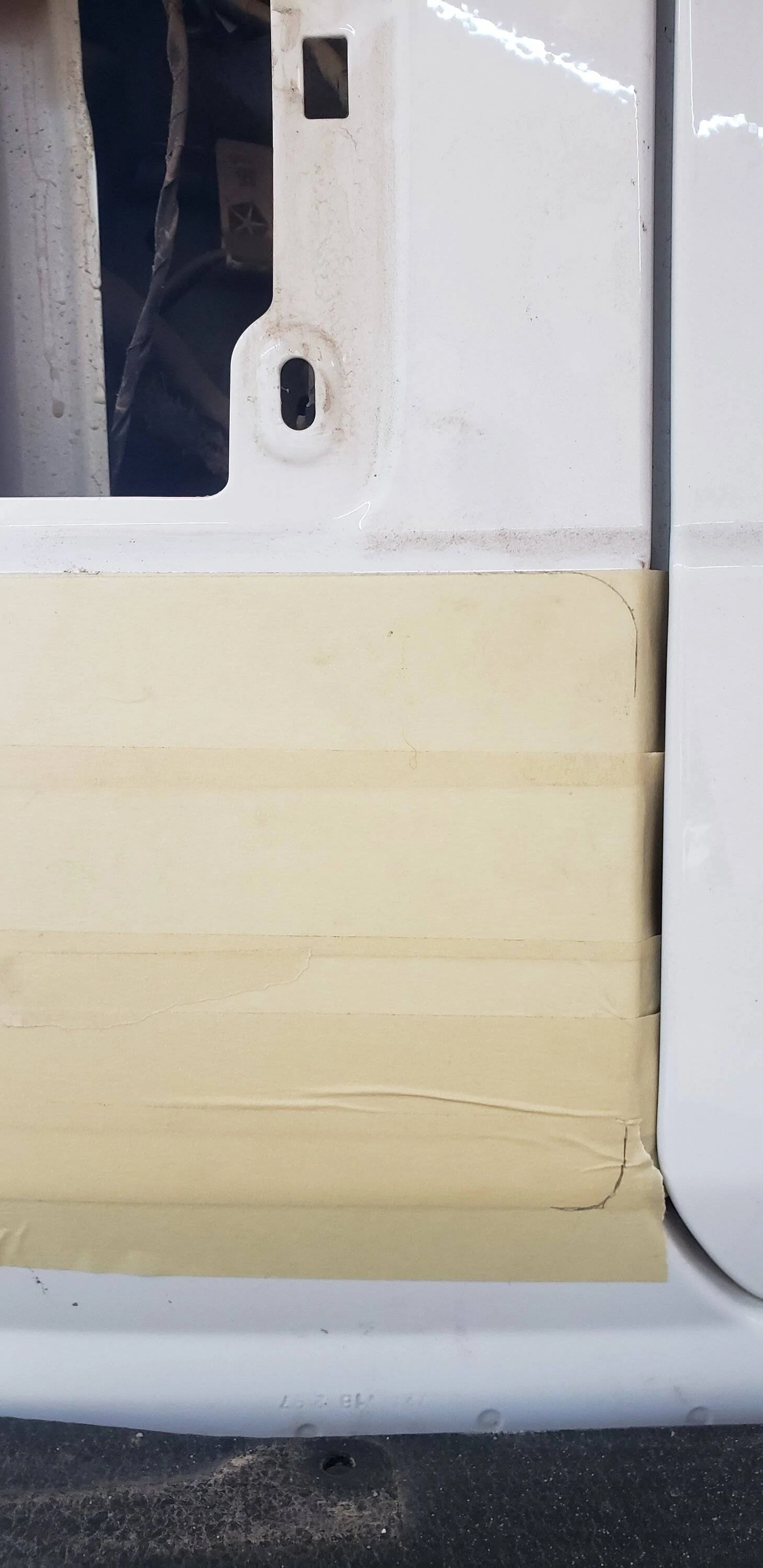

Here's how I mounted my license plate. I made some spacers from kydex to keep the plate from chaffing on the paint. I did some simple rewiring and added the plate light under the tailight assembly. I ended up painting a plate frame to get a clean look.

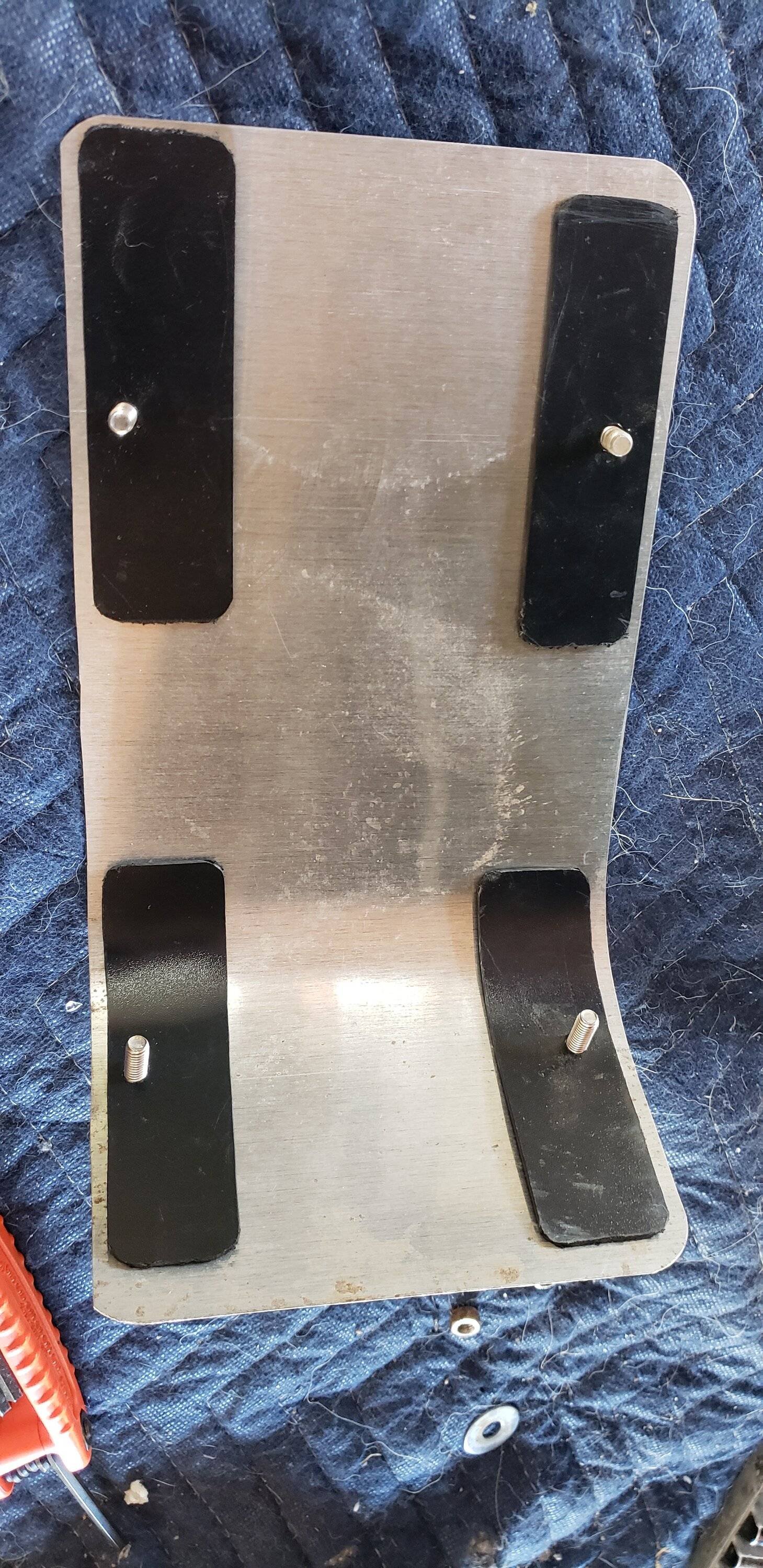

I did like the Rebel one but not enough to buy it. It wasn’t the price, I just didn’t like it touching the body so I made this one….. P.S. this two door belongs to my wife. In a few weeks I will have 2023 gladiator on order.

After having mine on my spare tire for the longest time, and getting annoyed with car washes catching it and having to remove it when getting tires rotated (yes, I'm one of those people that use non-touchless car washes and lets other people rotate my tires), I moved mine to a hitch plate.
I never use my hitch anyway, and I can easily remove it when off-roading to gain back any lost clearance.
