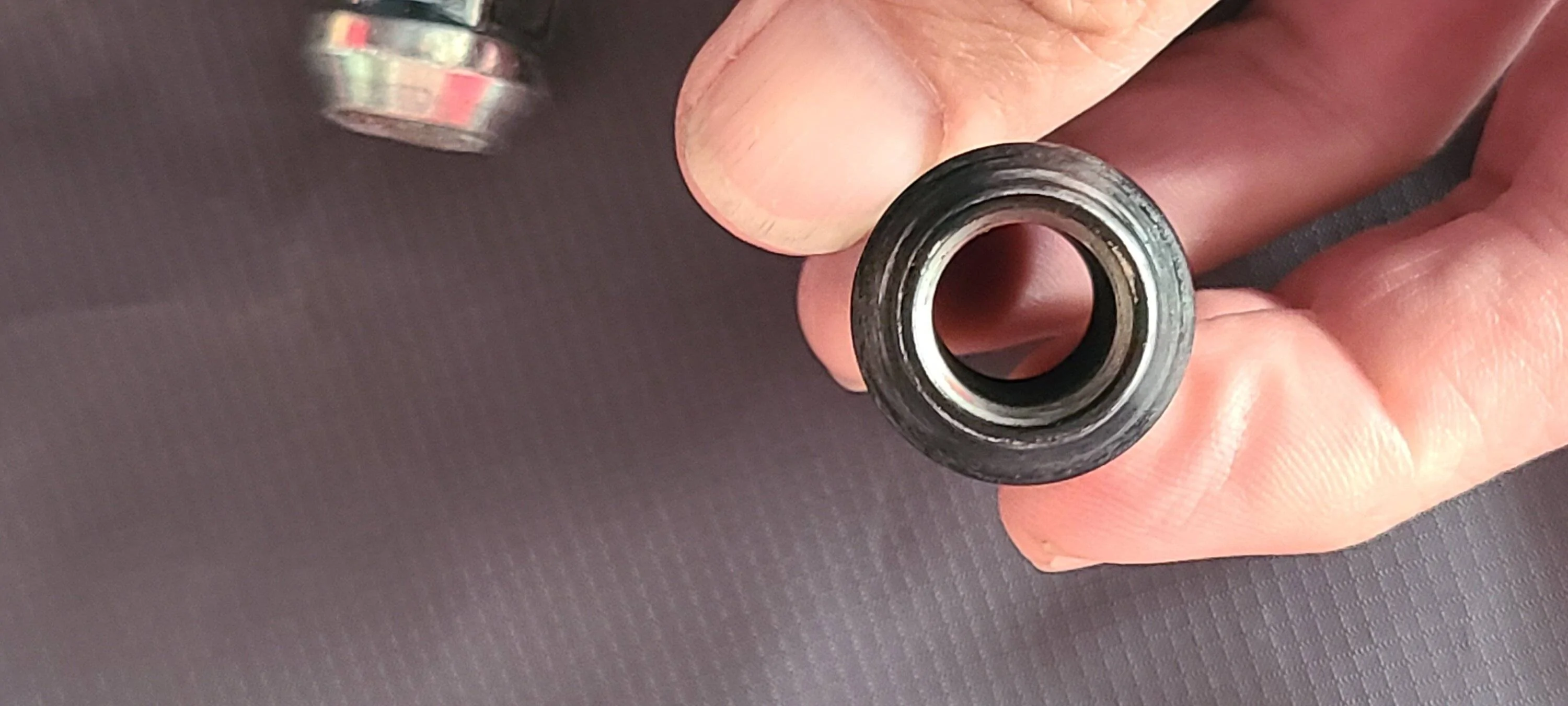

There is no contact marks on one side of the cone on the China Dorman lug.

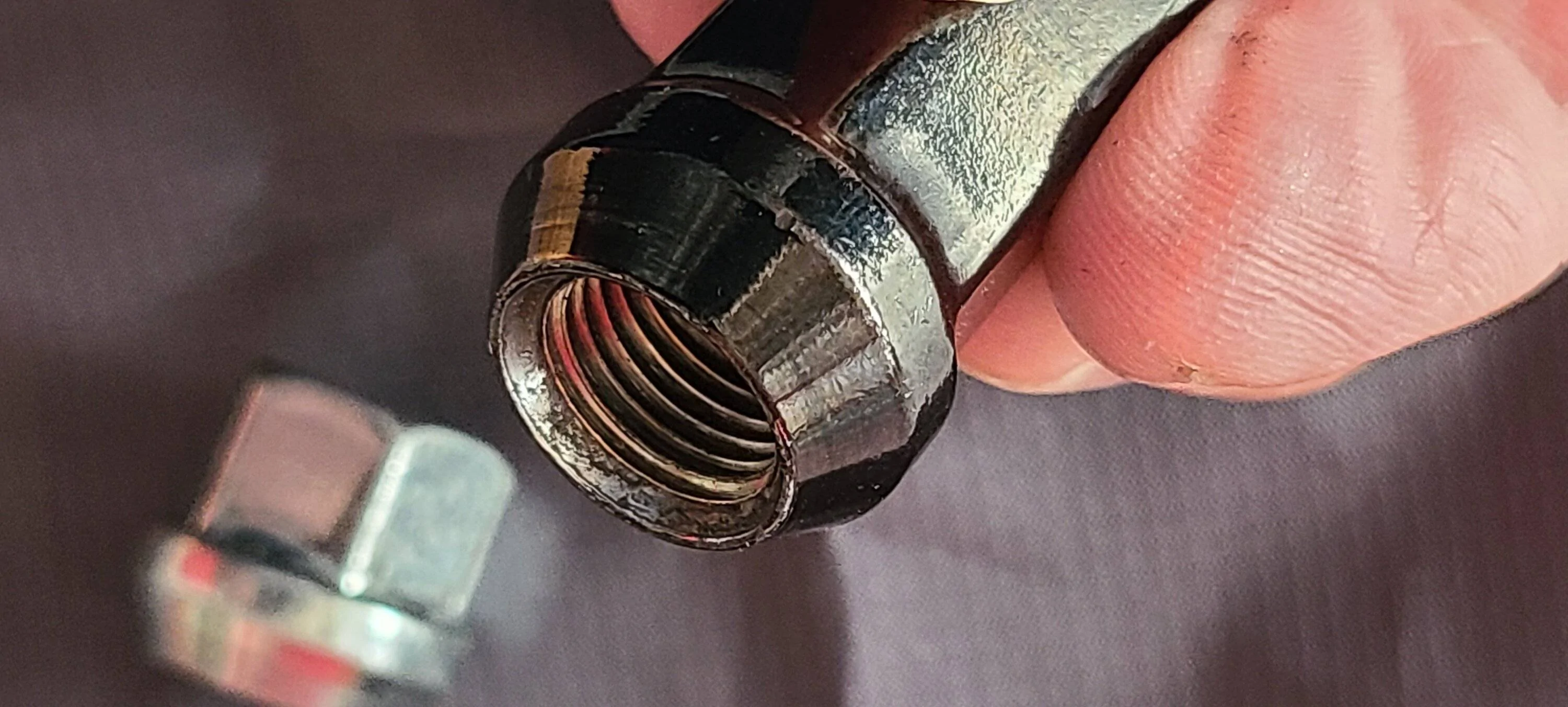

Here, you can see a full circle of contact on the Gorilla lug

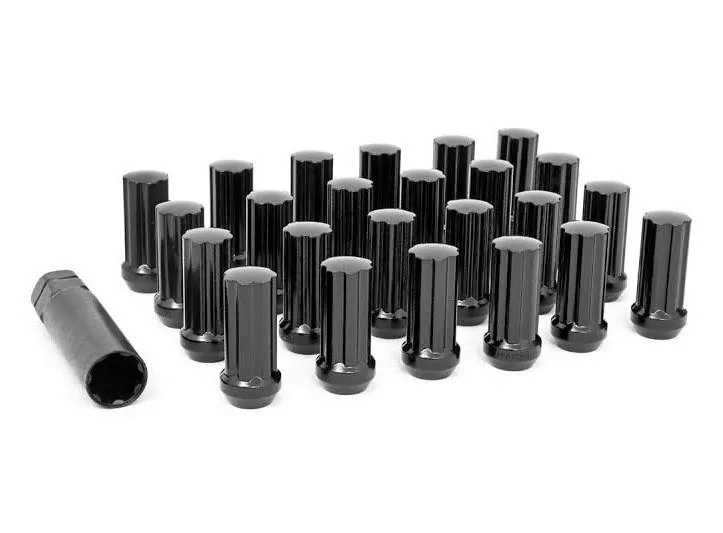

When I got my Icon Rebound Pro's installed on my Jeep, the shop who installed them sold me some lug nuts that look like these.
Jeep Wrangler JL Let's get Nuts here images
The ones in the photo are Rough Country's, though I don't actually know which ones they sold me brand-wise, I just know that they're really nice quality steel, and they seem to be holding up pretty well. They sold them to me at cost for 20 of them. I used to spend a lot of money there, so there were always good to me.

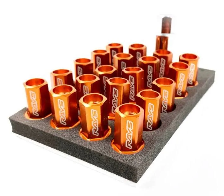

I bought these really cool Volk Racing lug nuts for my wife's Subaru Forester a couple years ago.
Jeep Wrangler JL Let's get Nuts here images (1)
They are pretty cool, though they were a bit expensive. I actually would love to upgrade hers to those $200 titanium lug nuts they sell on Amazon. The aluminum ones on there I have now are cool, but they're definitely wearing out over the last 2 years. Taking them on and off every 6,000 mi for the last 40,000 miles, they definitely aren't the same as when we bought them. I blame the aluminum. They're still secure, just the threading is starting to go.
Aluminum and titanium both have characteristics that can lead to galling of the threads.
For Aluminum, either 2024 or 7075 in their respective highest hardness condition, is stronger than the cheap 6061 alloy. But 6061 is the most available and cheaper, therefore it get the nod for most machined parts where there strength requirements are vague or undefined by the manufacturer. 7075 carries its own baggage with its susceptibility to intergranular corrosion, stress corrosion, etc., making 2024, with its strength between 6061 and 7075, a more rounded choice for products exposed to the elements.
Titanium is expensive but can be a good choice where the strength of mid strength steel is needed but weight is critical. Basically, you're paying multiple times the price of steel to save a bit of weight.
Steel, in appropriate alloys and hardness, is the best functional choice for lug nuts. Titanium and aluminum offer no real life benefits, other than being "trick", for a lug nut. Save your money and use it for something else.
I never thought about it like that, really informative. I appreciate your knowledge! The funny thing is there's a whole lot of options when it comes to orange steel lug nuts. Wife really likes the orange on the lug nuts, really completes the theme of the Forester sport. I'll have to look into those before the next oil change. I was meaning to replace them at that point.

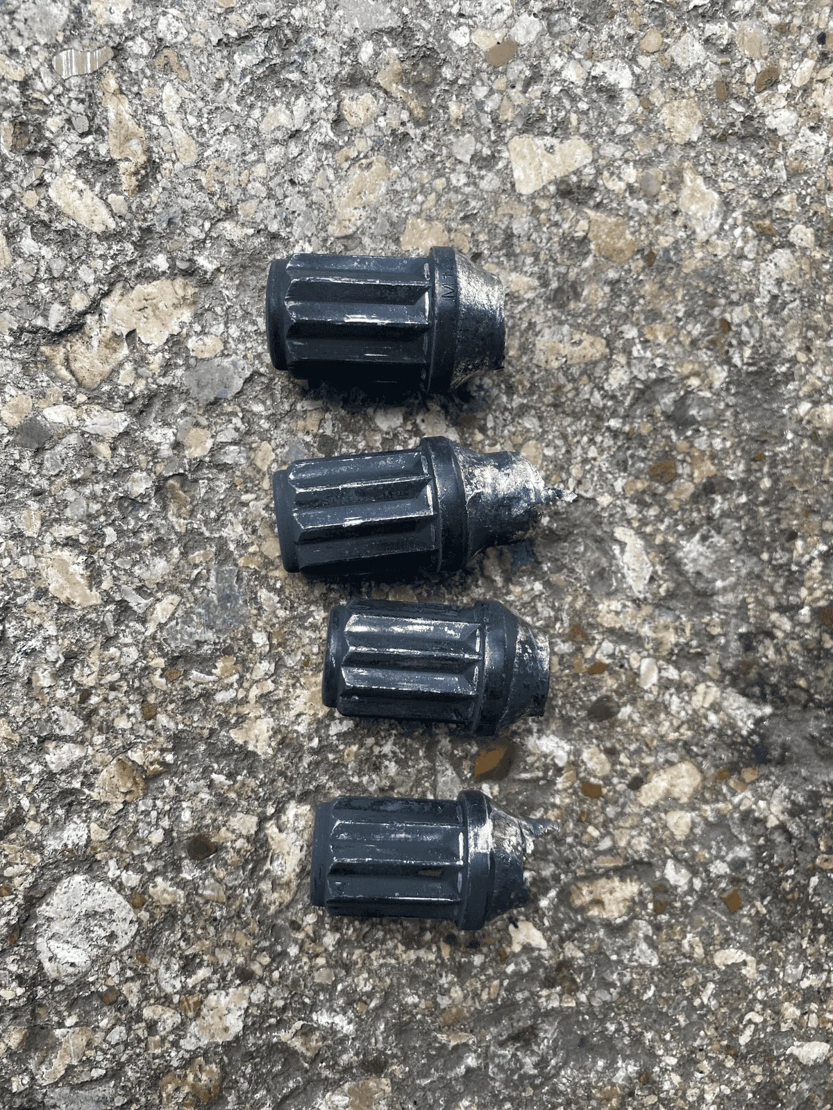

And speaking of scary Chinese spline nuts~
Here's a pic from this post from @NewTXJL
https://www.jlwranglerforums.com/fo...tter-safer-lug-nuts.43461/page-3#post-1121284
Jeep Wrangler JL Let's get Nuts here 1678978951656

@roaniecowpony excellent posting as usual, and so true regarding all the manufacturing differences from lug nut design, wheel bore contact area, bore depth, etc. FWIW the lug nuts that I've been using have a solid fit and seem to be well made. Rust is appearing on a few of the outer edges from socket use, so there's that, but otherwise they seem to be doing a good job :) I use copper anti-seize on my lugs, my inner wheel surface that mates to the rotor, the inner and outer rotor mating surfaces, and the hub. Not really pertinent to lug nut talk, but it really does help when servicing wheel/brake related parts :)
I'm guessing those had the stud bottoming on the thread or the bottom of the hole in the lug nut.
And probably an impact gun that went rogue as well :(
