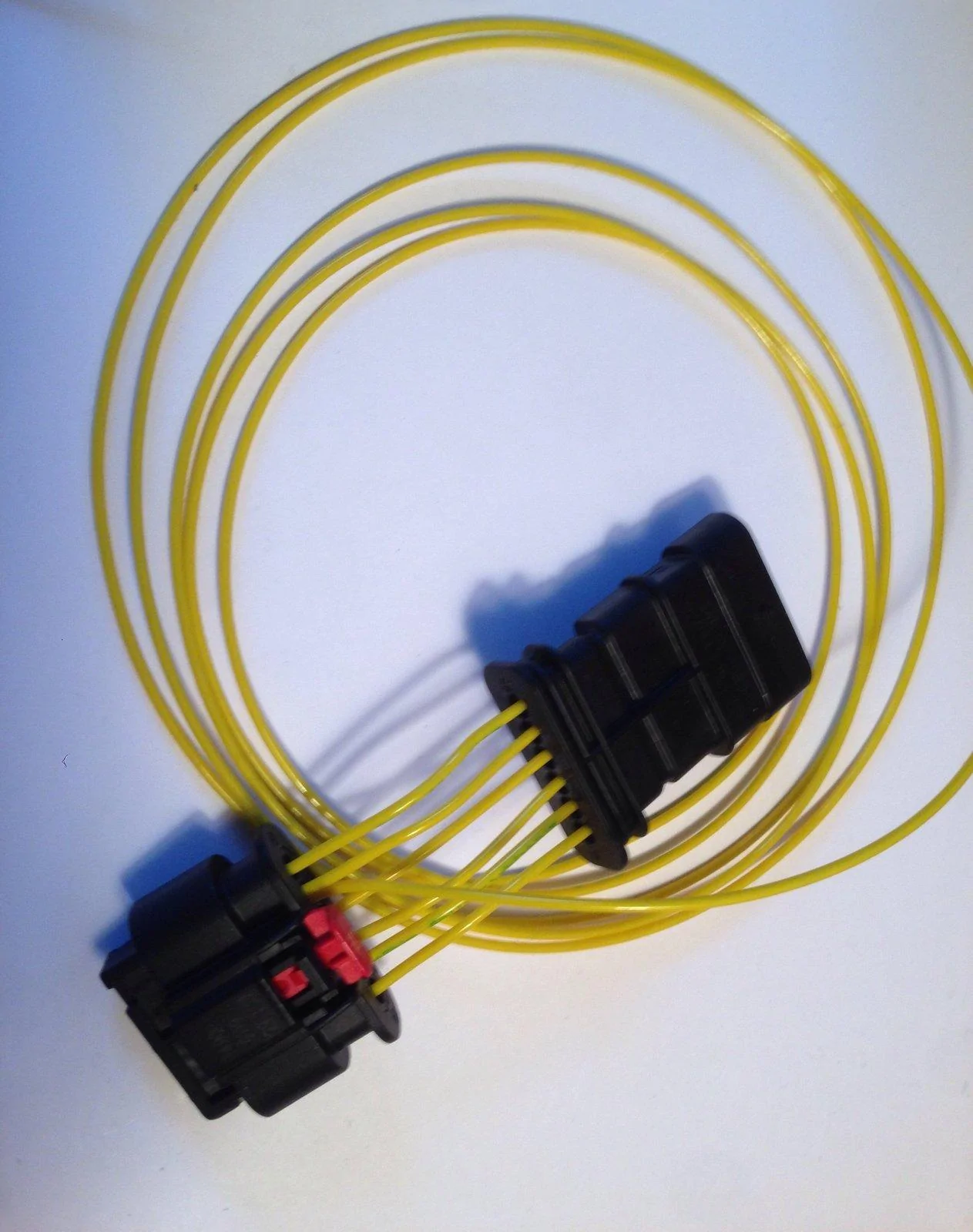

A while back I made a pnp jumper to steal signals (or drl or turn or park) from the side light harness. Problem is getting to the connector you’d have to pull the fender liner as the connector sits about 3ft back from the headlight

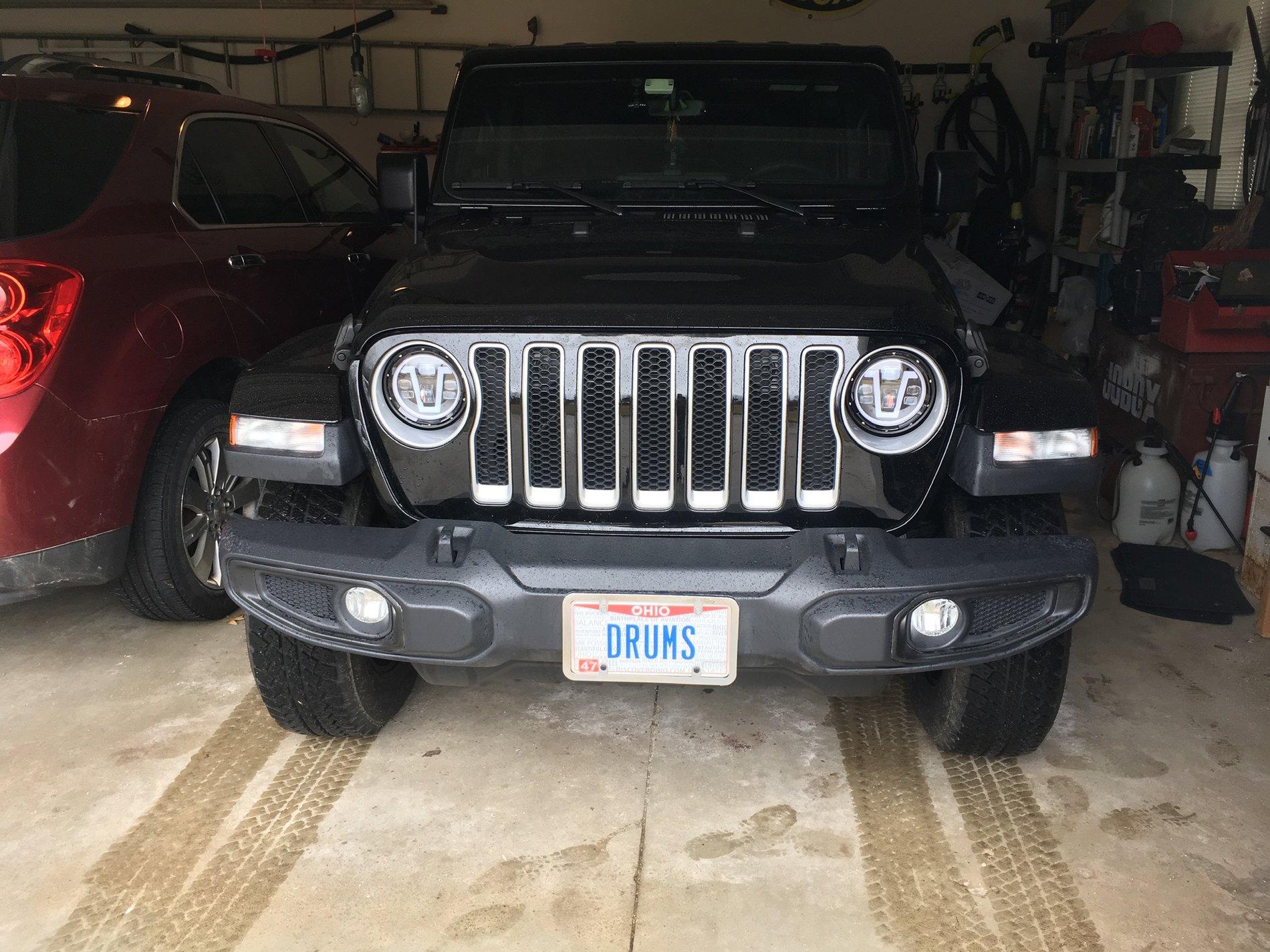

Maybe a dumb question, but I just received new led headlights with a halo ring. The ring has 2 leads off of it. 1 for turn signals and 1 for drls. Is there a reason I can’t just tap these into the same wires the fender mounted lamps are tied,into?
If not I can get to the fuse box easily enough for the DRLs, but where do I splice the turn signal wire to ?
blnewt
Brad
Oct 8, 2018
99
9,956
24,084
New Mexico
Just ask @cosine he knows!
Your Sahara should have the fender DRLs along w/ the turn signal in those two part lights. Should be able to splice into the DRL wire for your halo and the turn signal wire for your amber halo switchback. Wiring colors are here~

Kind of what I thought, I put the headlights in today and will get to the wiring for the drls next week. Was thinking that I might not do the turn signal connection and just power the drls from the fuse box. However trying to find a fuse box tap for these microfuses is a real trip.
Had to go online for them.
