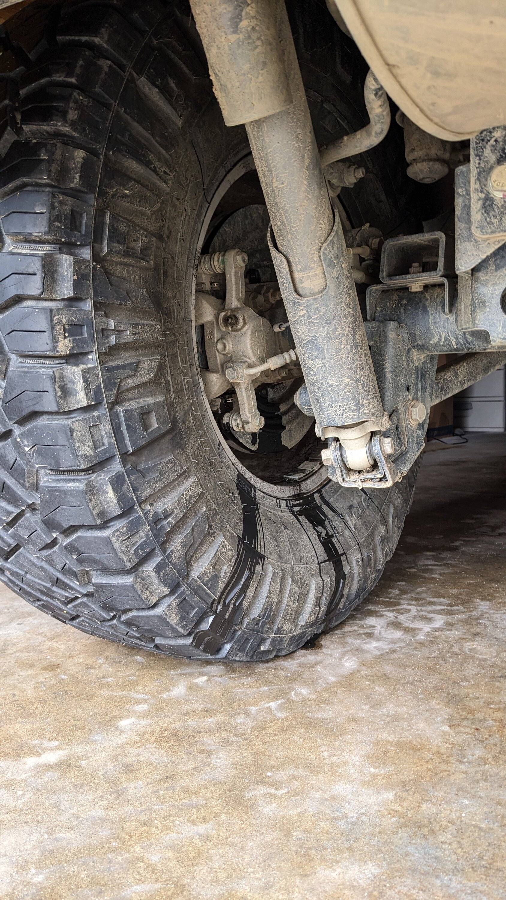

Hung out with the boys last weekend and yesterday I realized I have a leaky rear end...
Jeep Wrangler JL Leaky rear end PXL_20230327_163021059
This is the second time it has happened. First time was shortly after I re-geared. I had a trip coming up and everything was back order in 2021, so the shop fixed it with some RTV. It had been good since. Last September, I bent the axle flange and had to pull the OE shafts out for a set of Dana chromoly shafts, which came with everything pressed on. Knowing the seals are likely to leak in the future, I applied some RTV when installing. And sure enough it starts leaking again, it looks even worse this time.
Do I just remove the shaft, clean out the old RTV and be more generous with RTV this time? Or do I change out the seal? What's you suggestion?

I'd pull the seal and replace it.
Be careful with the silicon when you install it. You don't want too much. Just a thin film between the axle tube and outer edge of the seal.

Yeah, I will probably order a new seal and bearing. In the mean time, try the RTV and see if it fixes the leaking. Pulling the shaft is quick and easy. If it still leaks, I will cut the bearing and replace the seal.
