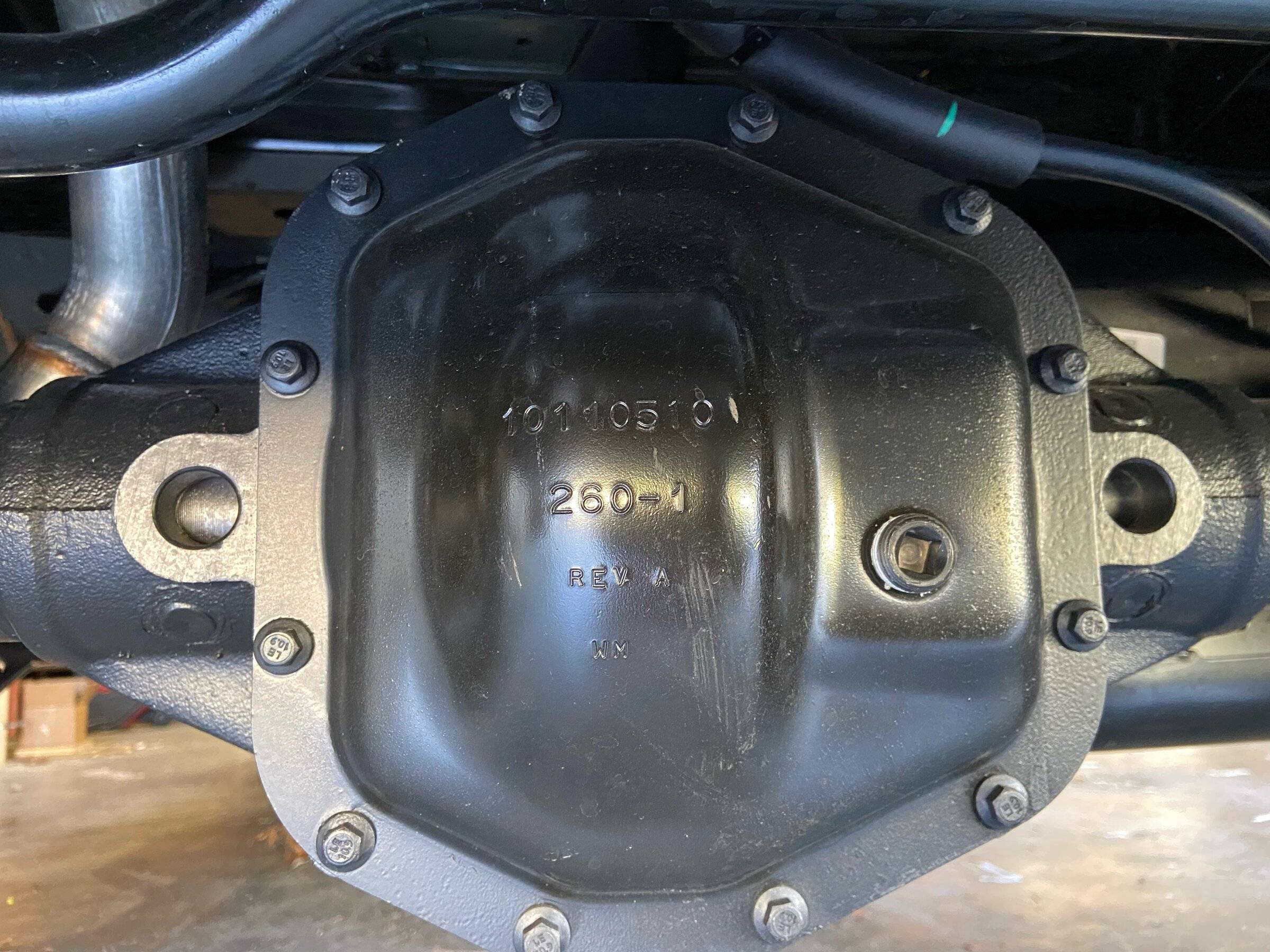

I just got my sport S with LSD, can someone tell me which differential I have . Thanks

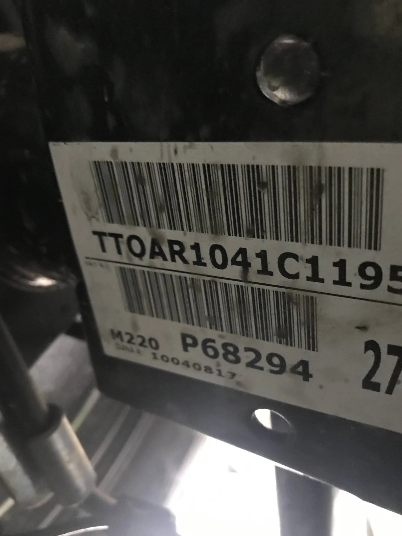

Most all axles when new have a tag on top of the axle somewhere mine was on the bump pad and had M220 Dana 44

Don't the smaller axles have 10-bolt covers, instead of the 12 on the D44?
Nevermind that. Just checked the justdifferentials site, and the M186 and M200 covers for the Sports and Saharas also have 12 bolts like the M210/220's on the Rubicon. They also have a Dana 30 listing that has 10, which is what lead me to all this babble.
