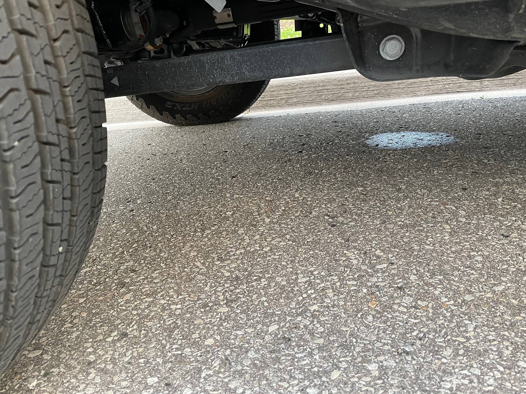

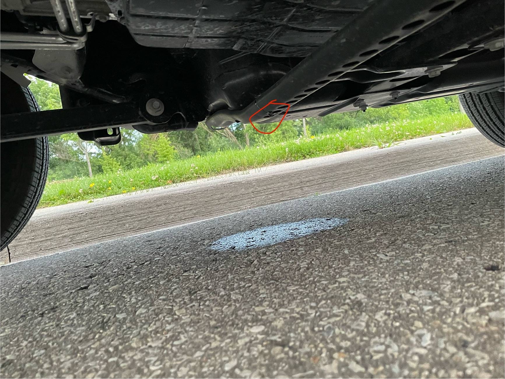

My new 2024 wrangler two door sport 2.0L is leaking mildly. Due to AC usage? No idea…
Anyone knows what’s going on? Is it a serious concern? Please see pix attached

Due to AC usage?
Most likely. Have you never seen water under a vehicle when running the AC in hot weather? It is called condensation. Same effect as when you see water droplets on a cold beverage can in hot weather.

Sure looks like AC condensation. You will notice it after parking briefly. Condensate will evaporate much quicker than coolant and fuel of that quantity you would smell.
