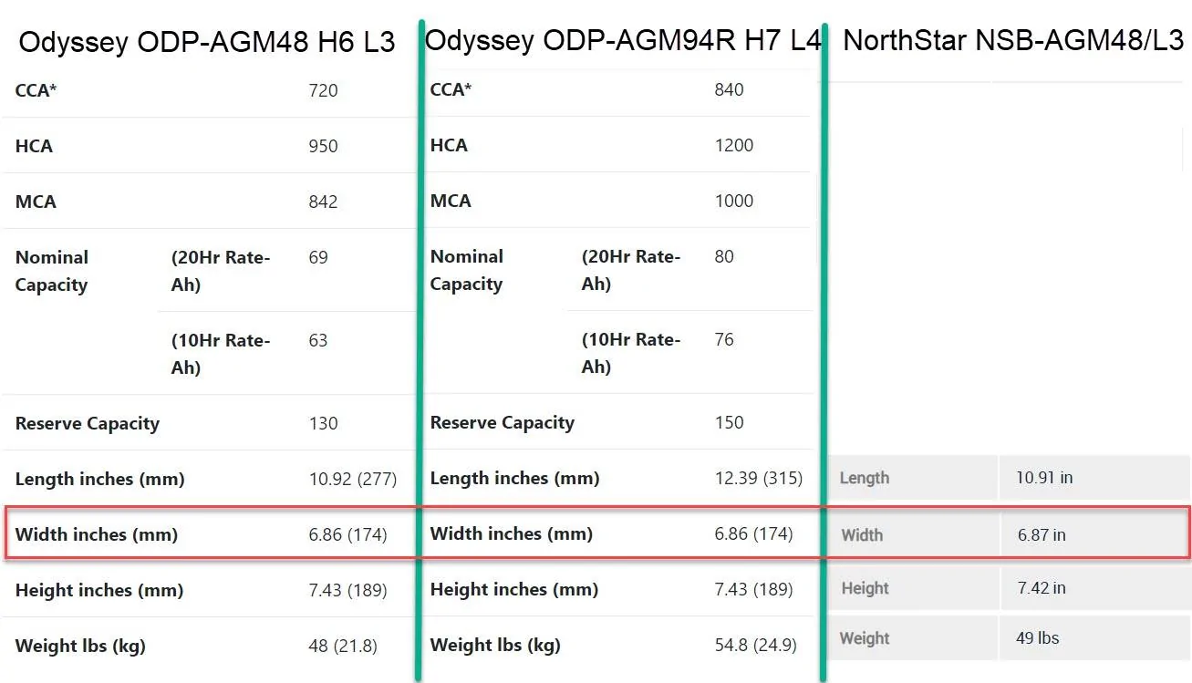

Hey @Rhinebeck01 , Correct me if I am wrong but I think you have the NorthStar AGM48? Here is a comparison between that battery and A couple Odyssey batteries. The width is the same for all of them. I ordered the type 94 so I am hoping it will fit. Could be too long? We shall see :)
@TroyBoy
I called Odyssey at the time I was researching what to buy.. I spoke to the rep there about the Odyssey and the 49 Northstar, measurements, coming out of the same plant.. The rep was unsure if the measurements were exact/correct.. he felt the printed info/specs were possibly incorrect...
The rep went and talked to his resource person and came back on the phone and said the 49 was definitely a no go in a JL....
Based on what was said by the rep, I chose to go with the 48 as I knew it was more then enough for my needs.. I'm looking forward to hearing how you make out with the 49.

Okay so I pulled out my battery today and noticed it was a group 94 already. I wonder if the tow package gives you a larger battery? I went to Canadian Tire and they looked it up and sure enough the stock battery is a 94R.
@Rhinebeck01 I noticed you said 49. I thought that was a mistake but now I’m not sure. I looked up the specs for a 49 and it is an inch longer than the 94 so I doubt that would fit.

@TroyBoy
As I mentioned, if I got misinformation and then posted that misinformation on the forum, I will go back and correct that misinformation. I'm not one to post crapola.... aka: misinformation.. 8-)
@TroyBoy
What exactly did you install today?
Width was aok and you got it secured right..?

Nothing. i removed my aux battery and when I had the main battery out, I measured it. I thought my main battery was a 48 but it turns out it was a 94R. I don’t get my odyssey 94R for another couple of days.

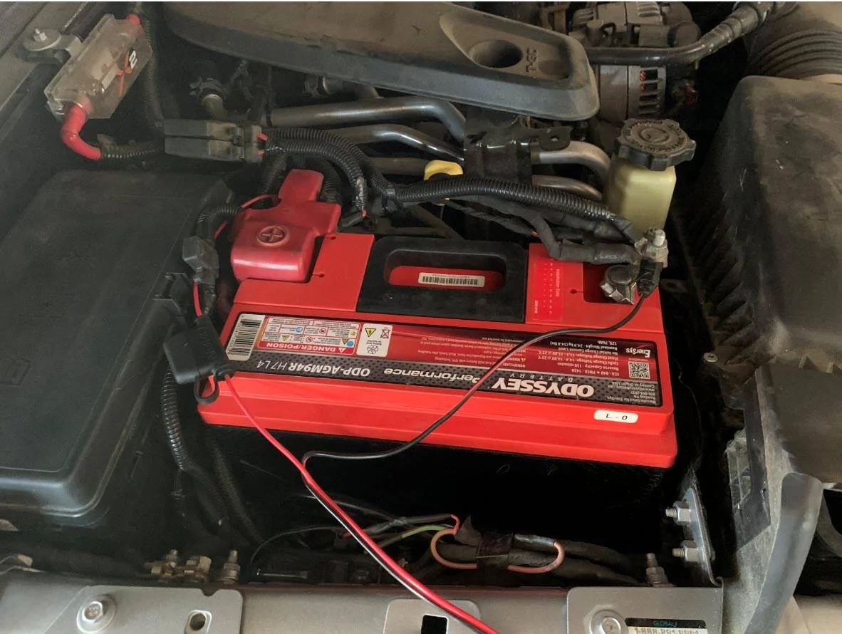

Hey @Rhinebeck01 so the odyssey 94R fits just fine. It's the exact same size as my factory Mopar 94R. I'm thinking you get the bigger battery if you ordered the tow group.
this is good to know, makes sense with the tow package to include a bigger battery, plus it has a different alternator?
my jeep was a base model 2 door, the battery came out of my colorado that i traded in
wanted to see if it fit so I wouldn’t have an issue running my fridge and it worked

After poking around, I felt there was a very likely chance it would not fit and to secure would not be a go. I did not want to get stuck with a battery that could not be secured so when with the lesser size..
IF your Odyssey, 94 fits/can be secured properly with stock retainer piece, I will remove/edit my post so I there is no misinformation in my post(s). Thanks!
I installed a Odyssey 94 and its secure and not going anywhere.
