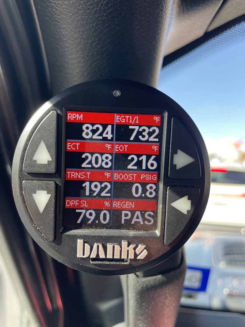

What are you guys using to monitor soot levels, etc? Banks?
