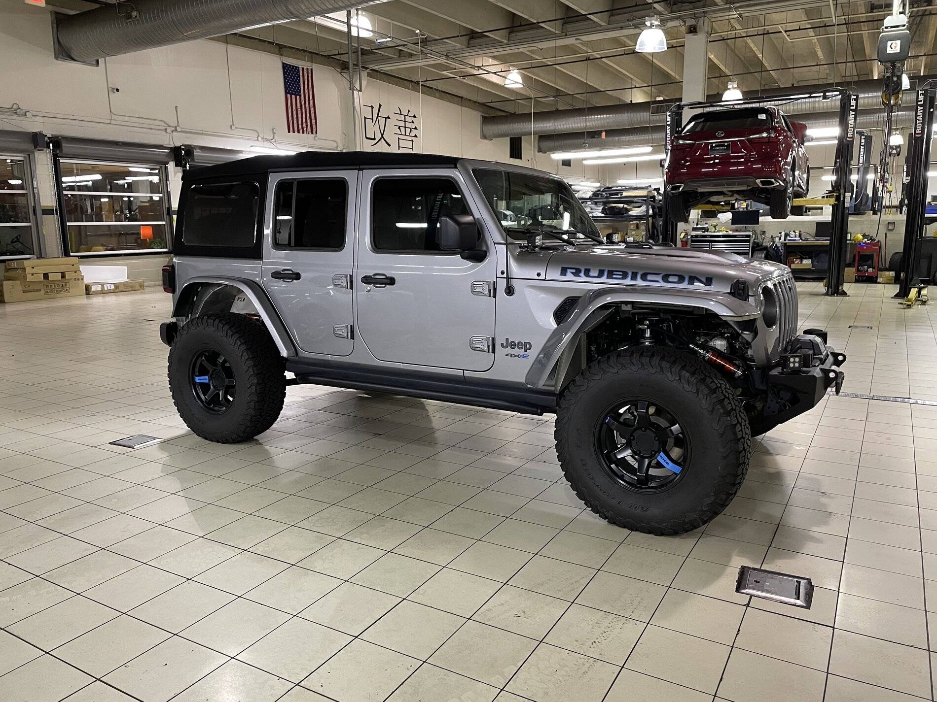

I plan on taking it to the off-road park this Sunday to play as long as the updated rear springs come in. I need/want another inch at ride height in the front and a little more than that in the rear. But here it is on 37” bfg k02 (measured 35.5”)
Cool, thanks! Looks great, let us know how it goes offroad and of course some flex pics! Which fender liners are those? Did you have to modify them?

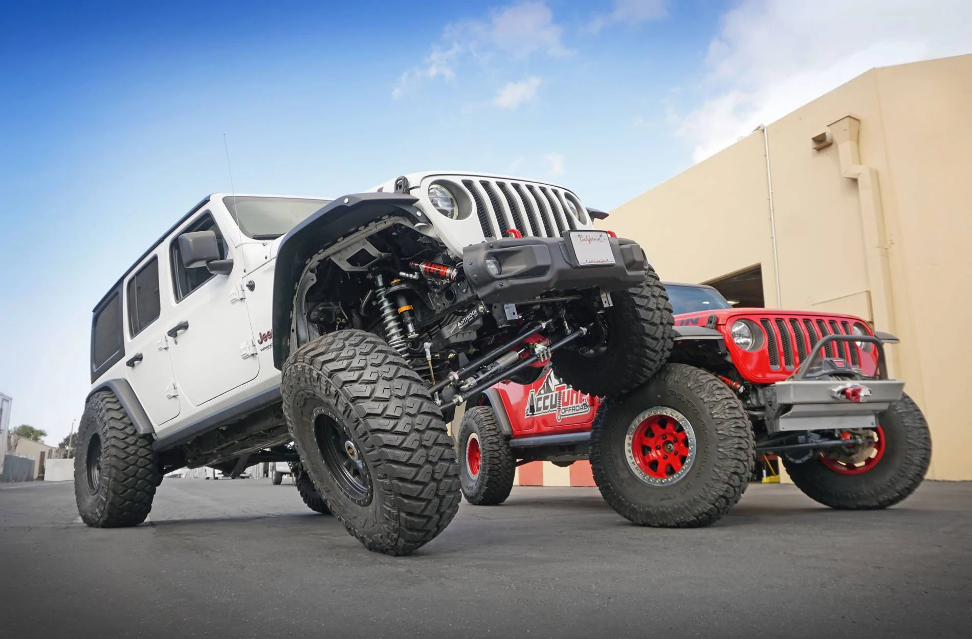

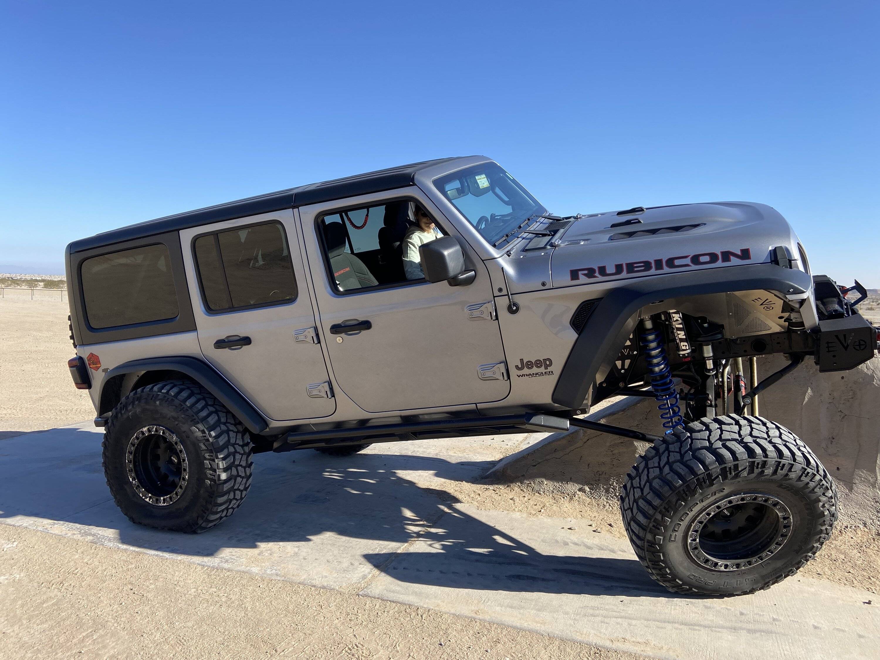

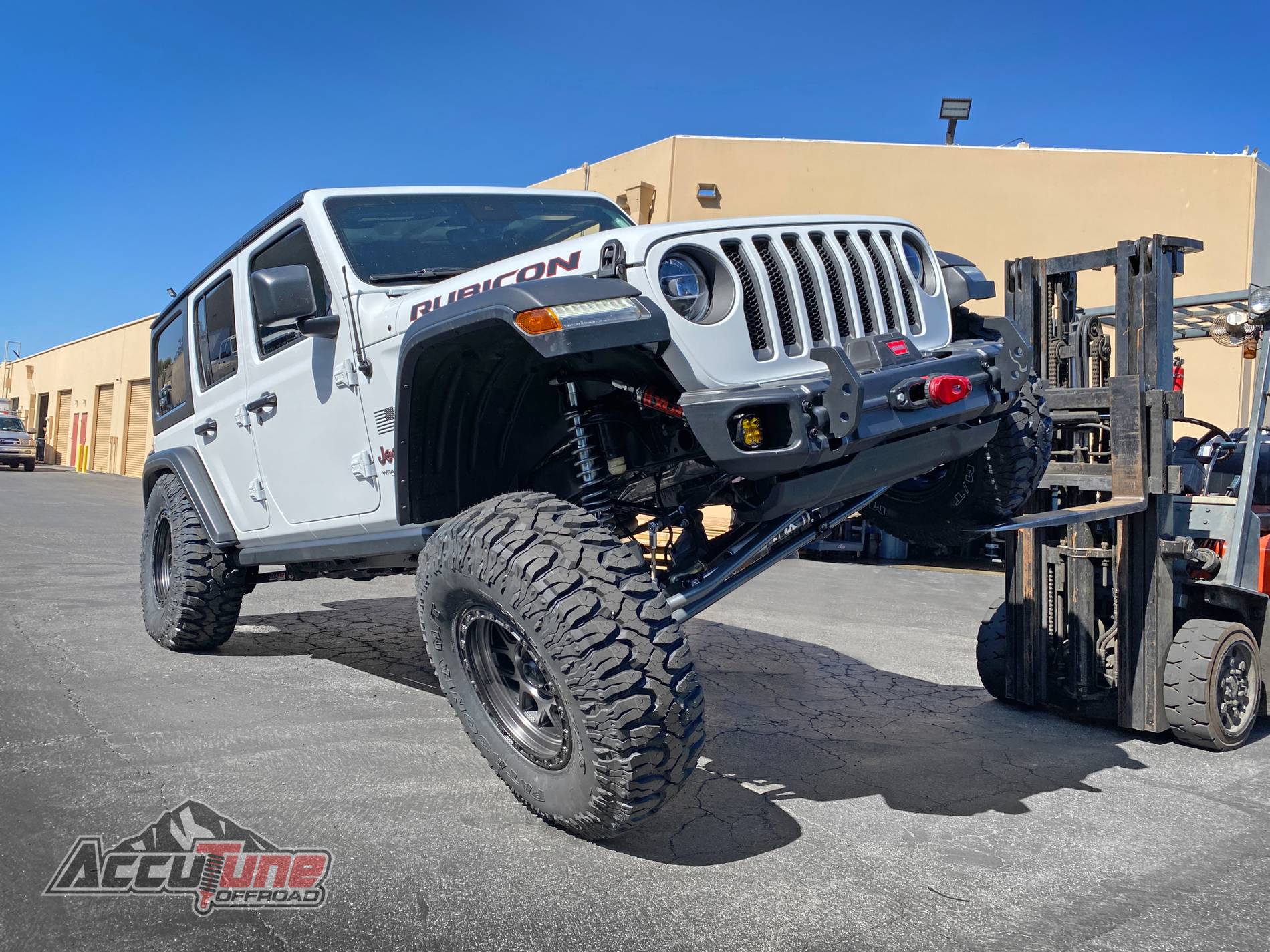

I’m running a similar setup, my long arm brackets came notched already, I think they fixed some of the early design issues, zerk fittings clear with no issue. I’ve had the kit for about 6 mo. now and it’s been great! I think going to a good shop that has experience with this kit is important, I went to All Terrain Garage in Rialto CA and they did an amazing job, they are very familiar with this kit as they install it all the time. I have not had a single problem with it. I was thinking I would need to get the shocks tuned at some point but haven’t seen a need for it, they work well in the desert and kill it in the rocks, very flexy kit.
Nice flex shot. My buddies love driving behind my rig over rocky/rutty crawls bc it looks super cool flexing out while the chassis stays damn near level :)
