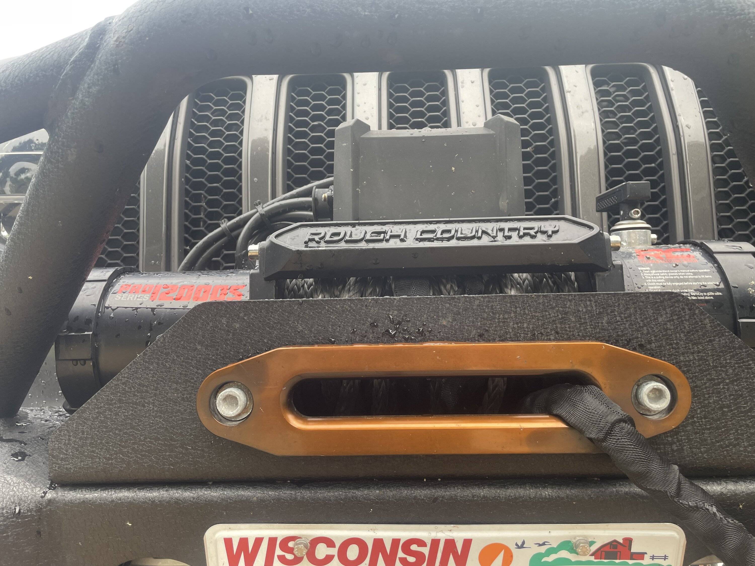

2nd Fairlead, different manufacturer that faded. Just scuff it and paint flat black?

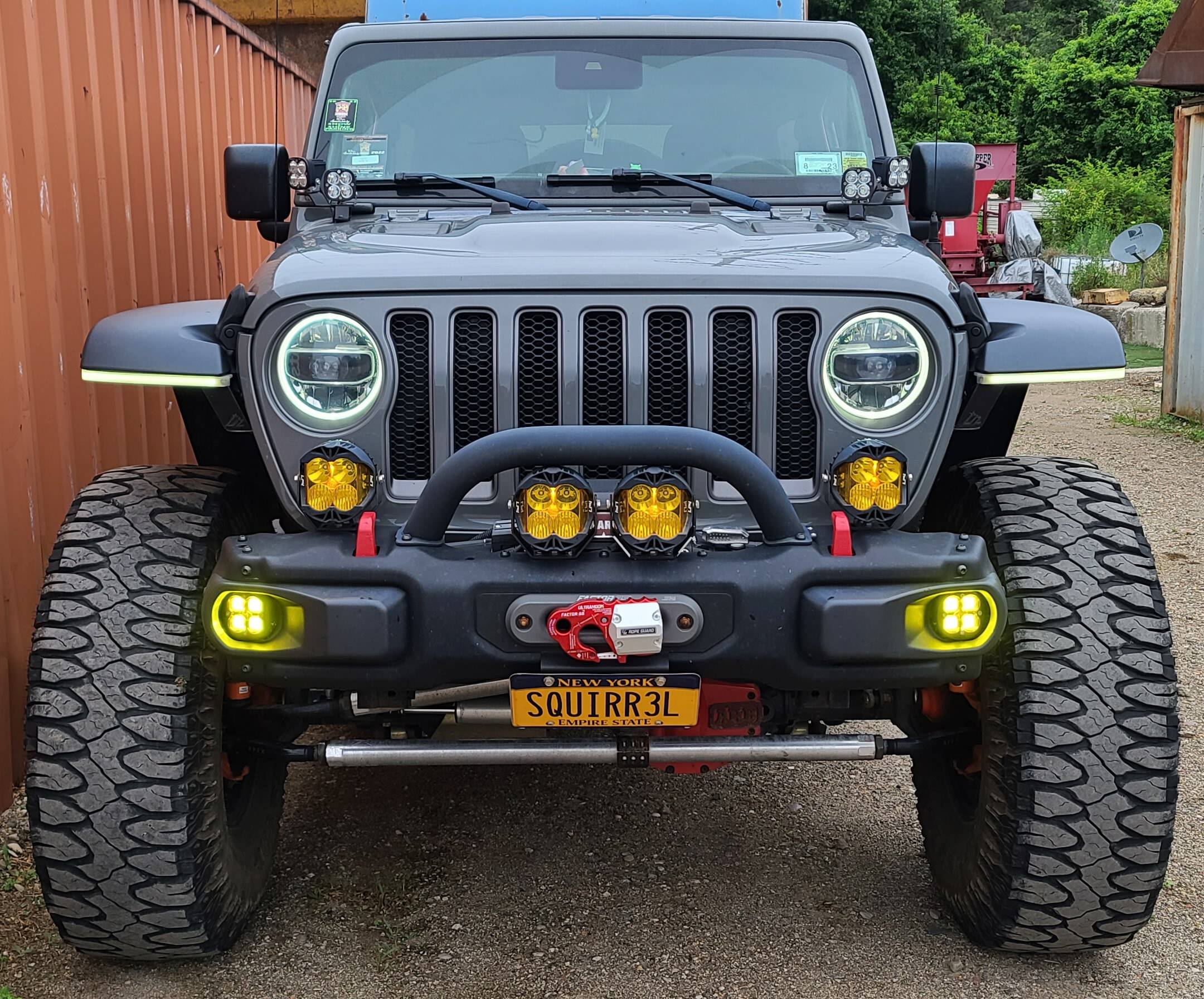

I'd swap it out for a Factor55 fairlead. Here are the reasons why I chose them, taken off their product page...
PRODUCT DESCRIPTION
Factor 55 introduces a new line of Aluminum Hawse Fairleads. The 1.0 and 1.5 fairleads are CNC machined from 1 and 1.5 inch thick USA 6000 series aluminum bar. The industry standard fairlead thickness is .75 inches thick.
The thicker aluminum bar results in a larger outer fillet radius for the synthetic rope to slide against. This results in less stress on the rope fibers during high angular pulls, increasing the life of your synthetic rope. The 1.0 and 1.5 fairleads are the industry’s first Hawse fairleads compatible with larger ½ inch diameter rope tube thimbles.
The rope slot height opening is taller to allow the larger ½” tube thimbles to pass through. There is also a machined outer corner chamfer to reduce rope stress for those than plan on using the winch as a front suspension “suck down” device. These fairleads come in a durable MIL-A-8625F TYPE III gun metal gray hard anodized finish with a laser engraved logo.
What is the best surface finish for Hawse aluminum fairleads? Without a doubt it is a Type III hard anodized coating. Not cosmetic Type II anodized finishes, not powder coated, and not raw or polished aluminum. Why? Because a hard coating can resist the abrasion damage from a dirty/gritty synthetic winch rope rubbing across it. Especially during extreme side pulls where rope fiber stresses are extremely high. A Mil-A-8625 Type III hard anodized finish leaves a .002” thick Al2O3 ceramic coating that is in the top 5 hardest materials known to mankind (See chart under Corundum/Sapphire). Not too far away from diamond hardness actually. Another valuable material property from hard anodized coatings are the low coefficients of friction. Low friction = lower rope heat. Only drawback? Hard anodizing is not offered in typical bright and fancy anodized colors. All Factor 55 fairleads only come in Mil-A-8625 hard gray finishes. Not fancy, but it is the proper finish to extend the life of your synthetic rope.
Link to product page...
https://factor55.com/product/hawse-fairleads/
You could get it reanodized. There are 2types of anodizing, hard and soft. Hard is for something where there is wear and tear. Soft is for something that kind of just sits there. Manufacturer probably did soft as you know, cheaper.

If you want a fancy color, ou can take it a a gun store and have a ceramic coating put on it called Cerakote. But that would cost as much as the Factor 55 that was mentioned above.
