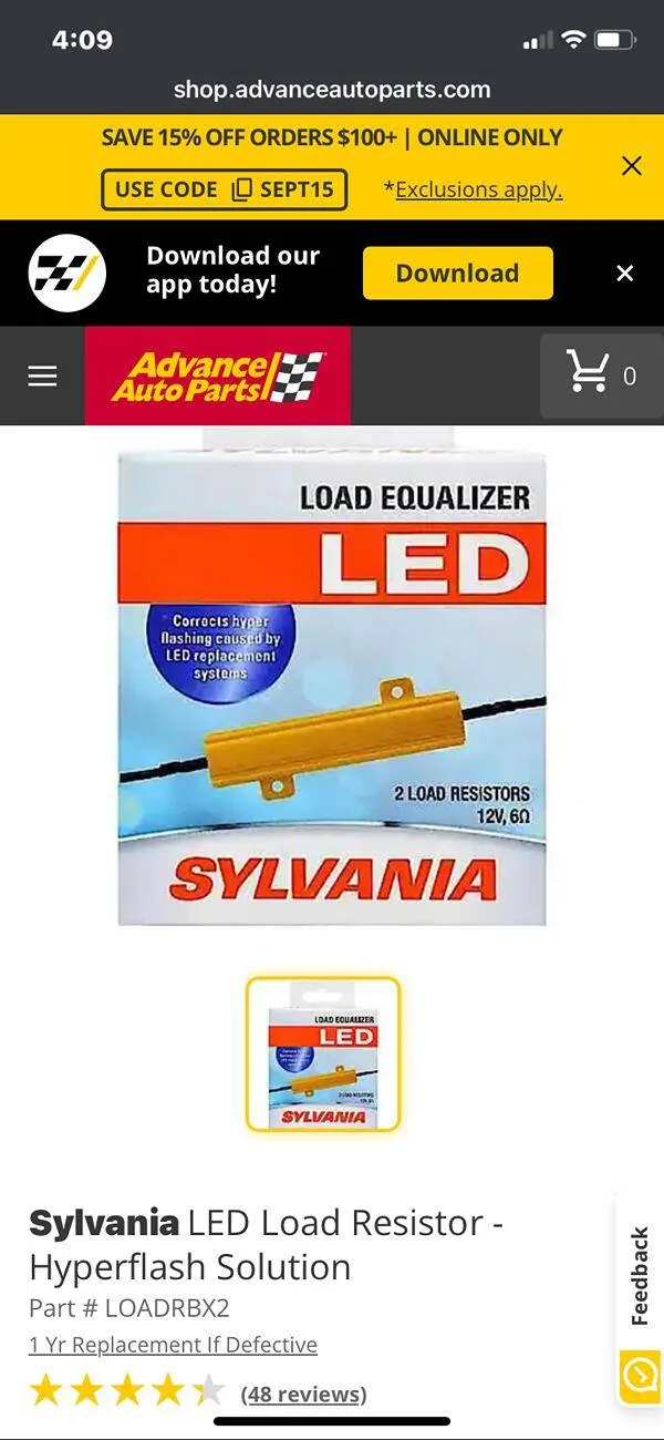

I used these. Super simple. Takes 5 minutes.

Did you splice into the yellow wire? I know the other one has to be the black wire.

This is exactly what I used. I spliced one side into the black wire and the other into the yellow. It worked on my driver side but am still getting the error on my passenger side. The wires in the fenders are really thin and I think the in line splice thing that came with the load equalizer might not have penetrated deep enough to hit the wire. I have metal fender liners so it’s a pain on the ass to get to them but this weekend I’ll take it apart again and try to fix.

easy install did this a couple years ago, the larger black wires one to each side of the load resistor. solder it on and shrink wrap it. make sure you screw it so the back is against metal to help the resistor dissipate heat

Did you put it inline on the black wire only? The instructions for the resistor said to put it between the blinker wire and the ground. I’m still troubleshooting mine and either I did it wrong or the wire crimp didn’t puncture the housing of the really thin wire. Plan on tinkering with it today…

I don’t recommend using the wire t-taps. It’s a bad connection on such a small Wire. If I remember correctly. ( it’s been a couple years since installing them) they plug straight into the old wiring harness connector. And off the new fender side connector was two larger black wires that go to nothing. You connect the load resistor between them. I’ll take a look after church today and get a couple of pictures
