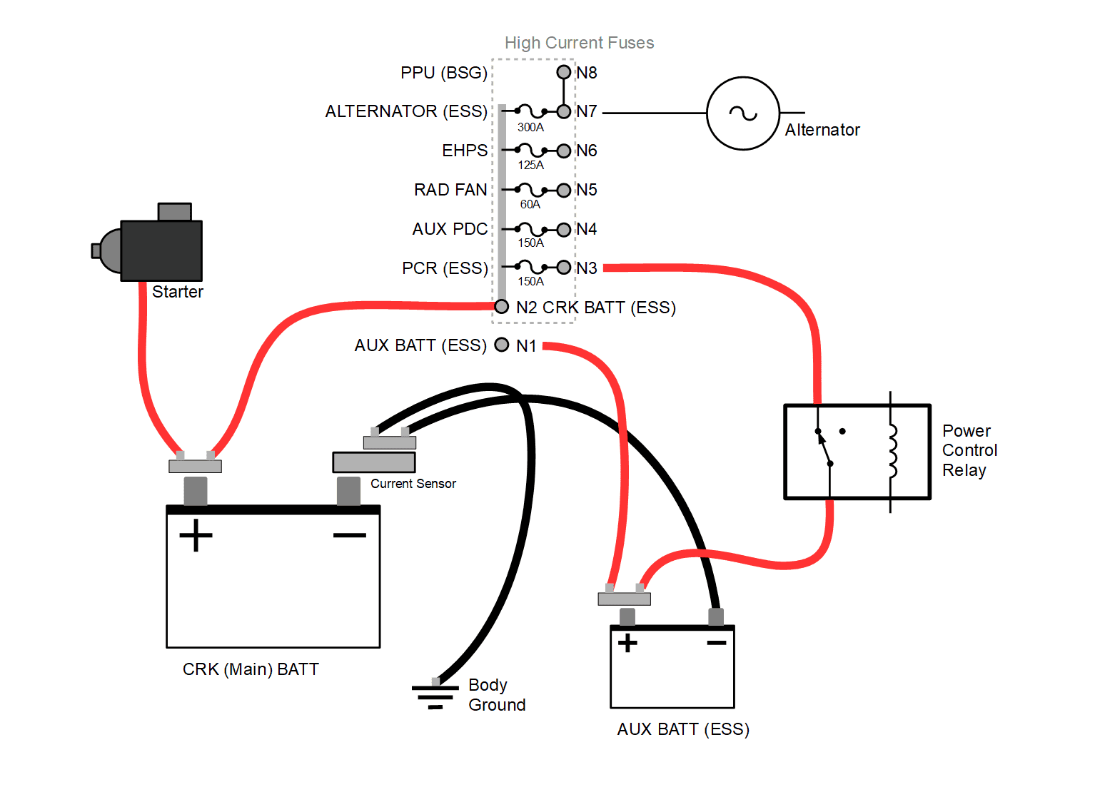

I do not like the idea of heavy battery leads laying unconnected, even if wrapped, and I did not want to leave the old aux battery installed. So I removed the aux negative lead entirely and rerouted the positive back to the main battery lug.
One thing to note:
Connecting the ESS/Aux battery positive cable terminal connector to the main battery positive post bypasses the 150A PCR (ESS) fuse.
I can't say for sure that in the factory configuration the fuse is designed to protect anything other than the cables, PCR and ESS/Aux battery, but it does sit upstream of some system electronics.
I wonder if it's possible to safely attach the ESS/Aux battery positive terminal connector to N1 on the PDC.

...and you'll think that I'm picking on you yet I am legitimately confused.
Doesn't the the ESS/Aux battery positive terminal connector, with its two cables, already--when the PCR is not energized--connect N1 and N3?
I don't think you're picking on me. You'll think I'm picking on you... I wonder why you don't seem to understand the concept of quoting and replying.
Yes, Andy, connecting the loose ESS/Aux positive cable terminal connector along the original path is exactly the point! Instead of connecting it to the main battery terminal and changing the path, which bypasses the N3 fuse.
That wouldn't bypass the fuse though. Connection would go from N3 to the main battery positive.
Attaching the ESS/Aux battery positive battery cable terminal connector to the main battery positive post creates a direct connection between the main battery and N1, bypassing the N3 fuse.
Yes, technically, N3 and the ESS/Aux positive battery cable terminal connector are still physically connected through the PCR. But, current would likely flow through the shorter connection (without the PCR resistance), and if not there'd still be a current path between the main battery and N1 if the N3 fuse blows.
I suppose I should say "creating a bypass" rather than "bypassing"?
N1 and N3 are directly connected at all times under normal operation, except during start stop events. So clearly the fuse on N3 is not protecting any current from the aux battery into any electronic devices.
The N3 fuse would only come into play when the ESS reconnects the two batteries together. At that point power would flow through the N3 fuse into the aux battery to recharge it. Presumably it exists to ensure no more than 150 amps flows through the cables.
If you remove the aux battery, you have no drain on an aux battery during a start stop event, and no current flowing from the main battery system into the aux battery when the batteries are reconnected. Thus it does not matter that nothing flows through the N3 fuse; there is no longer any different potential for current to flow, nor need for the fuse. Am I missing something? That's how I read the diagram.
Yes, technically, N3 and the ESS/Aux positive battery cable terminal connector are still physically connected. But, current would likely flow through the shorter connection, and if not there'd still be a current path between the main battery and N1 if the N3 fuse blows.
I see what you mean, but I disagree. The devices powered by the aux battery off of N1 must have their own fuses downstream because under the stock setup, there's a direct connection from aux positive to N1. No fuse.
So attaching N1 to the main battery, versus the aux, isn't eliminating any protection. There was already no fuse there.
I think you're ignoring that the main battery is on the left side of the N3 fuse to begin with. That's how the aux battery is recharged. When the relay closes, current flows from the main battery through the N3 fuse and into the aux battery. The only thing the N3 fuse can be protecting is that current flowing between the two batteries, not current to any devices. When you remove the aux battery, there's no need for N3 anymore.
True, but the ESS battery is ~200 CCA compared to 800 CCA of the main. So bypassing the N3 fuse might have some implication for those electronics. That's the part I don't know.
I agree with you. I just don't know for sure about any downstream fuse protection. So why not retain the factory connections? That is, what's the advantage in taking the risk of connecting the ESS/Aux positive battery cable terminal connector to the main battery positive post?
