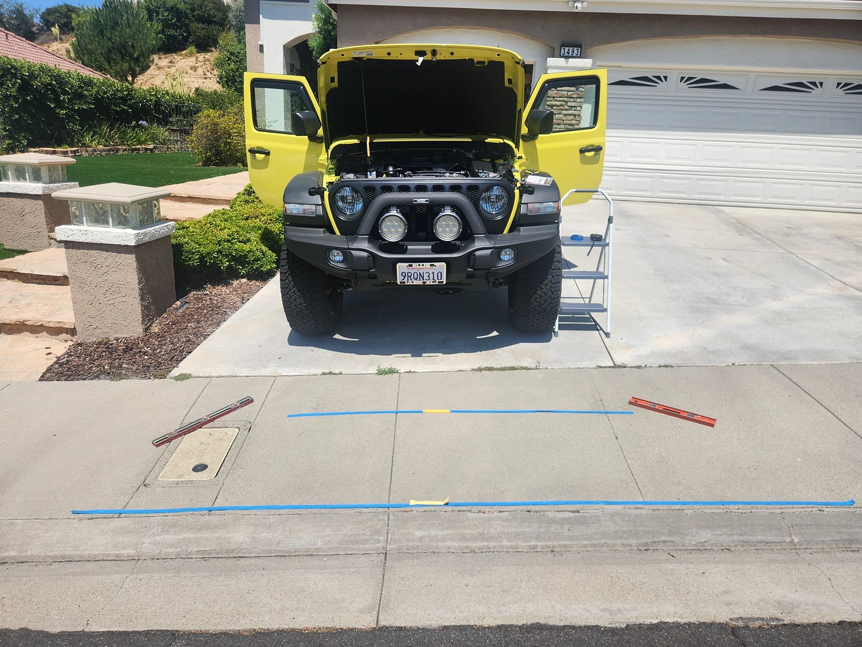

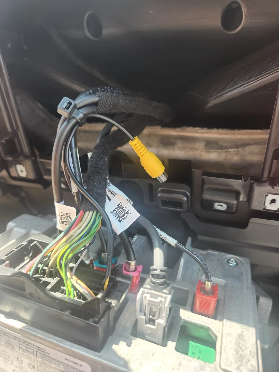

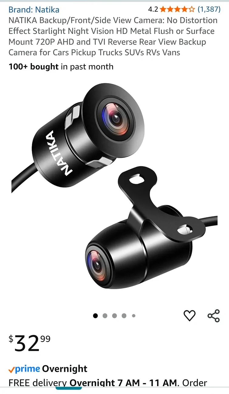

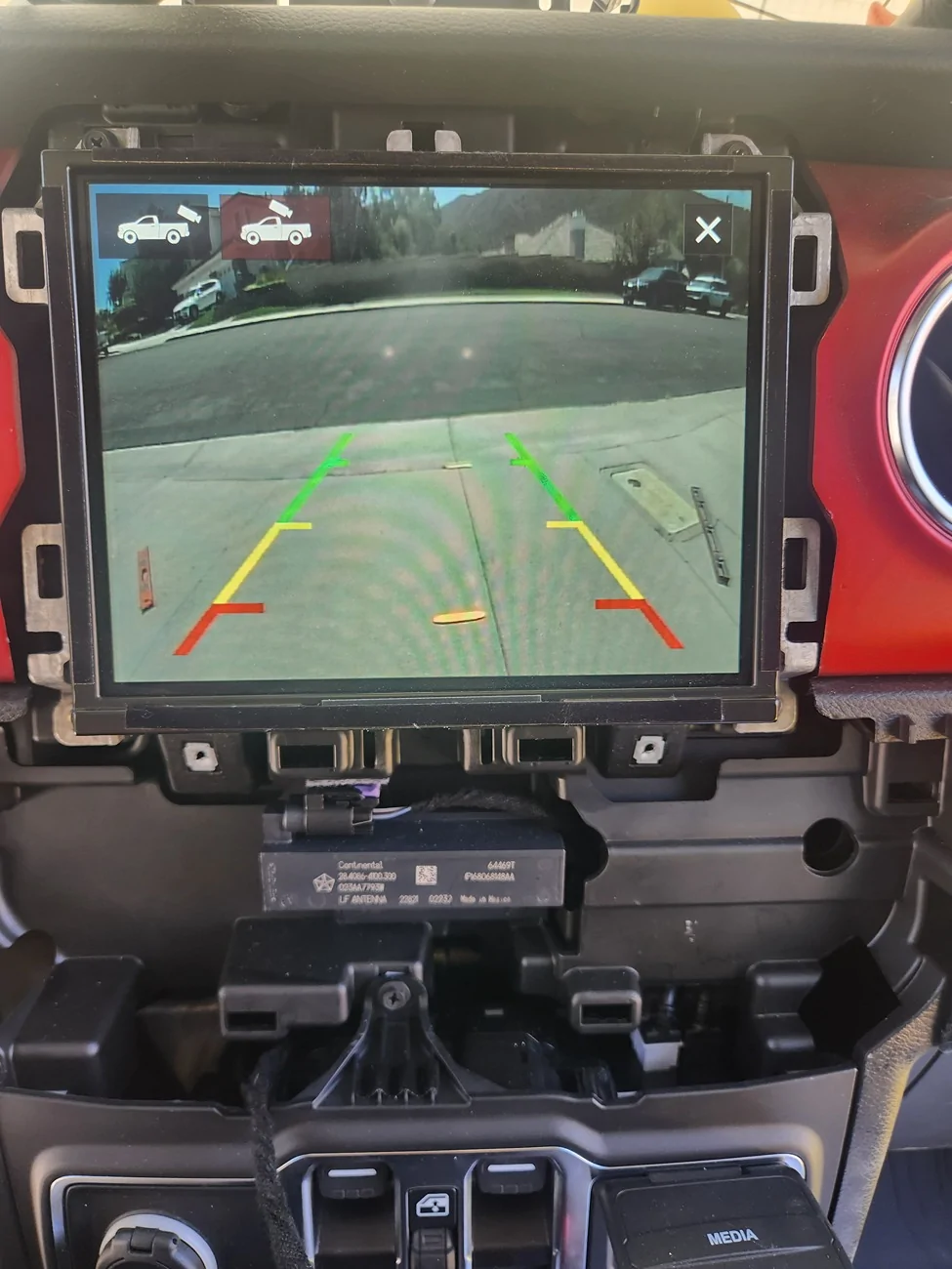

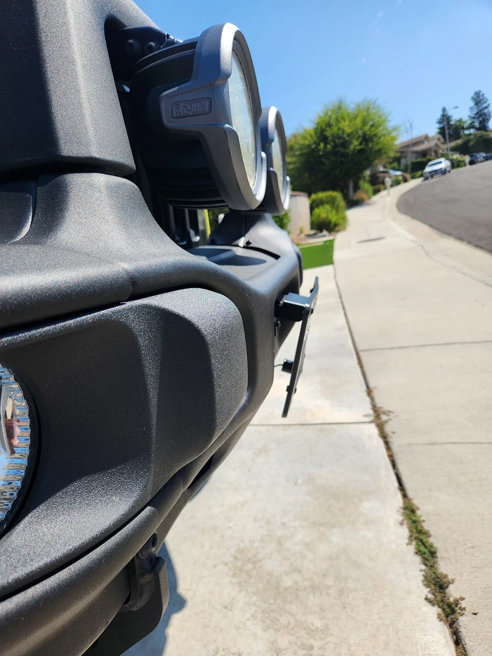

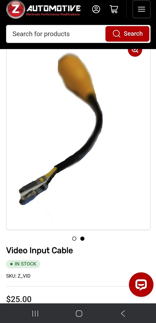

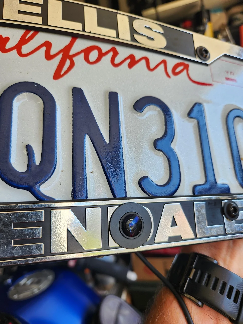

I just added a front camera on my 2023 JL w/8.4 radio. Camera from Amazon was $33 w/cable. Video cable that plugs into radio was $25 from Zautomotive. They also have step by step instructions on the install. I mounted the camera at the bottom of the license plate frame. I can tilt the bracket holding the plate. I powered the unit from a cable splitter below the radio. Used my Tazar mini to enable the "Cargo" camera input of the radio.
