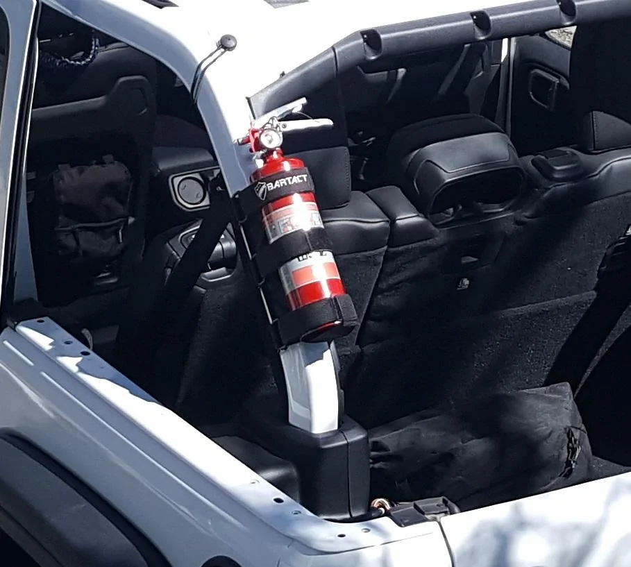

Installed the H3R-MX250B extinguisher on the H3R-NB300 quick release mount. Worked perfectly on that flat trim panel between the rollbar and the side window on the hard top. It’s accessible from both the back seat, and the tailgate area:

Since I had taken this trim piece off previously, I knew there was a flat piece of sheet metal underneath it - with plenty of empty space below that. So, here are the steps:
  1. Mount the extinguisher to the “holder” portion of the mount.
  2. With extinguisher on the mount, place the mount where you want it, so it is straight, allows for access to the release pin, and allows you to catch 6 of the 8 holes in the mount (the mount is longer than the piece of flat trim, so you will not use two of the 8 holes).
  3. Once in place, carefully pull the release pin, and remove the extinguisher from the mount - while not moving the mount. Mark the plastic for one of the mounting holes with an awl.
  4. Remove mount and use a small drill to make a pilot hole at your mark in the plastic (drill bit should be real small - smaller than 1/8”). Only two of your 6 holes will drill into the sheet metal below. The other 4 are only making pilot holes in the plastic.
  5. You’ll need 6 (six) black, 1/8” sheet metal screws to hold it down. I can’t remember the length of the screws that I used - maybe 1/2”? They just need to be long enough to catch the sheet metal on those two points.
  6. After catching the first screw only hand tight, realign the mount so it is straight. Then place the extinguisher back in the mount, double checking that you can still access the release pin. Once confirmed, carefully remove the extinguisher without moving the base mount.
  7. Drill remaining 5 pilot holes, and install the remaining 5 sheet metal screws. Just remember that 4 of the 6 mounting points are only into plastic, so only tighten those screws until they bite into the plastic.
  8. Crack open a beer to celebrate your installation. Maybe set something on fire in your garage - ya know, just for a test ;-)

Thanks for taking the time to write this up, I was curious how far you were going into the sheet metal. I've already ordered the tank, and holder you've listed. Much appreciated!
