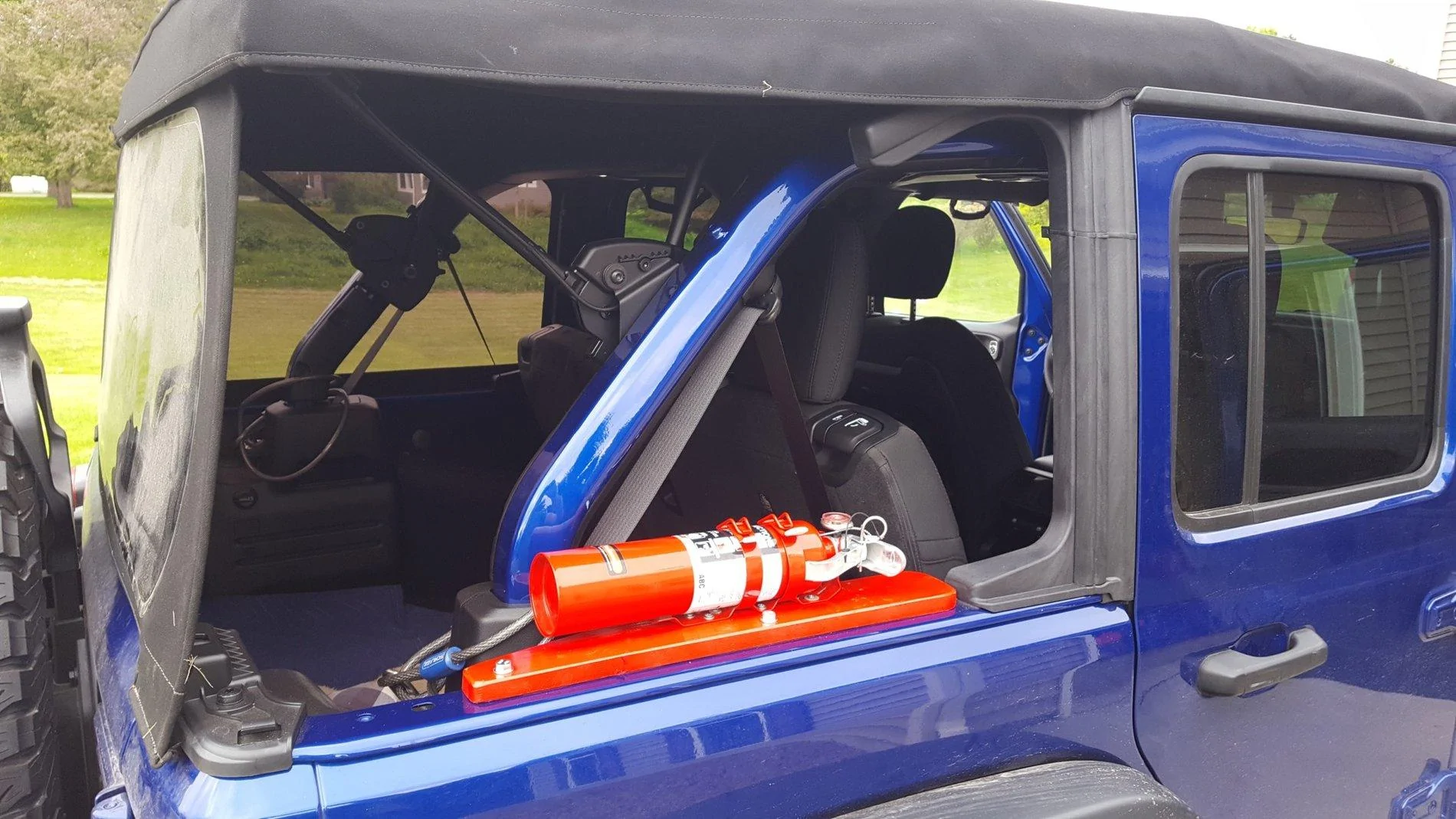

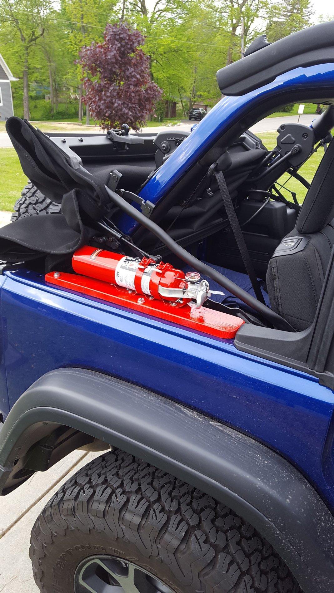

Today I mounted my extinguisher using the threaded holes for the hard top. It just fits. I used wood as the mount as I do not have access to metal working. Only works with the soft top. I had to move it rearward to clear the soft top mechanism. I’m not saying this is a good solution, I may or may not keep it installed. Jeep Wrangler JL Fire Extinguisher etc for JLU E90B6EC1-63BB-43F9-8BA8-B0E8D284DB94

I’d encourage you to reconsider your mounting location. If you need it in a hurry, the very back of the Jeep usually isn’t ideal

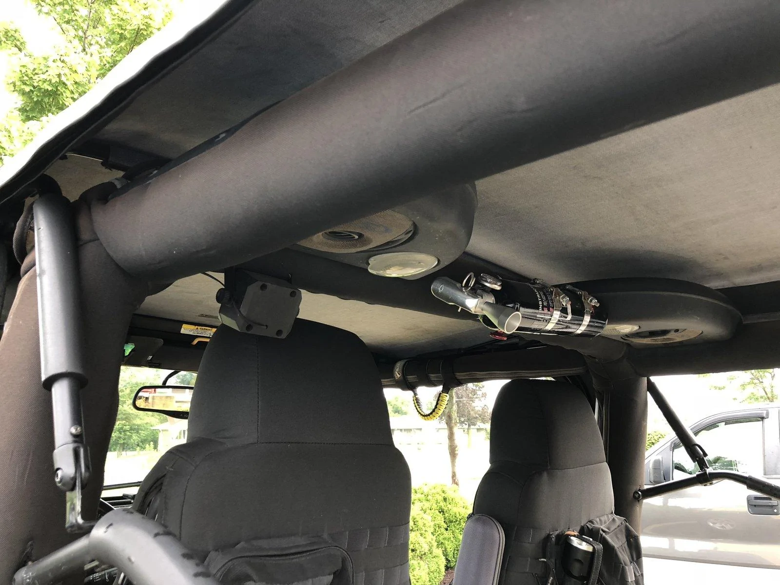

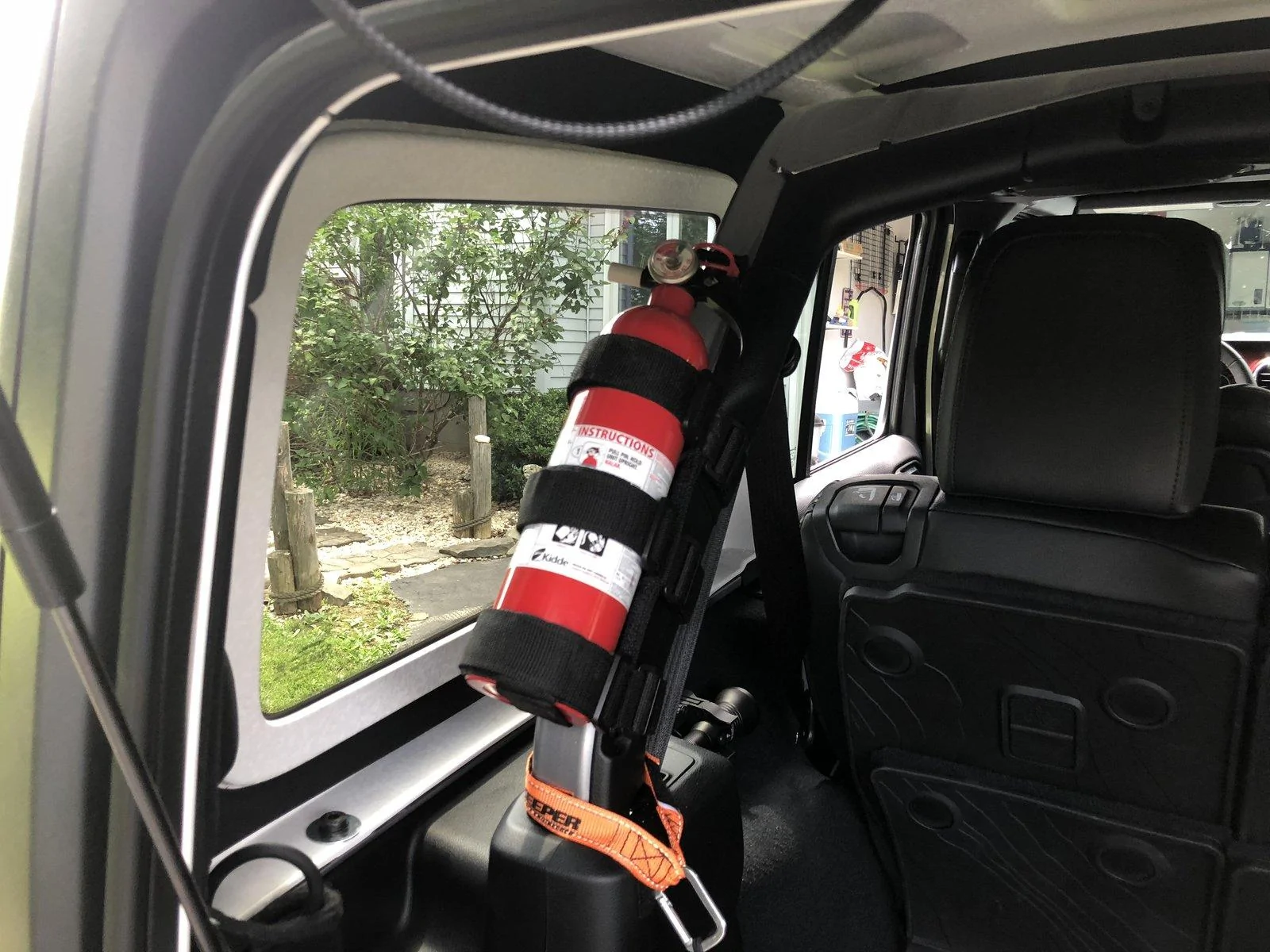

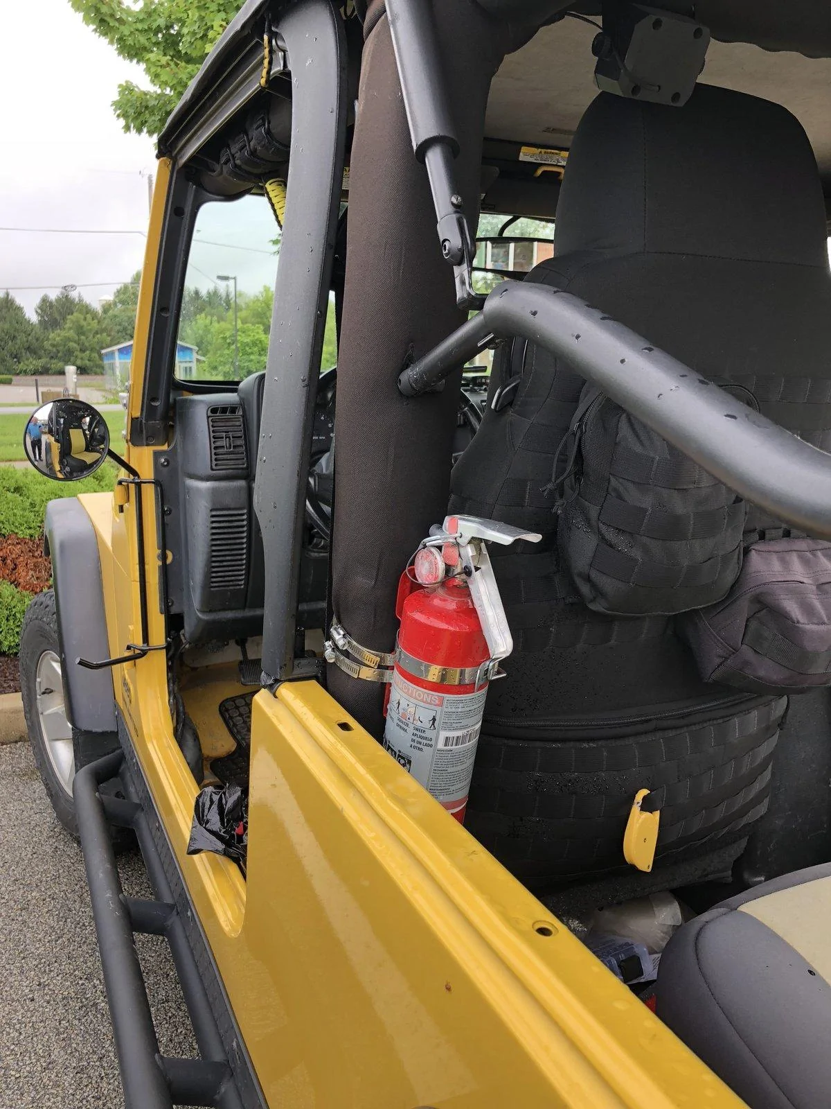

Sure. I assume the JL rollcage is sufficiently different that my setup would require some tweaking (the bars aren't round any more, are they?), but I keep one above and one to the side.

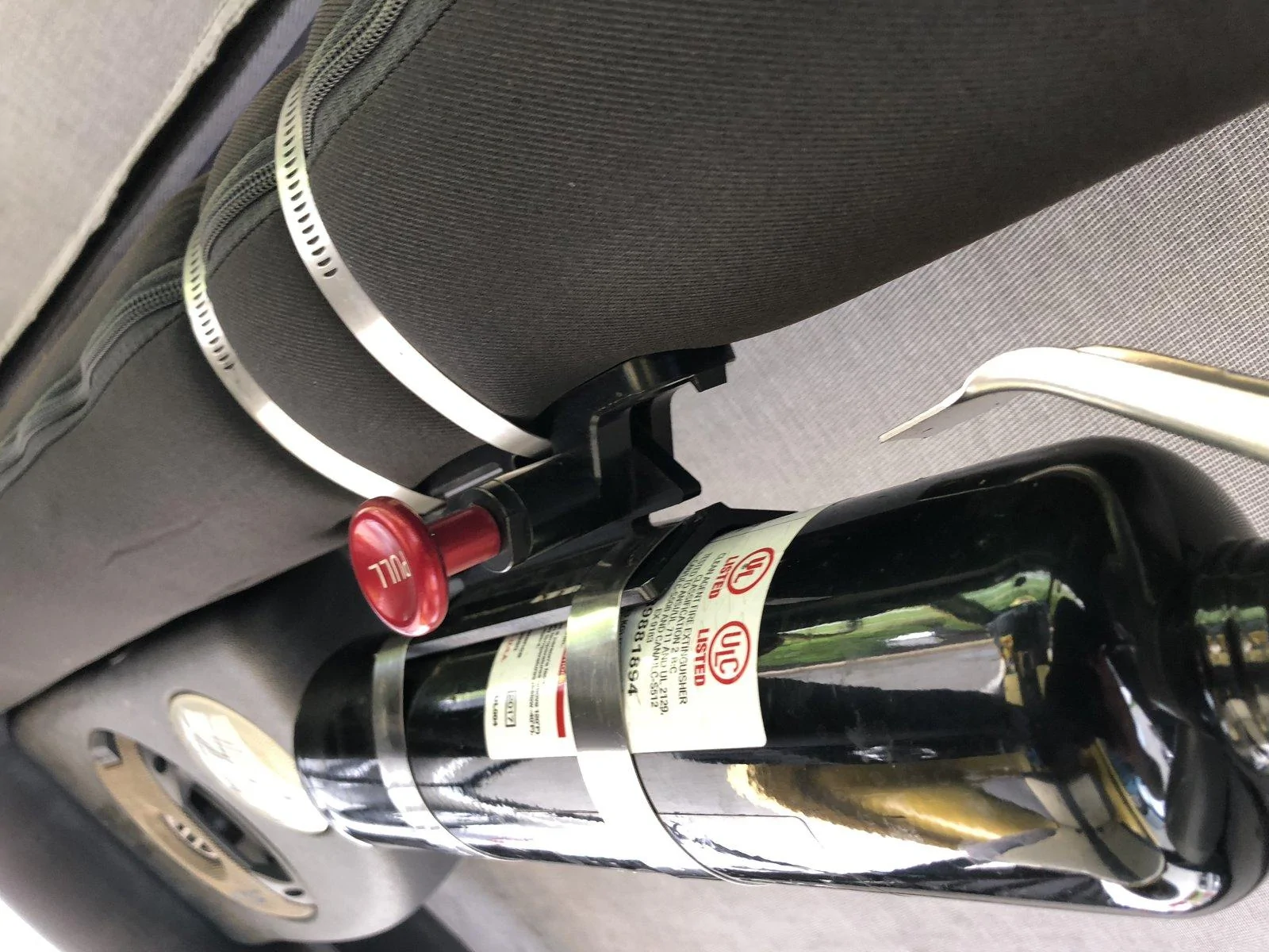

Here's the halon that I keep for use if my Jeep catches on fire. It has a quick release from Drake (https://www.amazon.com/Drake-Off-Road-FIREX-MNT-DOR-Extinguisher/dp/B006VFR2LS), although I use hose clamps instead of the attachments that came with it.

Up close:
Jeep Wrangler JL Fire Extinguisher etc for JLU IMG_0718
For the cheaper one to my left, I just use the mount that came with it, again with hose clamps to keep it in place.
Jeep Wrangler JL Fire Extinguisher etc for JLU IMG_0716
Closer:
I used some sort of putty, don't remember what, to try to keep the release pin from rattling. There are undoubtedly more car-friendly release mechanisms available.
I've also seen quality mounts for directly in front of the front seat, behind your legs. Seems like a reasonable option, but whatever you do, make sure it's secure. Not the kind of object you want flying around in an accident.
