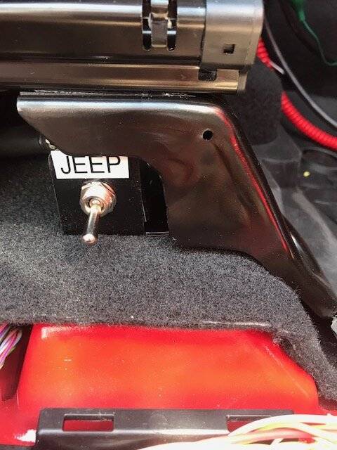

Sure! The installation will be in the same location our tow harness wiring installs - under the front passenger side door sill. The switch will locate under the passenger facing outward - but protected by the seat. The switch will be labeled - in contrast to the pic, the down-toggle position will be normal "JEEP" mode, and the up position will be "TOW" mode.
There is a small misunderstanding. I have a CoolTech harness installed and it works fine except for the LED battery drain. I am asking where the "magical solution" installs in relation to the existing harness.
Sorry, no misunderstanding. It installs in the same place. PM me and I can get you a kit sent out.
