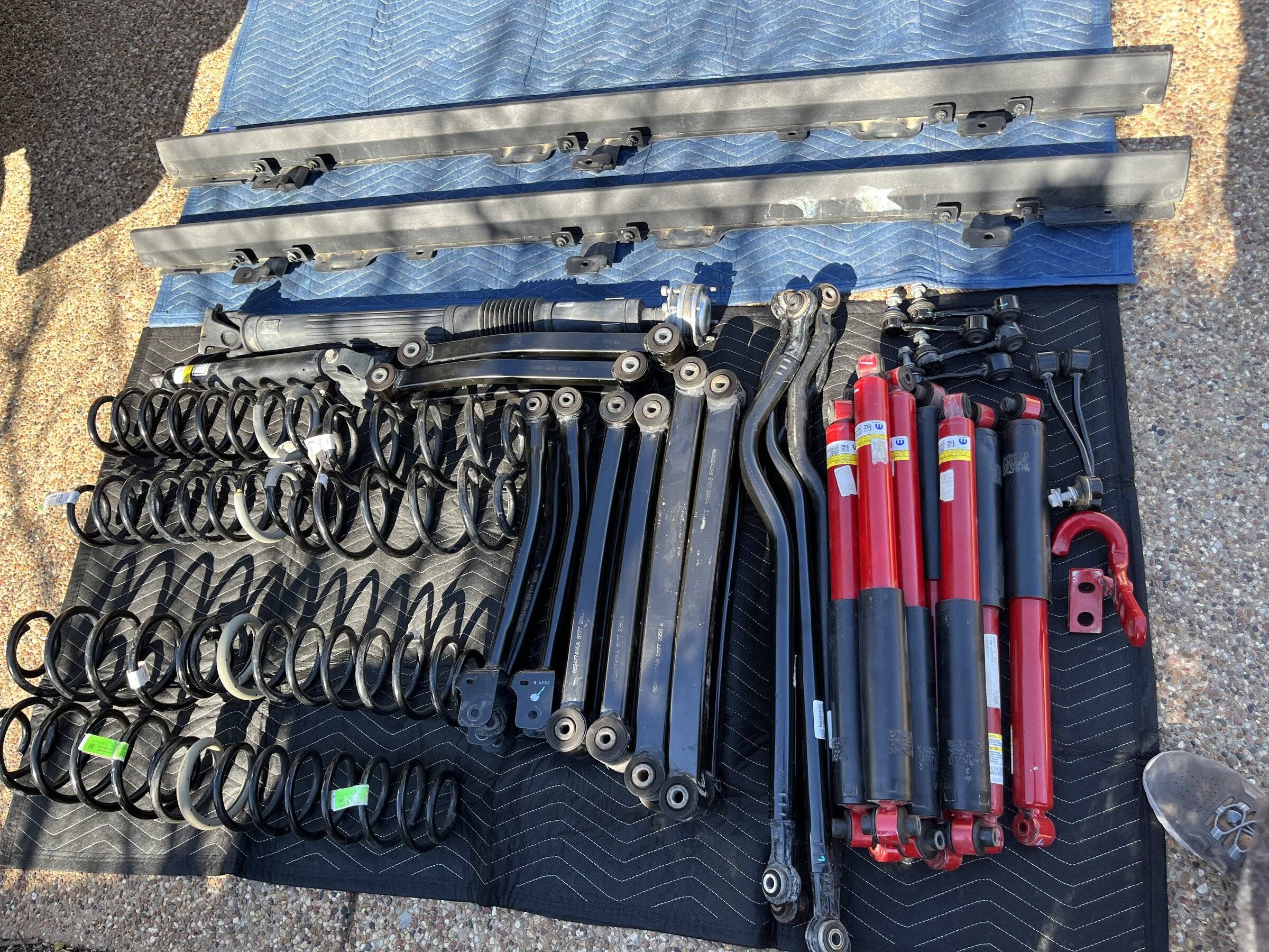

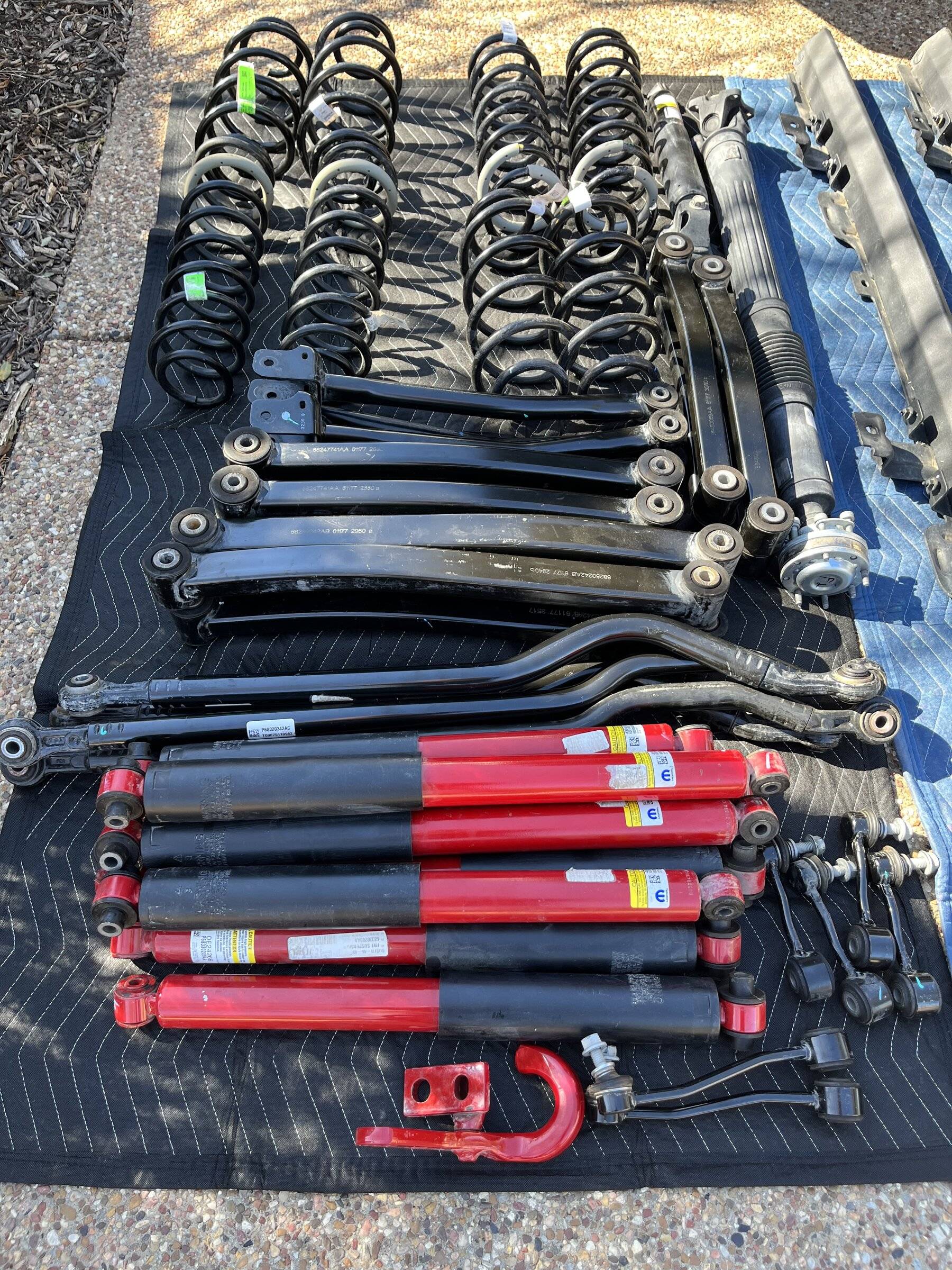

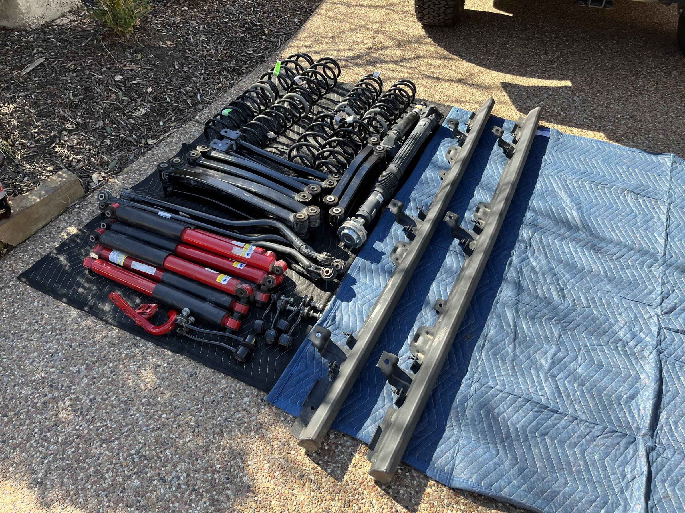

Front shocks are definitely shorter than the rears. Here's pictures from a recent road trip to pickup two sets of Rubicon take offs for reference...
