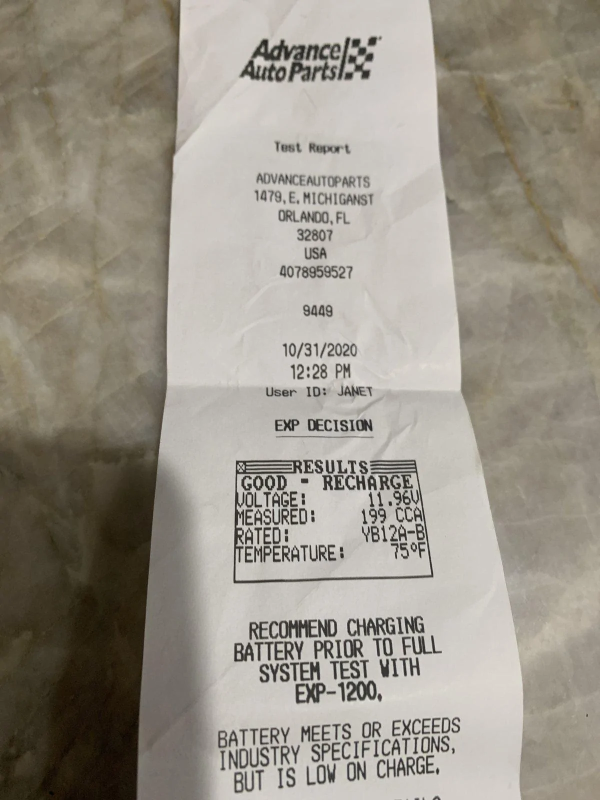

Kuwait! I lived there for a year and had some good times. I remember the grand opening of the Ruby Tuesday in 03. I was also a regular at the Sushi place at the Crowne Plaza. Good people - I’d definitely go back.I had this issue at around the same mileage as you, the dealership replaced both batteries and something called "z fuse array" (Pictures Below) Mopar part number also pictured below, ask them to specifically check this thing. this part is located on the side of the fuse box with around five wires going on top of it.
my issue was very similar to yours, jeep just wouldn't start, after multiple tries it did and then the whole dash lit up with all sorts of warnings.
Dealership told me this is a known issue and that it is the main reason why the smaller battery dies.
