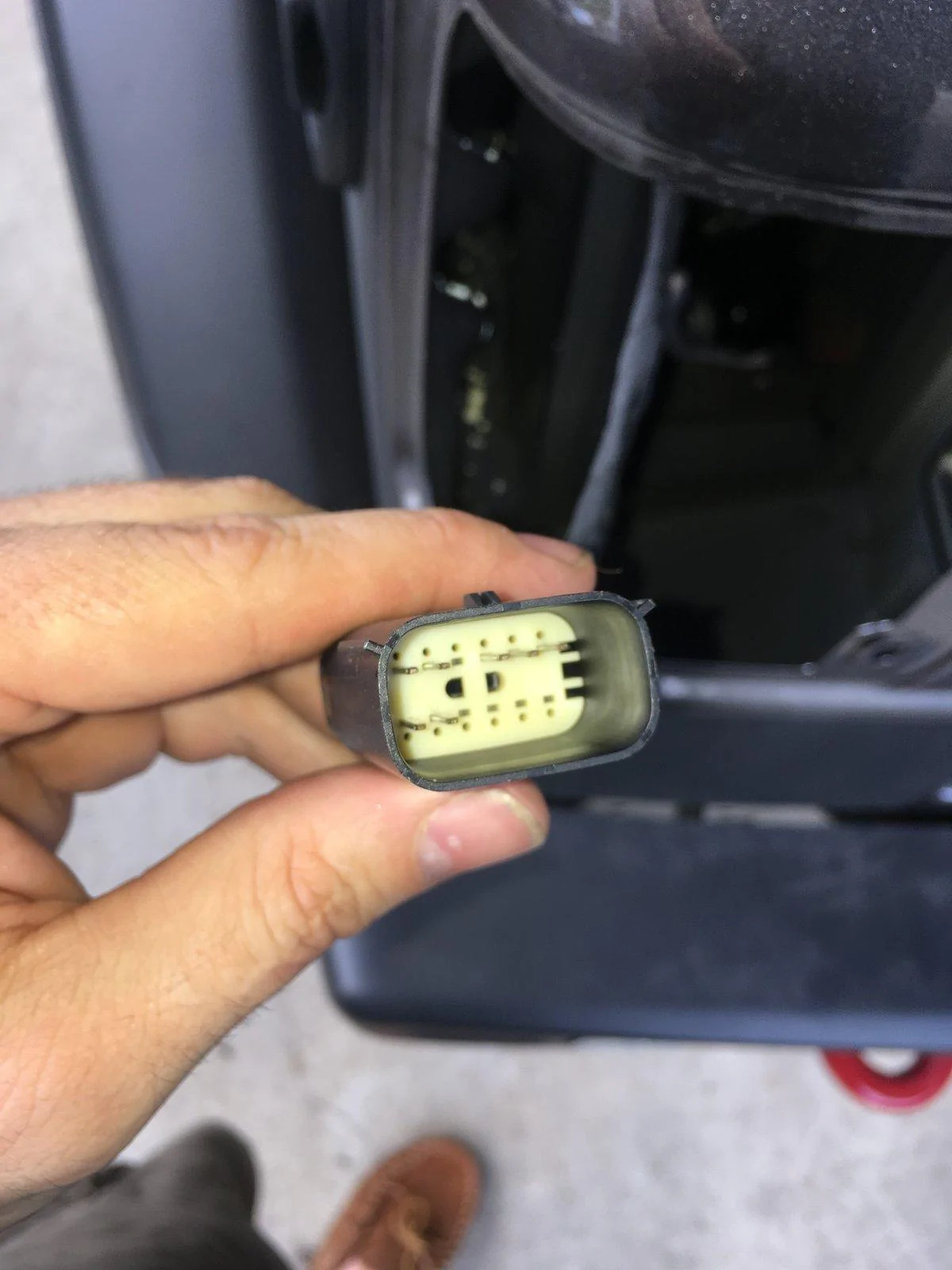

I believe I have already confirmed that the JL headlight and fog lights plugs are the same as the JK. I’ll know for sure tomorrow when a part I ordered comes in.
Does anyone know if the taillight plugs are the same on the JL as the JK?
I would like to modify a cheaper 4 pin trailer harness to non permenantly wire in some backup cube lights and really don’t want to have to buy the mopar trailer wiring harness. If I could find out the exact plugs and a place to order them I could also make the whole thing from scratch.

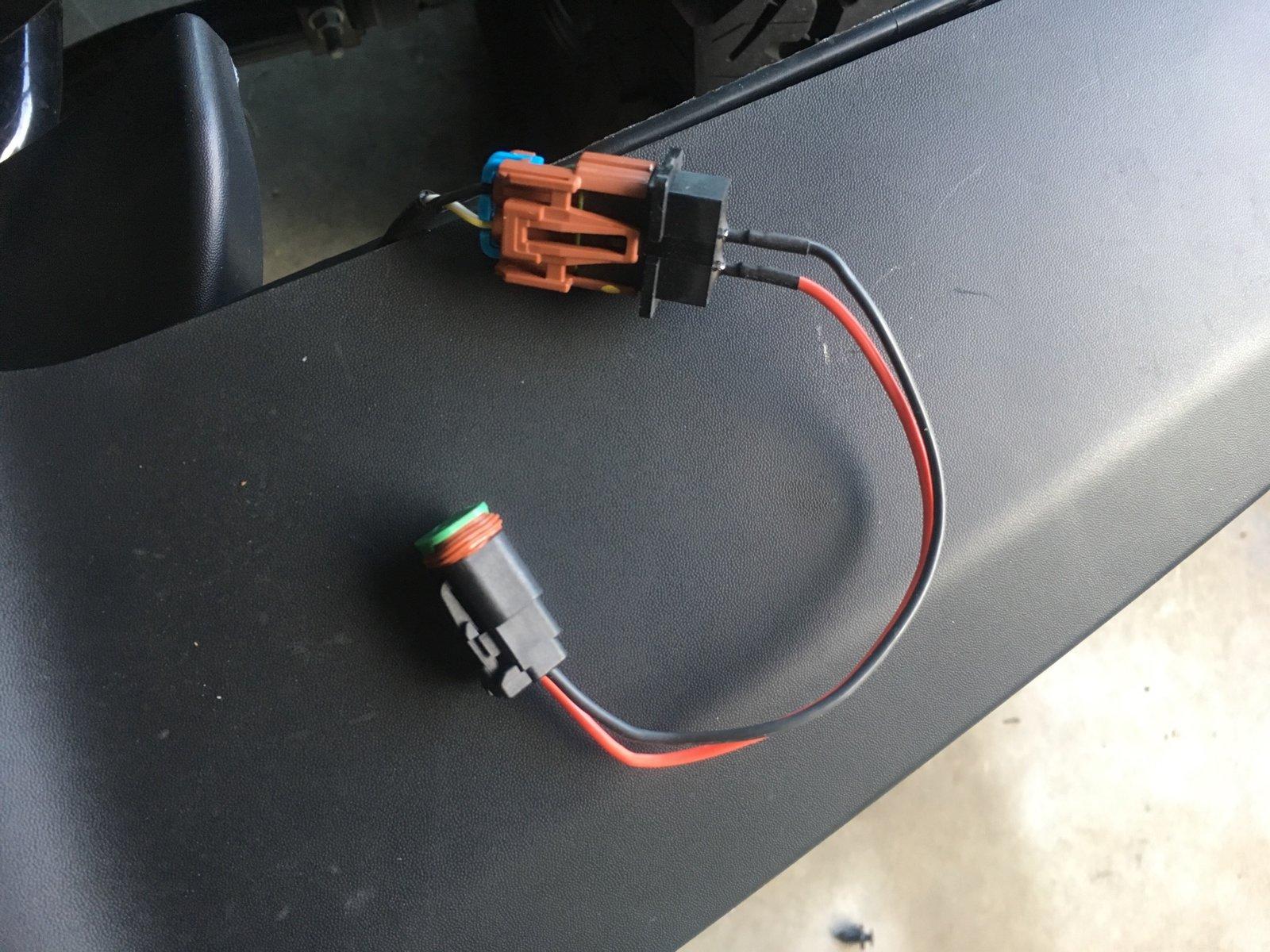

I confirmed that the fog light plugs are the same on the 2010-2018 Jk as the JL. These fog light plug to deutch connector adapters are for a 10-18 Jk.
Jeep Wrangler JL JL taillight plug A4F9DCE1-575B-48AF-94EB-C21F37D11D67

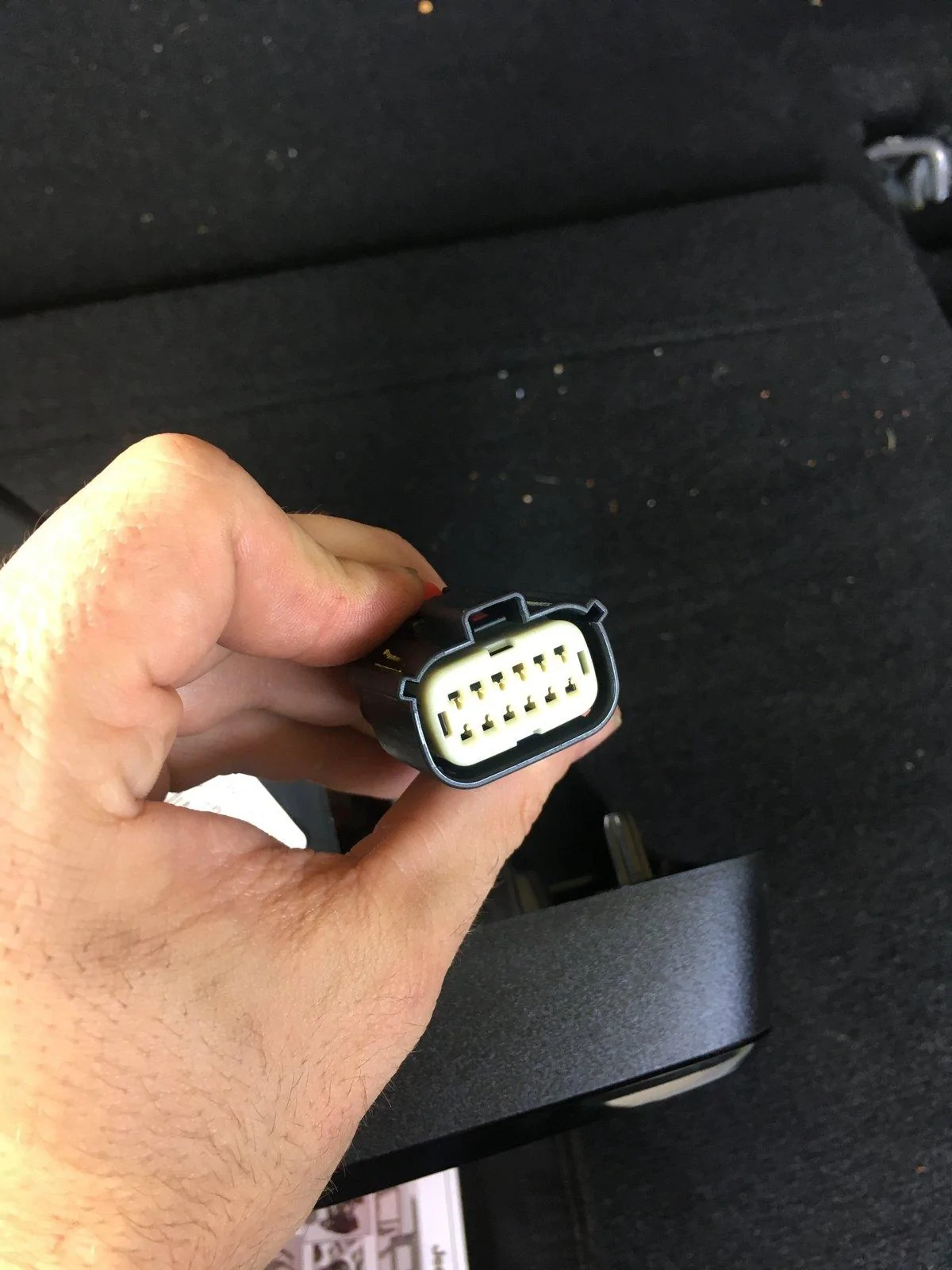

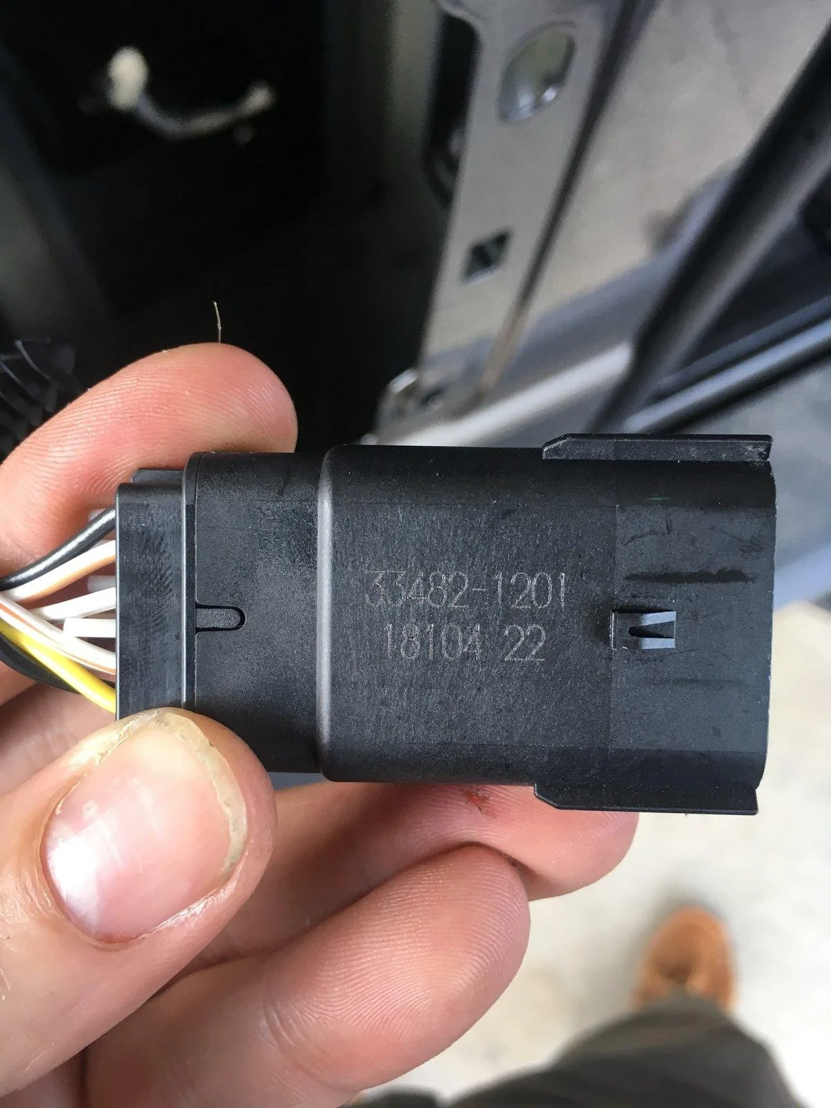

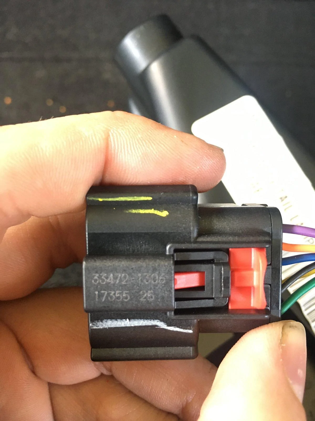

An update for anyone who may want to do this in the future. The taillight plugs are not the same on the JL as the JK. I took the taillight out and got the part numbers off the plugs and have ordered them along with the pins and wire. Total cost for parts is about $20.

Where did you order from? Amazon seems a bit sketchy on details for this using the part numbers in your photos. A link would be fantastic if you still have that level of detail. I’d love to build my own harness which is quickly reversible

I ordered from mouser electronics. Ordering about twice the amount of parts I needed in case I broke or lost something was a hair under $25 shipped. Here’s the links.
https://www.mouser.com/ProductDetail/538-33482-1201
https://www.mouser.com/ProductDetail/538-33472-1306
https://www.mouser.com/ProductDetail/538-33011-3003
https://www.mouser.com/ProductDetail/538-33012-2001-LP
I did all this before any trailer harnesses came out. I have since got a 4 pin harness from Curt that also plugs inline. If you plan to ever hail a trailer I’d just order one of those and then splice it for backup lights since the harness has plugs for both taillights and all the relays required.
With backup lights or a trailer you will have to pull another power wire from the front of the Jeep. Either coming off an extra fuse or straight off the battery with an inline fuse near the battery. I wouldn’t trust the taillight wires themselves to provide enough power for cube lights or trailer lights.

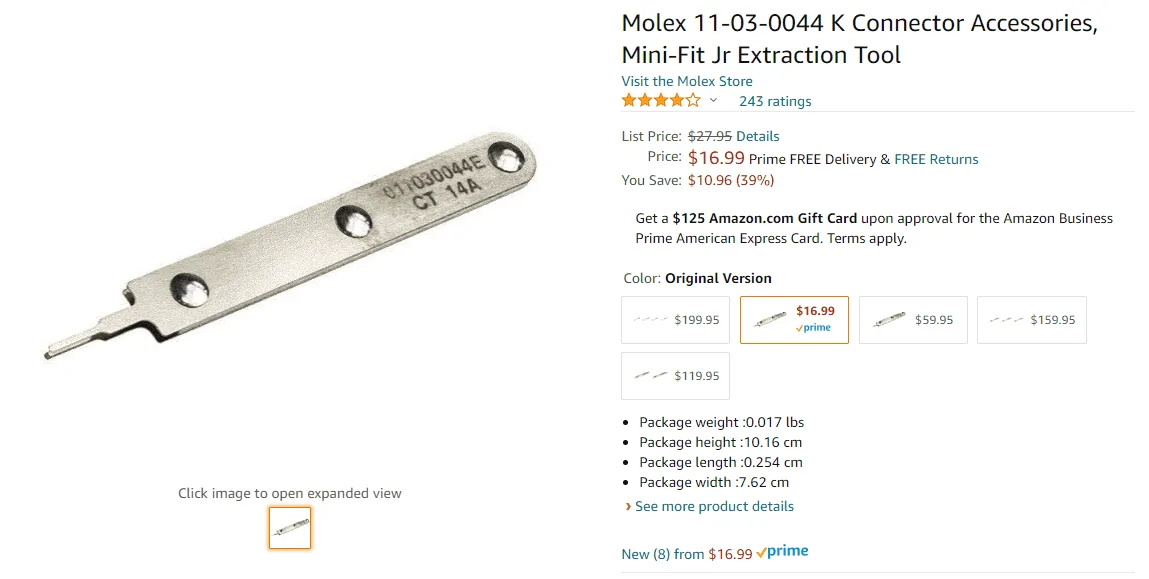

Is assembling these connectors straight forward, any tips or tricks? Thinking about making some JL flat towing harnesses with these....
Abramovich
Jul 12, 2020
442
657
Arizona
2021 Sport S (Chief) and 2022 Willys XR (Gobi) ord

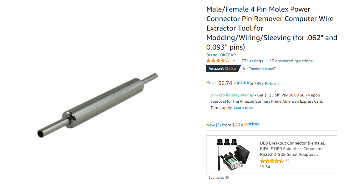

Do yourself a favor and buy the tools made to assemble and dissassemble Molex connector pins.

Is that 1st tool going to work for me? Seems like the 2nd one is more expensive and specified for different pins. Maybe I was just looking at things wrong....

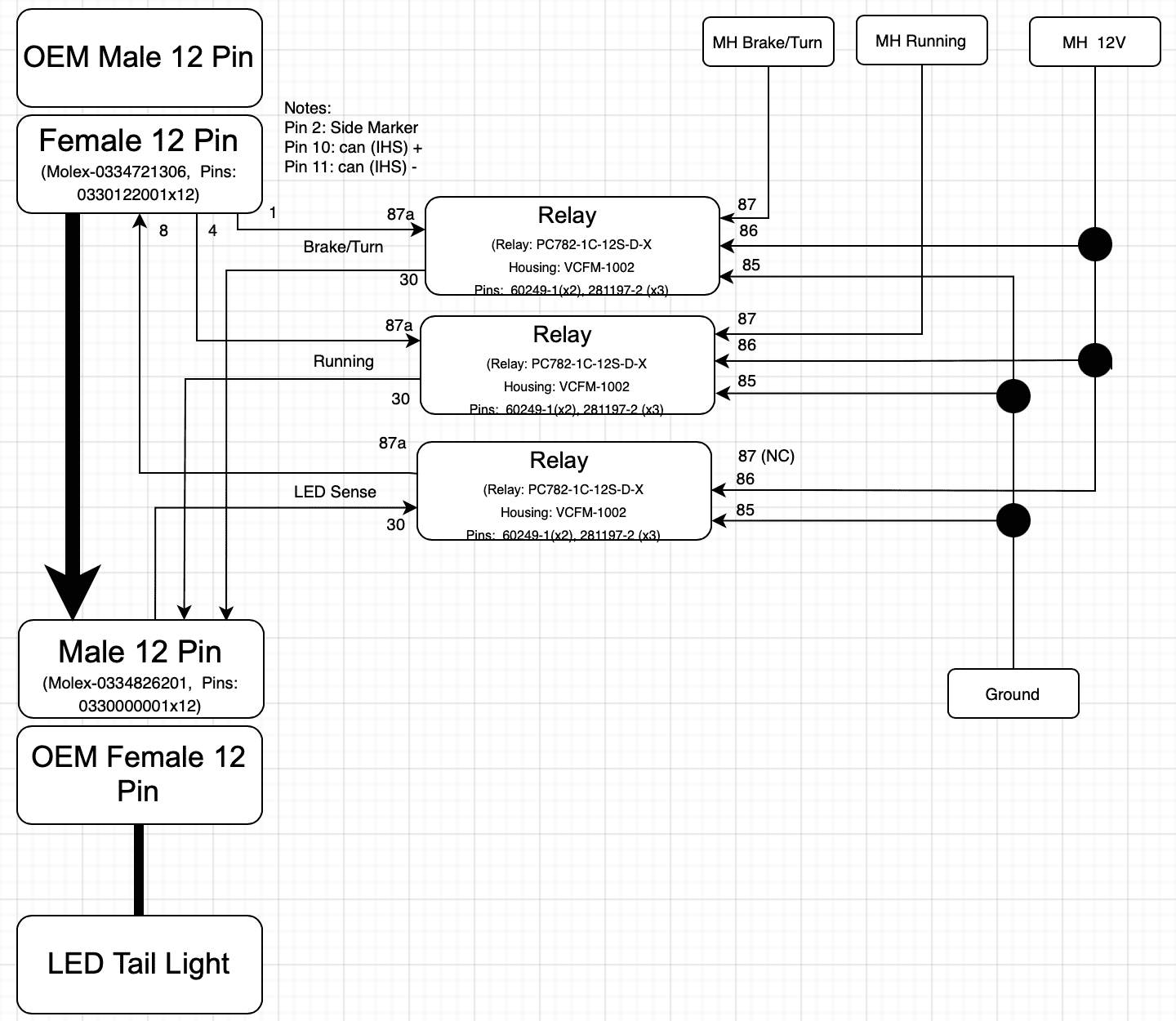

Here's what I think is a parts list for rolling your own tail light wiring harness. The game plan is to make a harness that automatically switch the tail lights out using standard relays. These parts, plus the wires are all that's needed in the tail light, then there would be a 12v,Ground, Left/Brake,Right/Brake, Running lights going to the front.
It would be cool to add the rear license plate light if anyone can give some info on that connector...
Code:
Manufacturer Part Number    Description
334826201                   CONN PLUG ASST 12POS DUAL BLACK   (Tail Light Male need 2)
334721306                   CONN RCPT HSG 12POS 3.50MM        (Tail Light Female - need 2 )
330000001                   CONN PIN 14AWG CRIMP TIN          (Pins - Male - need 24)
330122001                   CONN SOCKET 14-16AWG CRIMP TIN    (Pins - Female - need 24)
PC782-1C-12S-D-X            30A SPDT MICRO ISO RELAY 12V DIO  (Relay - Use Motorhome 12v to switch lights  - depends on how things are wired - need at least 3, probably 4, maybe 6 or 7 if addressing license plate light and LED "signal" wires)
60249-1                     CONN QC RCPT 12-16AWG 0.250       (Relay pins - large - 2 per socket)
281197-2                    CONN QC RCPT 13-17AWG 0.187       (Relay Pins - small - 2 per socket)
6-1904045-5                 V23333Z1001B045-EV-441            (Relay Socket - same as # relays)
ekim
Aug 15, 2020
111
83
NJ
2000 TJ
Here's a first pass at a diagram with parts. Anyone interested in seeing if there are any mistakes or want to tell me why it won't work?
