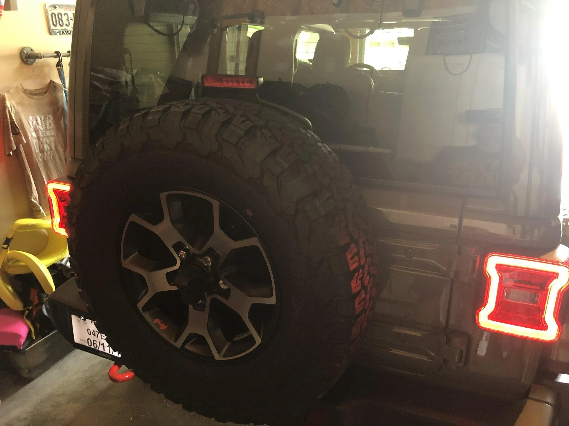

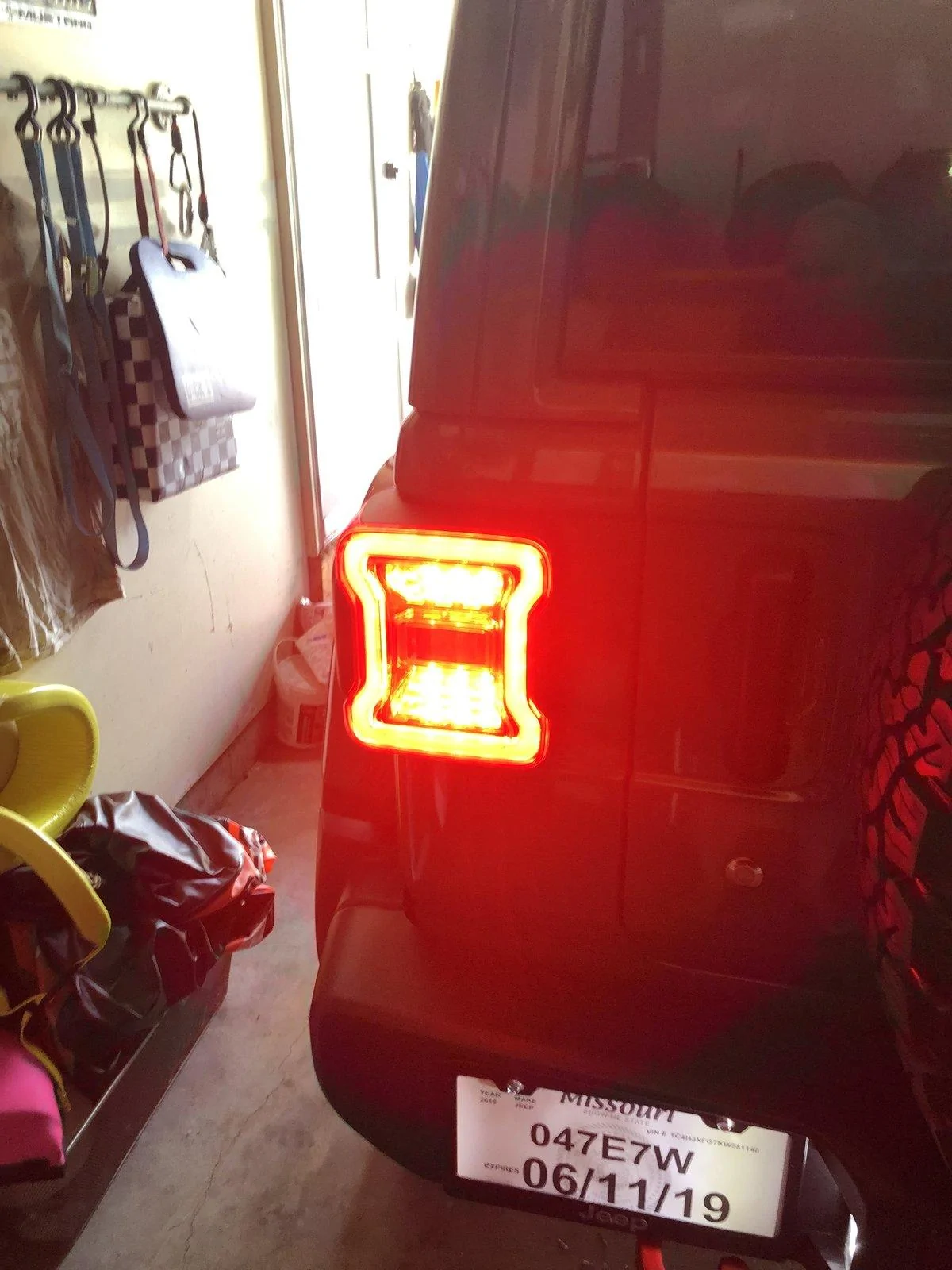

Bought a 2019 JLU Rubicon about 2 weeks ago, and the only package it didn’t have that I wanted was the LED lighting. So I’ve began converting it to OEM LED lighting. I purchased from JeepsAreUs.com the part numbers LEDTAILLAMPSJL, which is a package deal for both rear LED Taillamp assemblies. When they arrived, the individual taillight part numbers were 68434890AB (driver’s side) and 68434889AB (passenger’s side). Easiest install ever, and they were plug’n play right out of the box. No hyperflashing, and all functions work perfectly.
