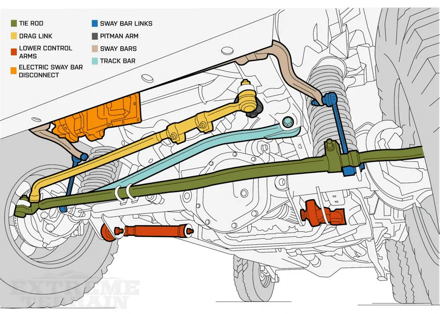

Need to check everything in your steering. Something is loose most likely. Track bar, sway, bar, drag link, tie rod, etc.

First check to see if your front track bar bolts are loose. This is the number one cause of Death Wobble. Also look at your steering gear box. If it is aluminum, which your 2020 should have, then you need to get it replaced with the black in color cast iron steering box. And last but not least, have your alignment checked. More positive Caster will also help to eliminate this. 6 degrees is a good number to shoot for. Your alignment shop will probably have to install lower adjustable control arms to achieve that caster number.

So many things can cause this but its almost always wear and tear. Lots of things that need to be checked off the list. Including:
  • worn control arm bushings (uppers / lowers / axle side / frame side)
  • Worn knuckles
  • bent wheels
  • tie rod play
  • track bar play
  • Steering stabilizer
  • Sway bar linkages
  • Out of balance tires
  • Pitman arm
