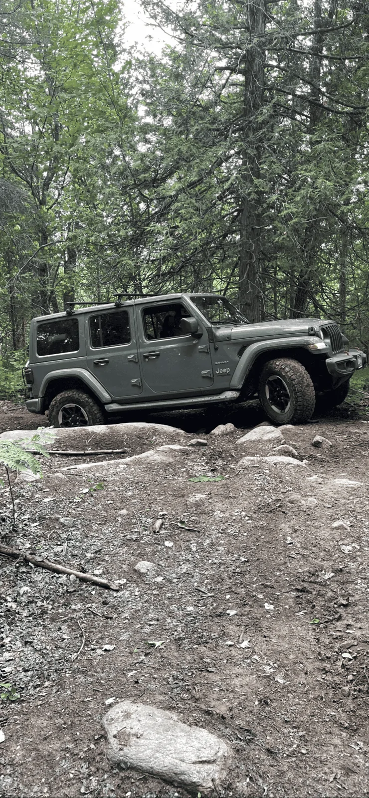

I am pleased with the Rubi take off 33s and K02. I think I could do a small lift to balance it out. Bumper and winch next.
Love the look! I'm thinking along the same lines. Potentially looking for ~1" lift with RUBICON takeoffs.
