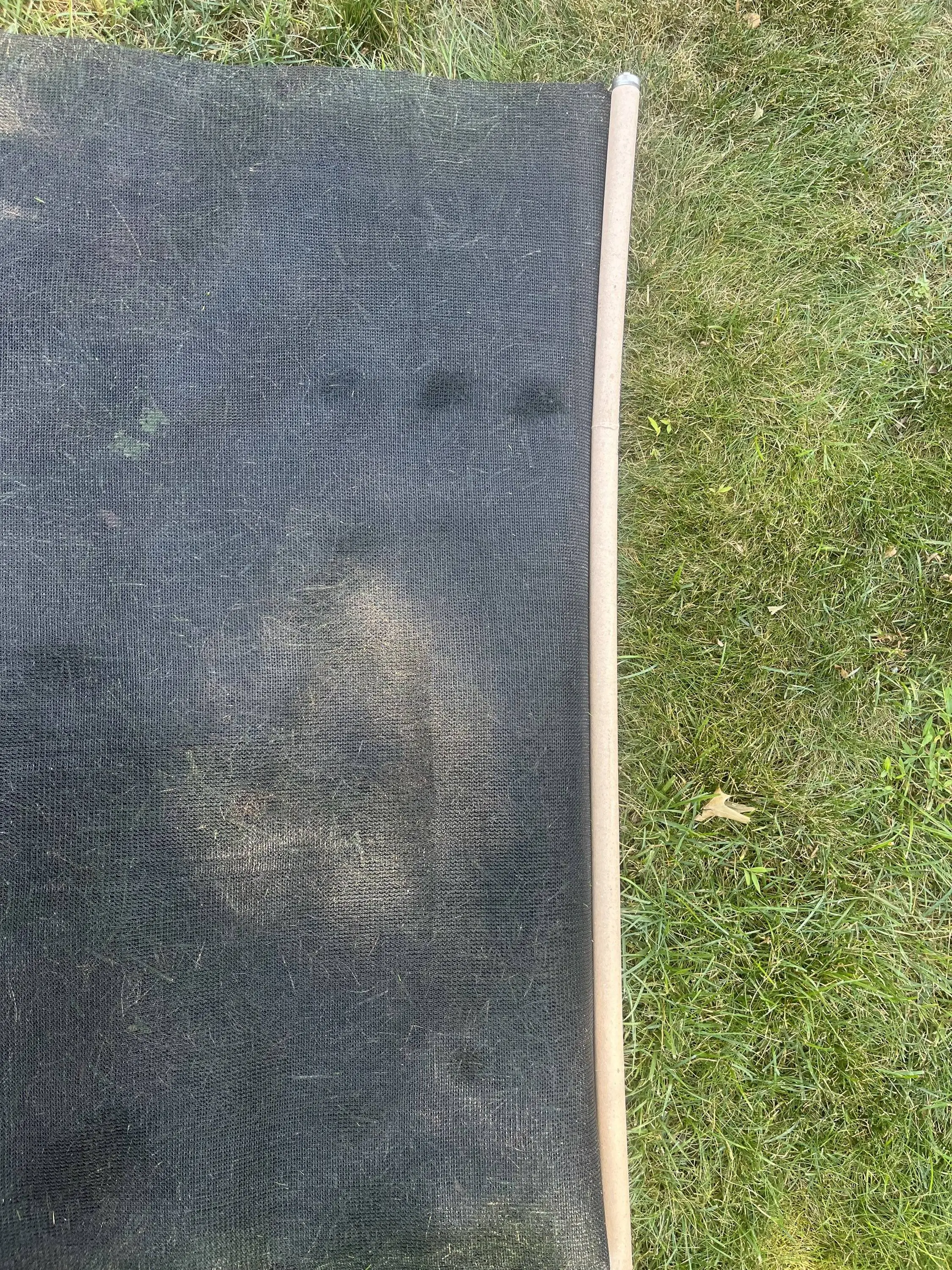

I bought a shade at the Orange store that's slightly wider than the distance between the "B" pillars. I yanked off/discarded the shade and then cut one end of its tube to about the length between the "B" pillars.
From the shortened cut end I yanked out of its closed side the shade hardware and stuck it into the side of the piece below that was open.
I then used contact cement spray to attach some mesh from Harbor Freight that I cut to the shade's width.

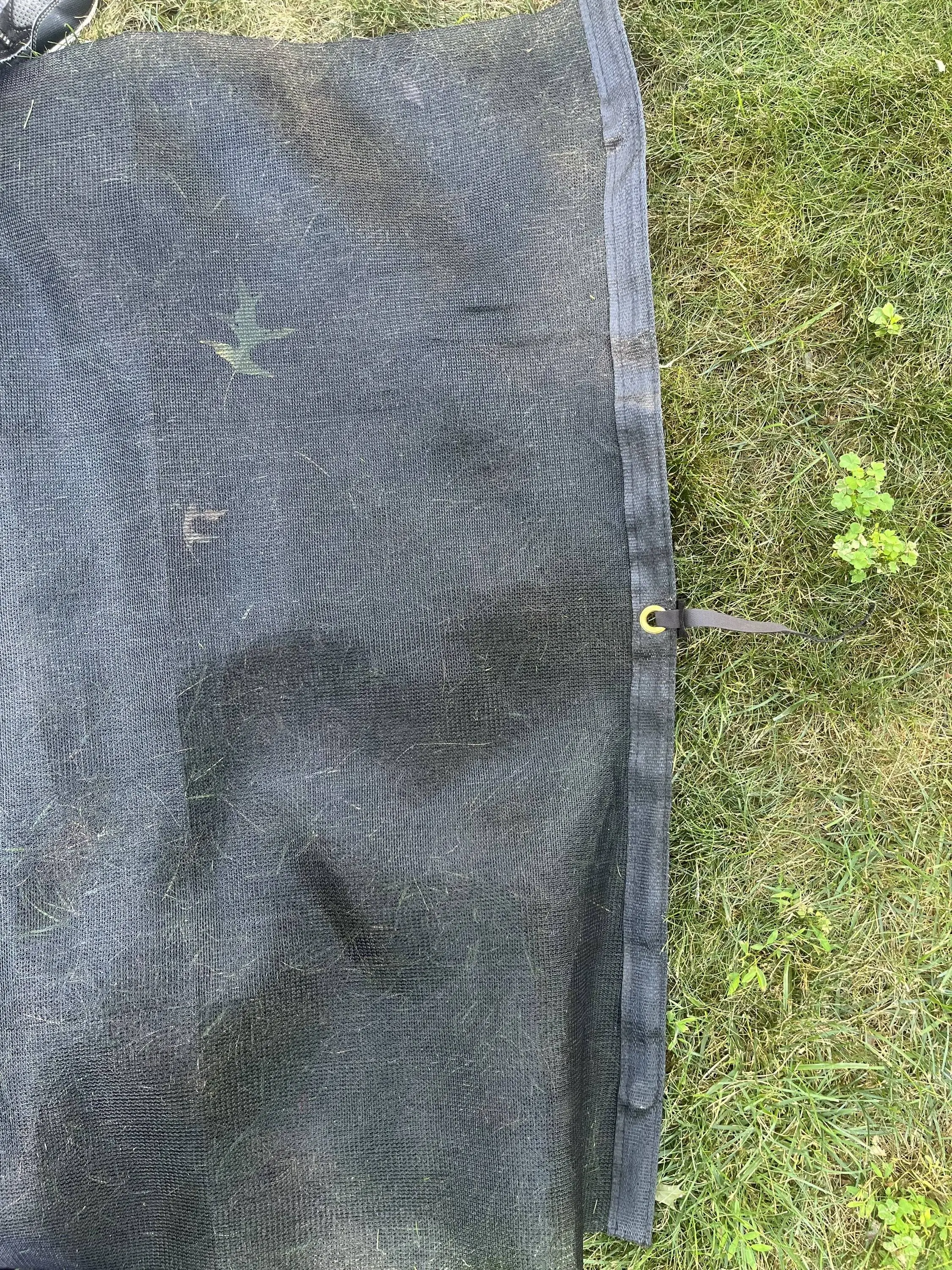

Below's the side of the shade most distant from the roller with the shade flipped over. I think I may have already used a factory hem, but to make your own hem just fold over a couple of inches and grommet the hem into place with Harbor Freight's grommet kit. Inside this hem I've spaced out a couple of 1" rare earth magnet disks that I slipped in from the sides. Put the magnets in before the grommets if making your own hem. The velcro piece in the grommet's used to keep the shade wrapped up when not it use.

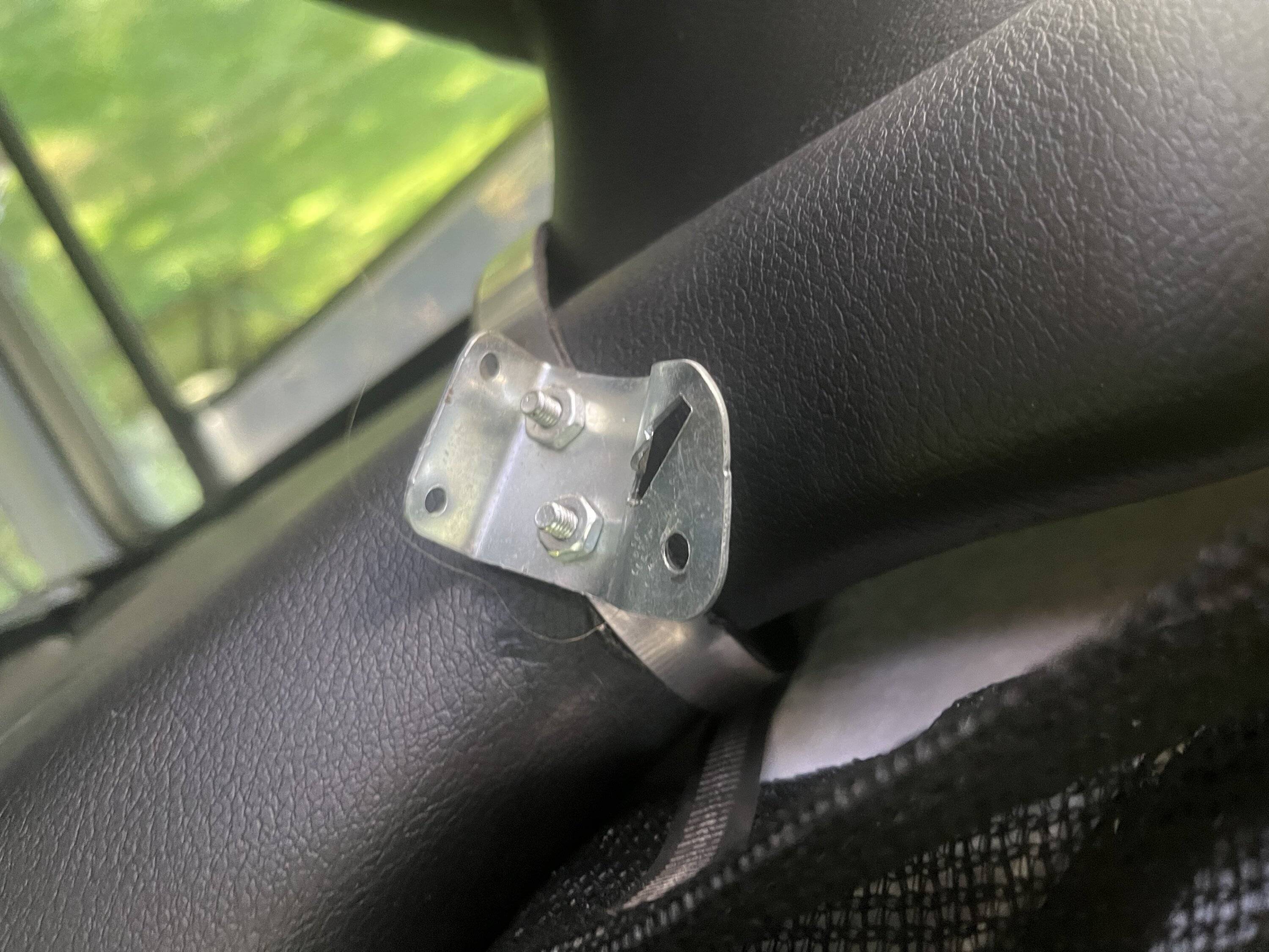

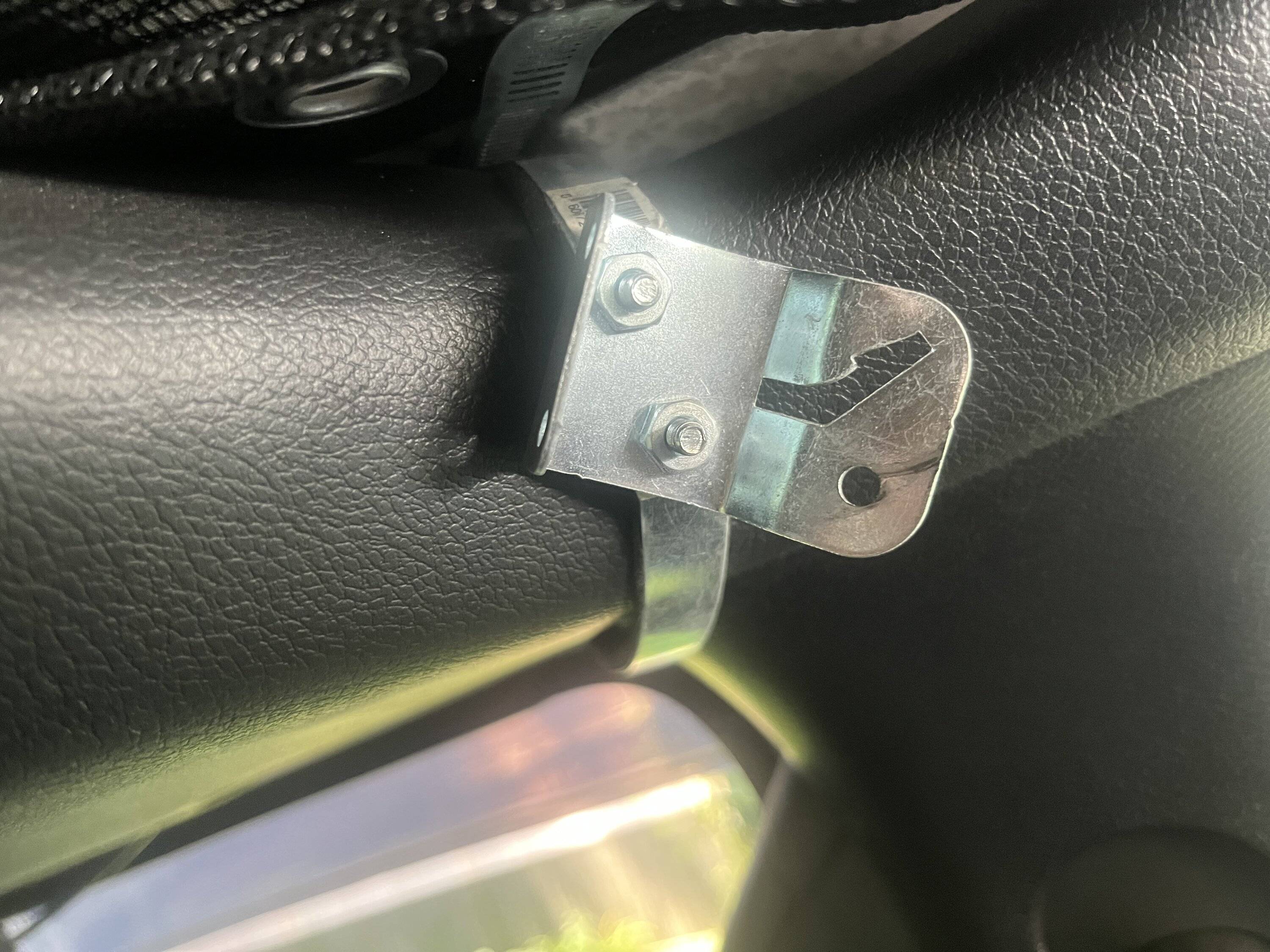

Below is a shade hardware piece (pair purchased separately) with two holes drilled into it on the passenger's side at the sports bar. The adjustable pipe clamp behind it attached to the sports bar has the same two holes drilled into it that with the tiny nuts and bolts shown allowed me to connect the adjustable clamp and shade hardware piece. The shade hardware is universal: same on both sides. One side uses the pin (this side), the other side the slot.
Driver's side:

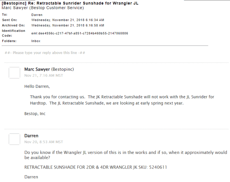

Back in 2018 Bestop told me that they would have the retractable sunshade for the JL in early spring of 2019. ;)
