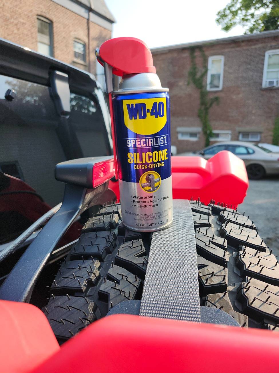

I sprayed the shock slider shafts and the CA bushings now it no longer squeaks! Thank you for the great advice!!
