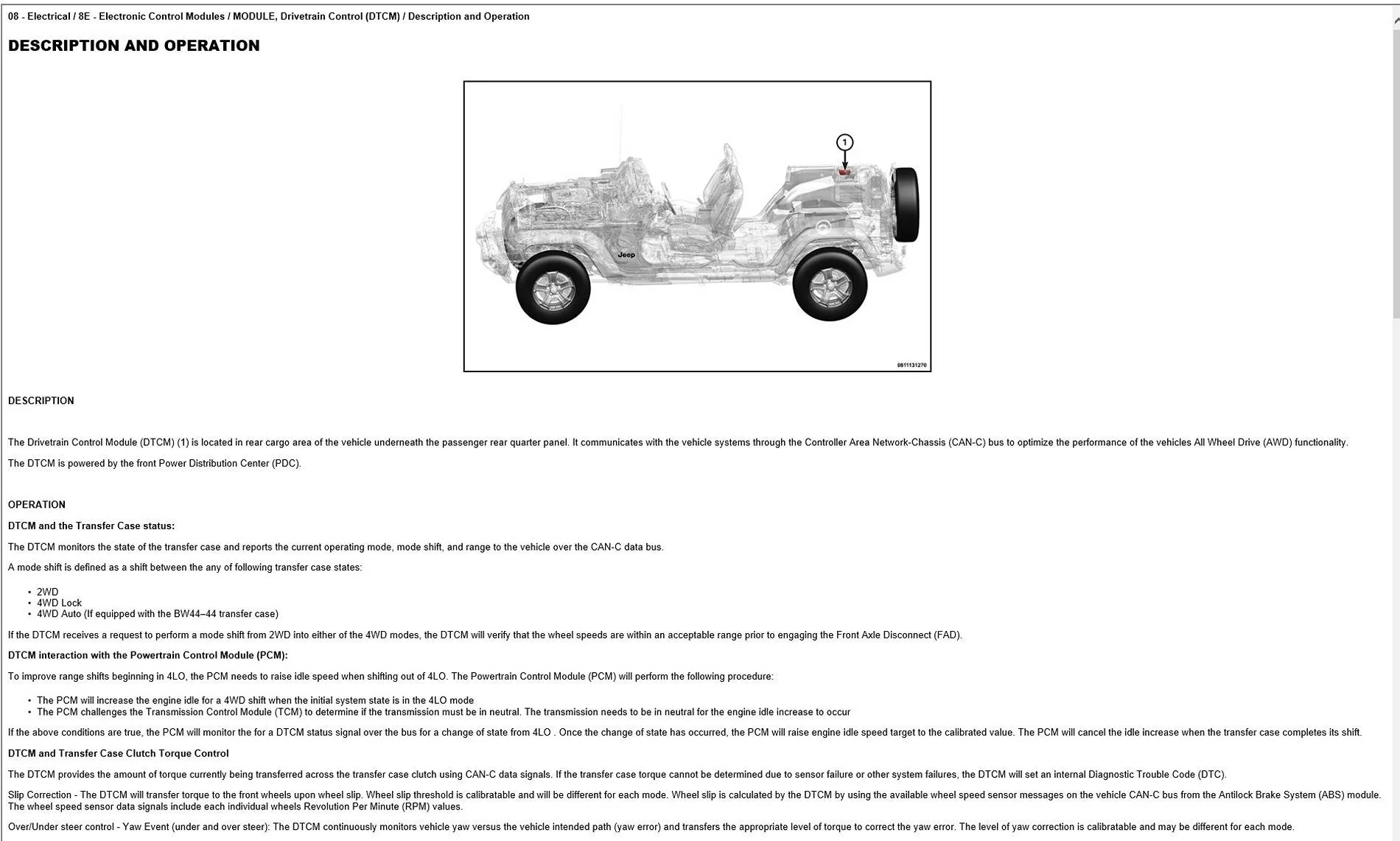

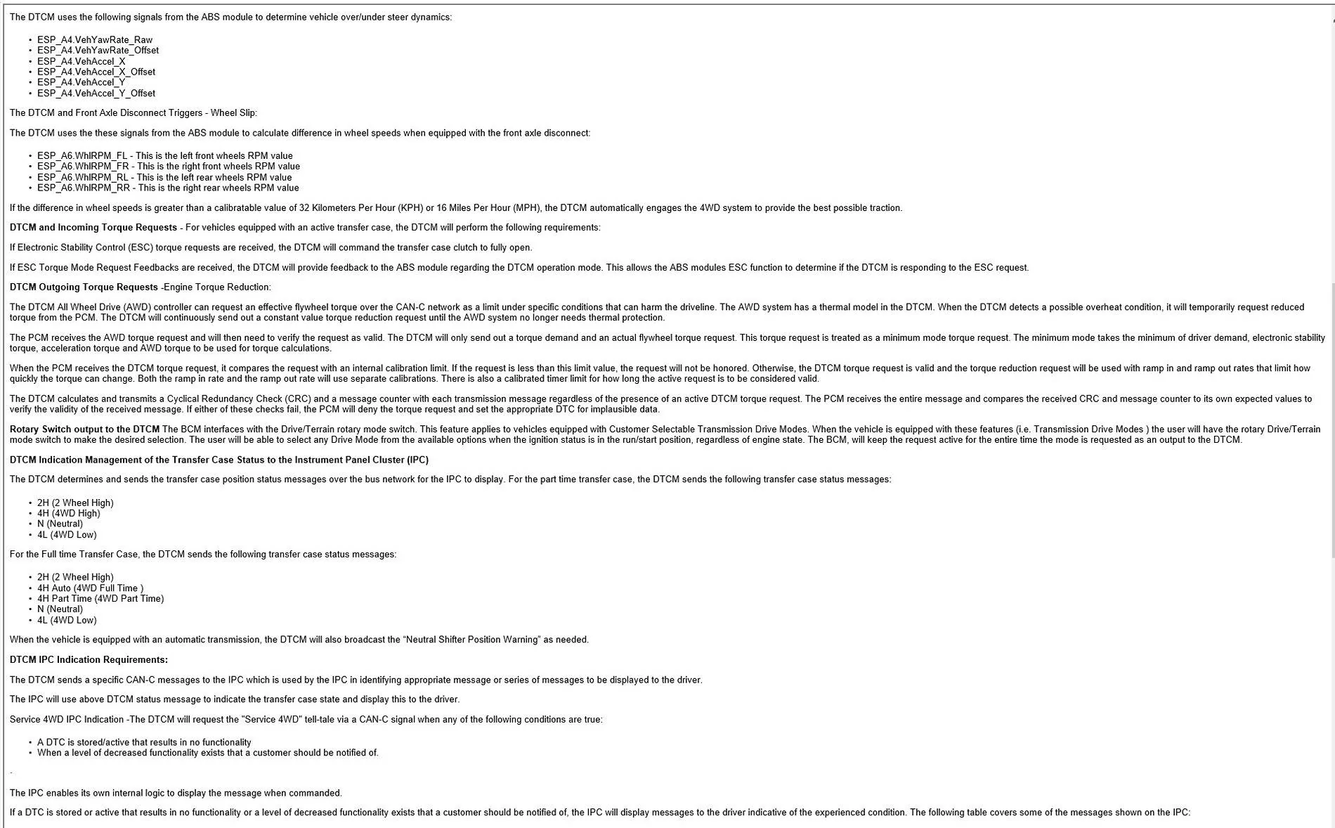

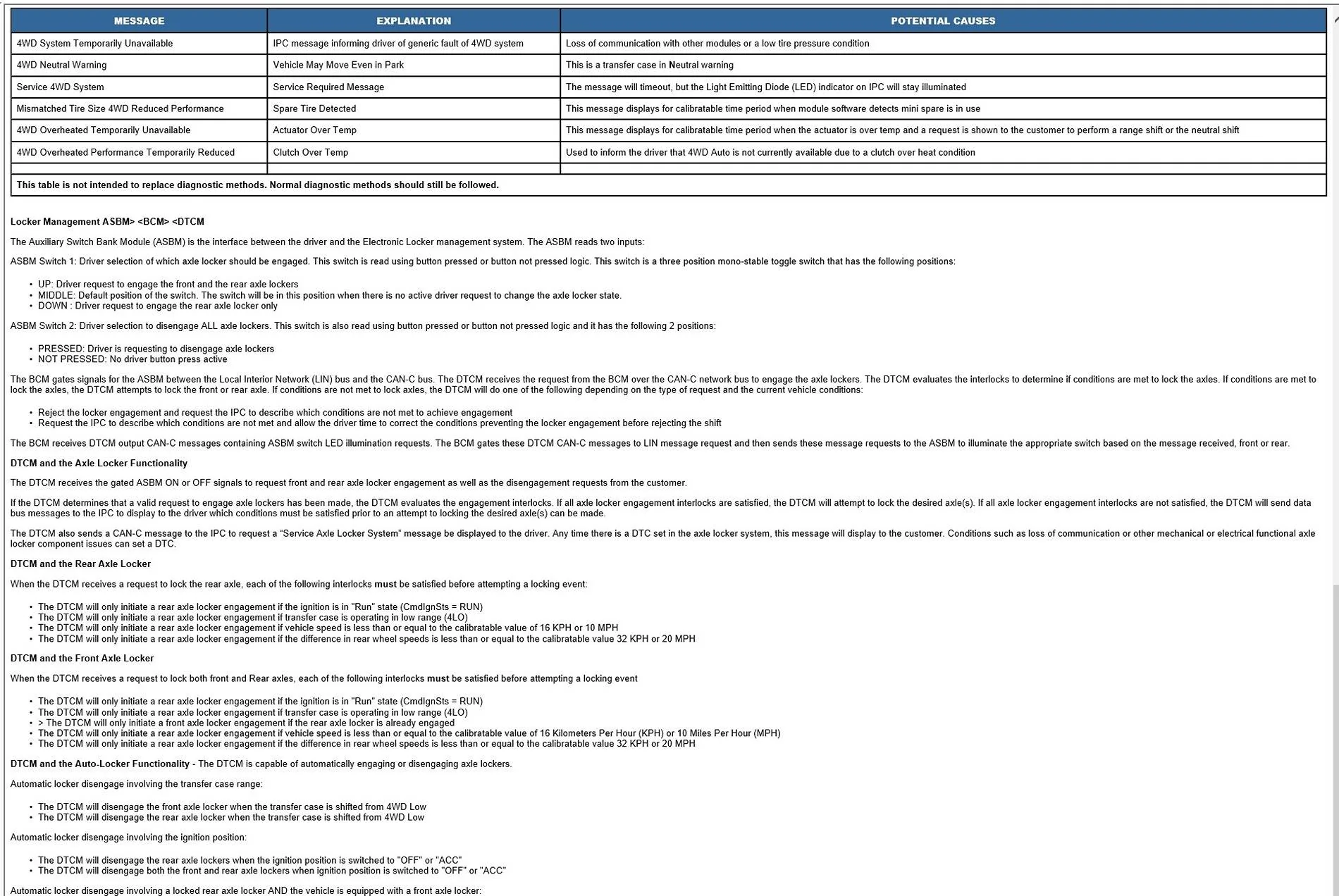

My recollection is that the DTCM (DriveTrain Control Module) is behind the plastic panels in the rear corner.
thank you!
I'm not sure I can help. But, after reading some in the OE service manual, I'd guess that you have a communication problem either with the bus or one of the modules involved. Possibly a code is set if you read them.
Here's my section on the drivetrain control module (DTCM).
Jeep Wrangler JL Jeep shows axles locked DTCM 1
Jeep Wrangler JL Jeep shows axles locked DTCM 2
Jeep Wrangler JL Jeep shows axles locked DTCM 3
thank you! no codes set thou
after reading the description of the dtcm, specially the locker management asbm-bcm-dtcm, I'm not sure the communication problem is at the dtcm, as it only controls the actual engagement of the lockers if I read that correctly and the lockers work fine when I actuate them using the asbm
so now going to read thru the bcm description and hopefully see how it communicates between the dtcm and the ipc/uconnect infotainment system and hope the issue is somewhere in there
