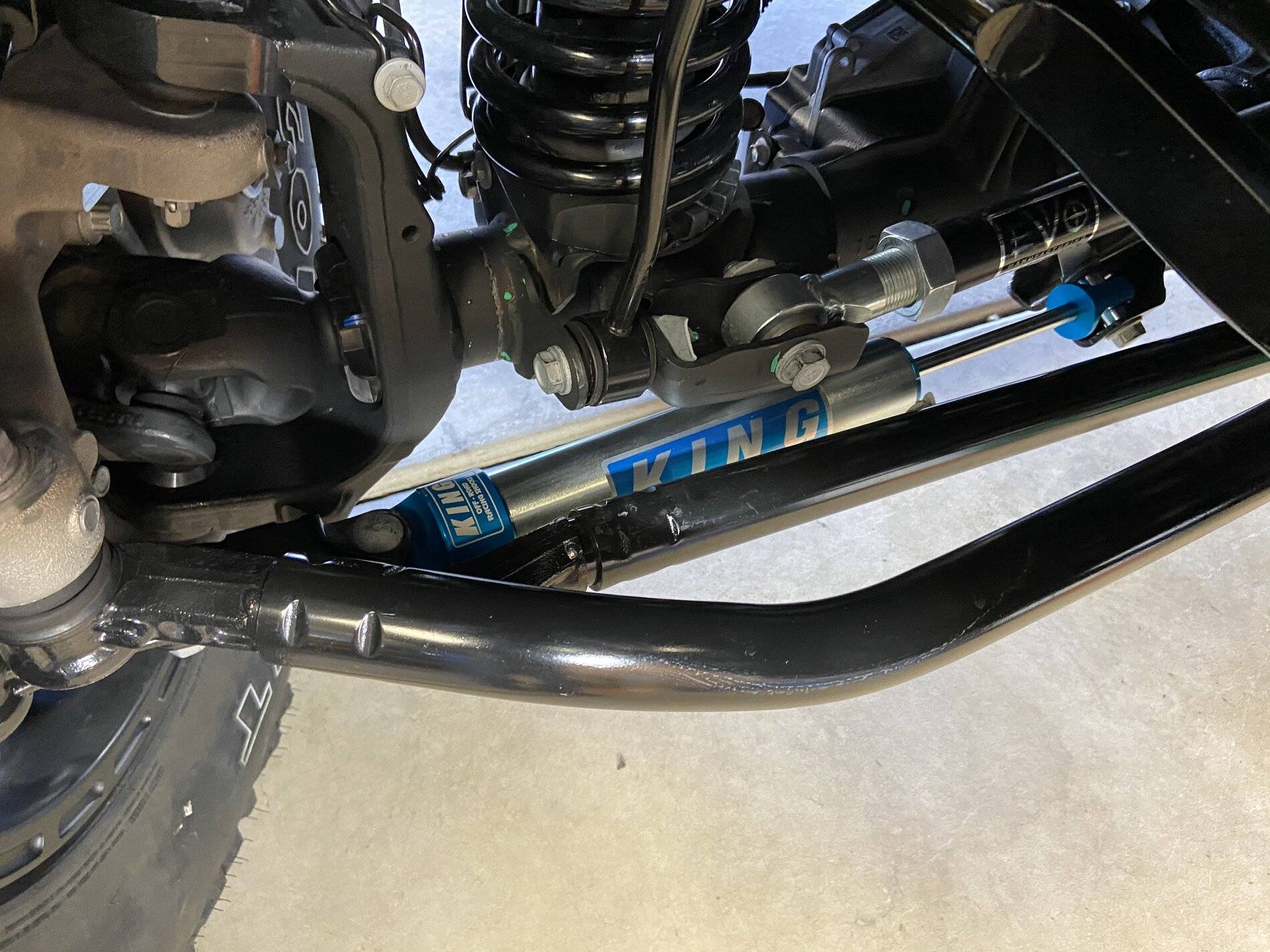

My jeep always drove straight after my evo 3.5 lift, my king steering stablizer came in and ever since the install its always pulled right at higher speeds. My jeep only has 1400 miles on it, so I do not think its anything else causing the issue.
Pull that steering stabilizer. Try to compress it by hand and hold it in a partially compressed position? Feel all that force you have to put into it?
That same exact force is pushing your steering to the right the entire time.
There is no way around it. That is why Jeep, Steer Smarts, Teraflex, Icon, etc sell exclusively neutral force steering stabilizers for the JL. Fox offers both types with their through-shaft being neutral. Why do you think that is?
I know a lot of people will come here and say they have Fox or King pressurized (non-neutral) stabilizers and claim there is no pull. It is impossible for that to be the case, unless their stabilizer is low on pressure. The pressure/pull is always there. It is just a matter of how much pull and how sensitive you are to it.
Friends should not let friends put non-neutral stabilizers on their JLs. Sell that King to a greater fool and move on to a neutral stabilizer.
