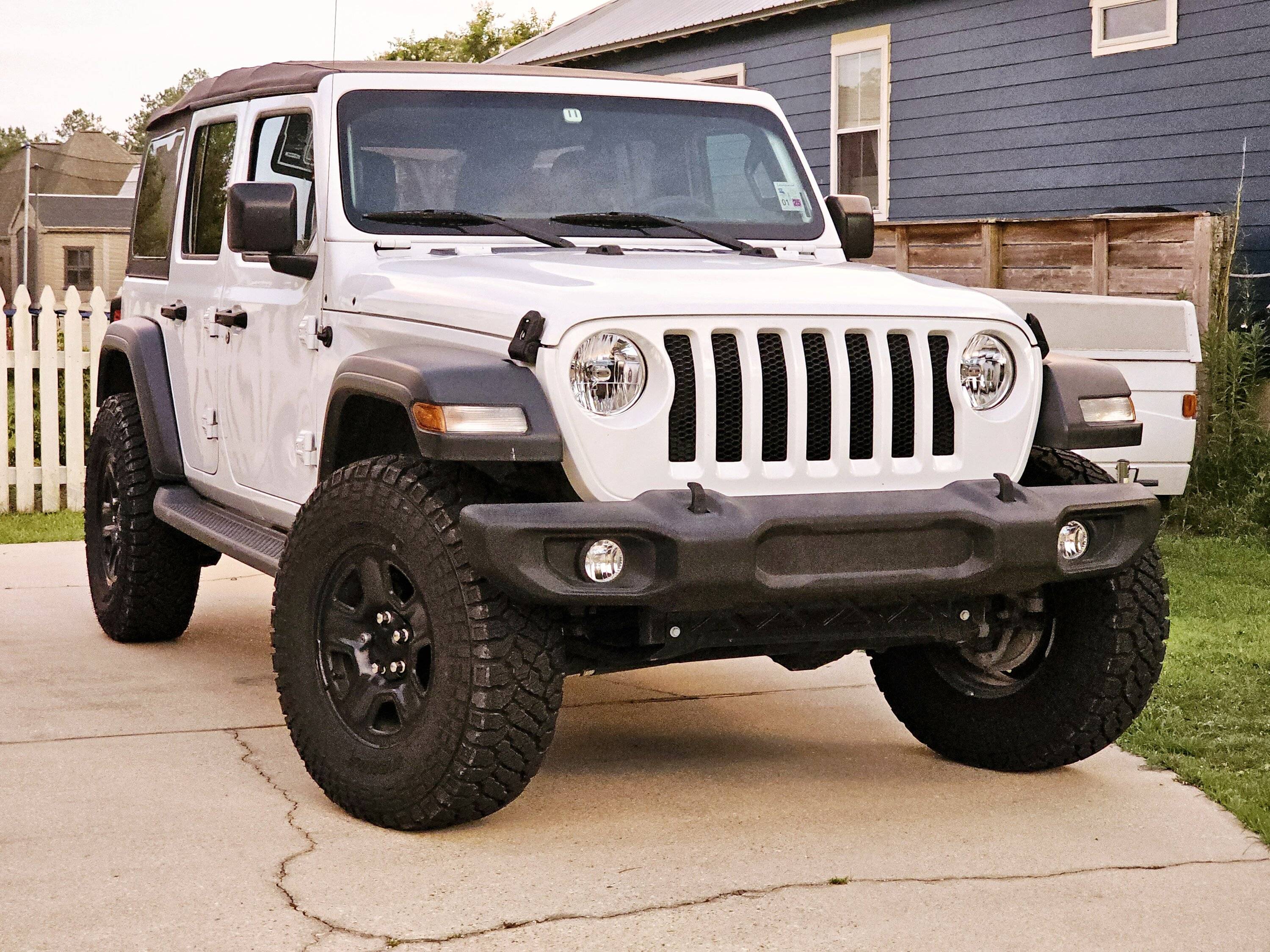

Several months ago I installed a 2.5" RC spacer lift. ( Yes, I know there are much better out there. Yes I'll upgrade when funds allow down the road). All has been great. No pull to the right at all after lift went on. Steering was flighty in high winds and bumps. So I installed the Rancho geometry brackets last week. HUGE improvement in driveability, but it now has a slight pull to the right. I have readjusted the drag link to center steering wheel, but pull is still there. Any ideas what this could be?
I have checked and rechecked psi in tires. I'm running 30 psi in all 4 and have been since lift went on so I don't think it's a PSI issue.
- can an alignment be done without have adj. Control arms to diagnose and fix this?
-should I loosen all bolts on the geo brackets again and let it settle back in and retorque everything? (To note, the Rancho brackets were installed on the ground and not on jack stands)
Thanks in advance!
