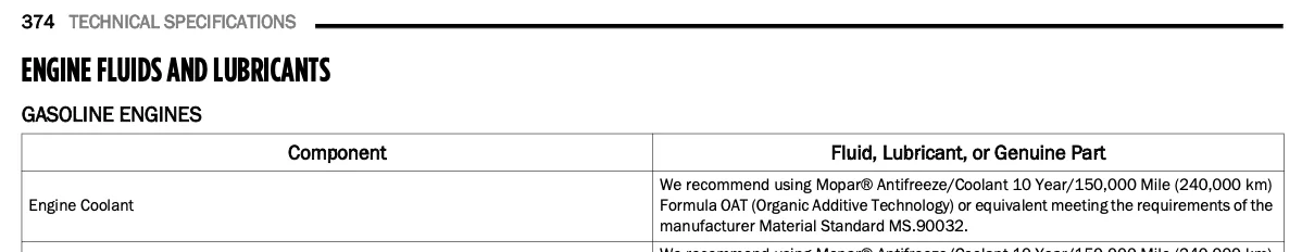

Unless otherwise noted in the owner's manual for your Jeep.... technically you're not yet due for a coolant flush. Be sure to follow the spec when you do.
Jeep Wrangler JL `Jeep JL Power Steering Fluid Screenshot 2023-06-21 at 14.33.52
On the electro-hydraulic power steering maintenance, I don't see an interval listed in the owner's manual for a flush. If yours is significantly darker/more dirty than new fluid, I'd say it's worth looking at having done.
