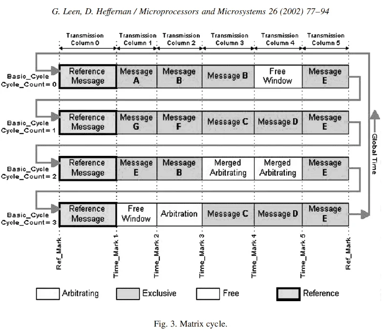

I recently came across a few interesting topics:
Discussion of FCA's Secure Gateway Module - It talks about the specific event that the Secure Gateway Module was a reaction to, it's intended purpose, and the ability to remove and work around it (if you can't get a real-time authorization through FCA's servers). I stumbled across an article which covers this same topic, but from a slightly different angle.
TTCAN (Time-triggered CAN) - I've tracked any number of CAN message which fire off like clockwork (like with the ambient temperature reading updates every second), and other CAN messages that only trigger on specific events (like codes from using the remote keyfob buttons). They're very well coordinated and they're using something beyond the CAN protocol to do it. I think it might be this TTCAN protocol. I see that the CANopen protocol goes several steps further, but I can't find anything that makes me think the Wrangler is using that.
CAN 2.0A / 2.0B - Us nerds would call this a CSMA/CR (Carrier Sense Multiple Access with Collision Resolution) network protocol. There are tons of documents out there on everything from a basic introduction to vendor CAN controller documentation to the specifics of modern-day vehicle wiring. I'll try to summarize the important parts:
CAN is a broadcast network. (Everyone can always see every message.). Messages have an ID and a payload (1 to 8 bytes long). Members automatically synchronize and prioritize the next message using "bit dominance" which allows the module with the lowest message ID to "win" and transmit it's message right away. If all members are following protocol, it actually prevents two senders from talking over each other.​
Messages are physically transmitted across a pair of two twisted wires which are always send opposite signals from each other. Us nerds call it differential signaling). When one wire transmits a signal, the other wire doesn't. When one wire stops transmitting, the other wire starts transmitting. These simple mechanisms make for a really strong signal that's immune to many common forms of interference (cut wire, grounded wire, cell phone interference, etc). A notable exception would be that which is caused by corroding terminals. (Even if you have a snorkel, try to keep your Wrangler dry behind the glovebox.)​
When any module uses those wires to send a message, they do not have to identify who they are. Instead, they provide an ID number which identifies what kind of information they're sending. As an example, a module might suddenly transmit ID 122 with the numbers 00 01 00 00. Your radio, your dash, your gear shifter, and all the other modules which care to do something with ID 122 will learn that they vehicle's ignition switch (that push-button switch) is in the "off" state. None of them have to ask because the steering column control module will broadcasts every second the latest status of the vehicle ignition with message ID 122. Should the position of the ignition switch change, it won't want that full second before sending it's update. Because it could be important to update that information quickly, it'll send another update right away whenever it's status has changed.​
Finally, there is another feature in the CAN network where any module can actively ask the "owner" of a specific message ID to send a new message with their latest update. If you're creating a electronic dash, you don't want to rely on that every half second or so to keep asking "What's the tachometer at? How fast are we going now? What's my odometer?". So far, it looks like Jeep elected not to follow that specification. It's probably a better practice that they don't.​
That's all I got for now. I'm still fighting that issue with the two-channel CAN module. I've gotten a response from Waveshare and they're taking a look at it. I might try downgrading to a Raspberry Pi 2B or 3 and seeing if that helps the issue any. Short of that, it may just be time for me to put these Waveshare modules away and try PiCAN or one of the other CAN HAT vendors.
EDIT TO ADD:
I'm still reading up on TTCAN and I strongly believe that this variant is what's used on the Wrangler. (If not, I've come up with the FlexRay and TTP as similar time-triggered networks worth investigating.) Based on TTCAN, on the CAN-C bus, the time masters would likely have IDs 400, 401, 402, 403, 407, and *maybe* 409. On the CAN-IHS bus, that would be IDs 401 and 403.
These time-triggered networks (operating on top of a CAN network) may explain even more why JScan and Tazer have so much trouble with retransmits. CAN normally lets transmitting participants determine for themselves (in a method that's based upon the IDs used by the transmitting nodes) who gets priority and transmits. On TTCAN, I think JScan and Tazer may not know that CAN negotiations only happen some of the time, potentially messing up the message of the module that was originally authorized to transmit, re-queuing their own failed messages for retransmission, and then retransmiting the message yet again (and just as likely, at the start of yet another time window that they're not permitted to transmit in).
It's against spec to be transmitting in a valid CAN window while transmitting in an invalid TTCAN window. The upside here is that 100% available windows and lesser available windows (subject to a limited number of CAN negotiation attempts), are both at pre-regular times which are pre-determined. There's no need for guessing. Both tools have the potential of significantly increasing the reliability and perhaps even the speed in which they send information to the vehicle. It'd just be time-consuming to program and test for it.

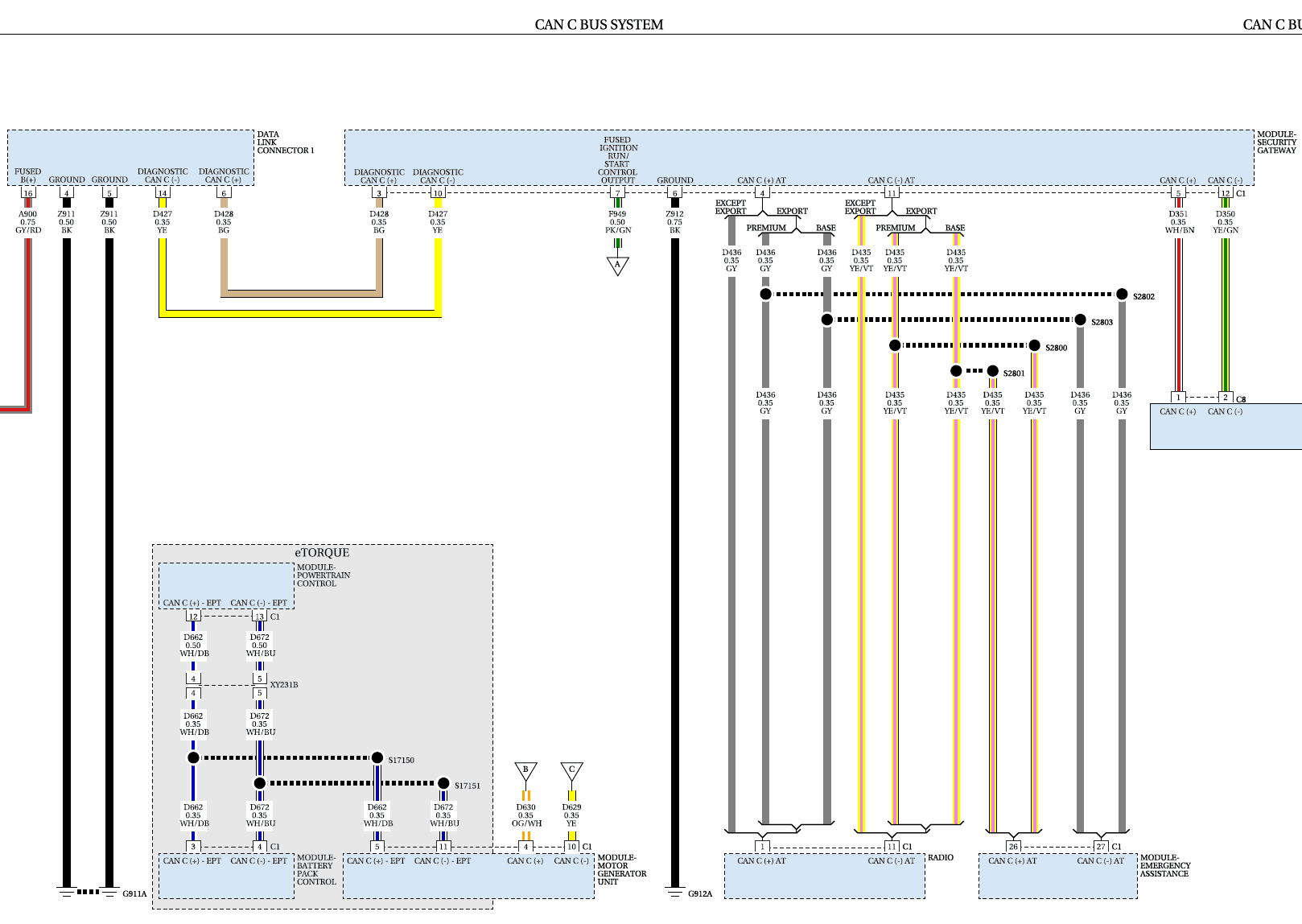

Today I believe I have a better high-level understanding of the Secure Gateway Module, it's purpose, and it's relationship with the OBD-II port (what Jeep calls the DLC, or Data Link Link Connector) as well as it's relationship with the uConnect radio.
At the bottom of this message, I've included a diagram of the DLC connector (including pinouts) as well as both connectors to the Secure Gateway module. But the what I really want to reference is one of the Wrangler's wiring diagrams.
Below I have pasted a portion of the CAN-C bus wiring diagram. (For our purposes, we can assume that the CAN-IHS bus is wired in a similar manner, so I've not included it.)
Jeep Wrangler JL JEEP HACKING CAN-C / CAN-IHS / UDS ! (Reverse Engineering) CAN-C Wiring with SGM and DLC
The Secure Gateway Module (SGM) receives an ordinary connection to the vehicle's main CAN-C and CAN-IHS bus. What the SGM does is it stands between the radio and the reset of the vehicle. Separately, it also stands between the OBD-II port and the rest of the vehicle. It acts as two separate firewalls with two different sets of rules, designed to limit and protect access to the CAN network.
The Secure Gateway Module allows third-party OBD-II tools to listen in on everything that's happening on the vehicle's two major buses. But when these OBD-II tools try to write to the CAN-C and CAN-IHS bus (for example, they might send a command to bleed the brakes), it prevents it. Not unless they authenticate themselves in a special way that Jeep built into the system. Obviously, some vehicle technicians have questioned if this might be a little self-serving of Jeep, requiring some third-party tools to seek authorization from Jeep to fully function on their vehicles.
At the dealership, when your vehicle is being serviced, a tech will make a connection to the OBD-II port. Aside from being able to read parameters from your vehicle, this can also allow Jeep (corporate) to send a special message to your Secure Gateway Module, authorizing the technician's tool to have read and write access to the vehicle's CAN-C and CAN-IHS bus for a limited time.
I suspect (but have not yet validated) that something different is happening with the Secure Gateway's Module's connection to the radio module.
The uConnect radio normally IS allowed to write certain configuration changes to the CAN bus (where it is stored and relayed by a separate module). For example, when you select the setting on the uConnect touch-screen which enables a horn honk when remote-locking your vehicle, the uConnect radio broadcasts that configuration change to another CAN module where it is permanently stored and made available to other modules. But there are certain other messages that your radio should never be sending (for example, a message that contains the angle of the steering wheel, or the current engine RPMs).
Pre-approved messages on a whitelist ARE allowed. Anything that isn't pre-approved is filtered out. And this is to maintain the security of your vehicle in case the uConnect radio gets hacked (via it's own cellular conection, or via the USB ports, for example). Theoretically, it may be possible for Jeep (corporate) to use the uConnect radio to remotely flash updates individual components on your vehicle (like the transmission). I don't know for certain if the provisioned this capability in the Secure Gateway Module or not, or if they've taken advantage of this in the past or not.
Back to the Secure Gateway Module, when an owner replaces it with a bypass cable (or a Tazer), it does two things. First, it makes full access to your vehicle's CAN networks available via the OBD-II port. Any tool that plugs into the OBD-II port now has full CAN access. I imagine that Jeep wanted to prevent this, as it wouldn't be too difficult for a third party to create a small inexpensive OBD-II plugin that sends a few signals in a matter of seconds, and once it is removed, it will have silently made changes to your vehicle's configuration that completely disables it (or worse).
Second, it gives full CAN access to your uConnect radio. Not too long ago, students of cyber security at the University of Tulsa hacked the uConnect radio of an FCA vehicle, giving them remote access to the vehicle's bus (over the vehicle's own built-in cellular connection), allowing them to do things on command, such as completely preventing the brakes from working. In short, the Secure Gateway Module makes it harder for your vehicle to be hacked, and and it makes it harder for your vehicle to be monitored or operated remotely.
So this explains why a Secure Gateway bypass cable is needed for a tool like JScan (which connects to the OBD-II port) to be able to make configuration changes and to perform some of it's adaptation functions. The cable gives it direct access to both CAN networks, and not the filtered read-only access that comes from the factory.
In the case of the Tazer (which replaces the Secure Gateway entirely), this gives it Tazer itself direct access to both CAN networks. Although that position makes it possible for it to maintain separate connections to the uConnect radio and the OBD-II ports, most likely it simply bridges all three connections together, giving itself and everything else full access to the vehicle's CAN networks.
Originally, I had a theory that the Tazer performs some operations by intercepting the signals and modifying them in-flight. When I can, I try to support or refute any theories I've developed (and shared) along the way. While that's possible, that's not what's going on here. That theory is wrong.
I now know that the Tazer performs makes many of it's configuration changes by writing them to specific BUS IDs where the vehicle ordinarily stores them. I have yet to see how certain operations like the Light Show are done, but during that time, I happened to see CAN messages with IDs in the 4Cx, 5xx, and 7xx ranges, which typically aren't seen.
The part of the vehicle I've chosen to focus on is behind the glovebox, which offers direct access to two of the vehicle's 13-way CAN bus connectors. There's still plenty of space for my components, and anything too large can still be placed in the glovebox itself.
Numerous items already plugged into some of the ports, but there are still a number of open ports available, any one of which can provide the access necessary for my own tools. An advantage worth noting is that any one of these open ports can be used without disrupting any of the other existing third-party tools like JScan and the Tazer.
This final benefit of this area is that it also gives us the potential to isolate any of the the major components which plug into the 13-way bus connector. Once isolated, any of those modules can be listened to (or have their signals intercepted and modified) on an individual basis. While those opportunities aren't my immediate area of interest, it's clear to me that they have the potential to create new possibilities that we haven't seen before.
The major downside? While it is a little less convenient to access than the OBD-II connector., it's major problem appears to be that there's no direct source of power in the immediate area. (If I'm overlooking something, please, add what you know!) Power might be routed over through the center console or through the engine bay, but there doesn't seem to be major 12v feeds to tap into.
So, I hope this information helps someone along the way when they go to look at the OBD-II port, Secure Gateway Module, or one of the CAN bus connections as their source for vehicle connectivity. I've typed quite a bit here, so I might have made a mistake or two along the way. If so, let me know.
For completeness, here are diagrams of the OBD-II and Secure Gateway Module connectors, with labels for each pin. Where you see a "DIAGNOSTIC CAN C" or "DIAGNOSTIC CAN IHS" bus, those are the the filtered bus lines for the OBD-II connector. Where you see "CAN C AT" and "CAN IHS AT", those are filtered bus lines for the radio module. (Maybe someone else knows what AT stands for?)
If you've read this far, wow, you must be interested! Thanks, and any comments are welcome.
Jeep Wrangler JL JEEP HACKING CAN-C / CAN-IHS / UDS ! (Reverse Engineering) DLC Pinouts for 2021 Wrangler
Jeep Wrangler JL JEEP HACKING CAN-C / CAN-IHS / UDS ! (Reverse Engineering) Security Gateway Connector C1
Jeep Wrangler JL JEEP HACKING CAN-C / CAN-IHS / UDS ! (Reverse Engineering) Security Gateway Connector C2
