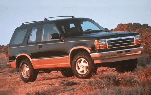

I did the same thing in high school in my dad's brand new 1993 Eddie Bauer Ford Explorer. Left the mud hole and immediately got the battery warning. Spent probably 2 hours at the nearby car wash cleaning off all the mud. Or so I thought. A few days later my mom opened the rear liftgate and the outer edges were coated in hard mud. The one place I forgot to clean. It was a while before I was allowed to drive it again.
