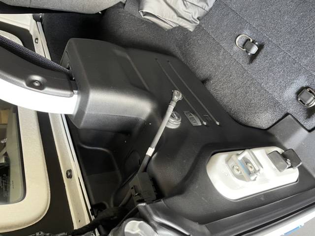

I just noticed that there were a couple of leads/pipes in the back of my new JLUR that don’t connect to anything…one, the electrical connection, was obvious as there was a matching plug to connect it to…have just snapped that back in place. I can’t see where the ‘pipe’ goes…I assume it runs water to the rear wash/wipe and I also assume that it disconnects here to allow the roof to come off, but I can’t see where it reconnects to…is it under the black trim that the electrical connection disappears under? I don’t want to start taking things apart just to find out that it’s not ;-).

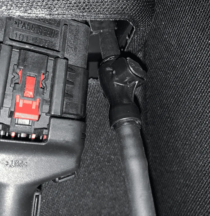

I don't know exactly on the JL (I haven't looked close enough yet!), but on my TJ it goes beside the electrical plug. I'd look around the electrical plug for a hose barb.

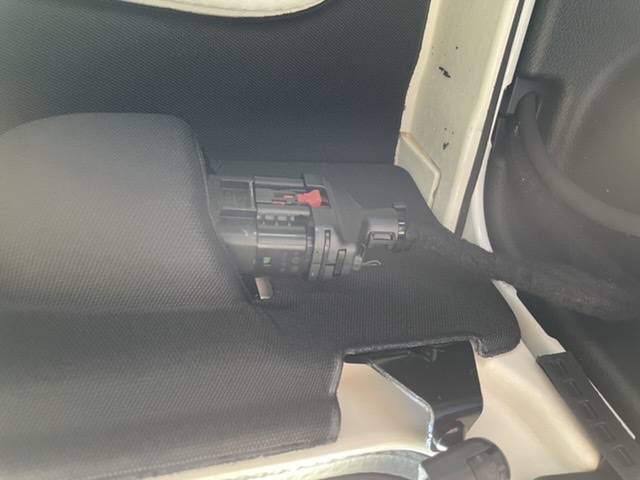

Connects right next to the elec connection

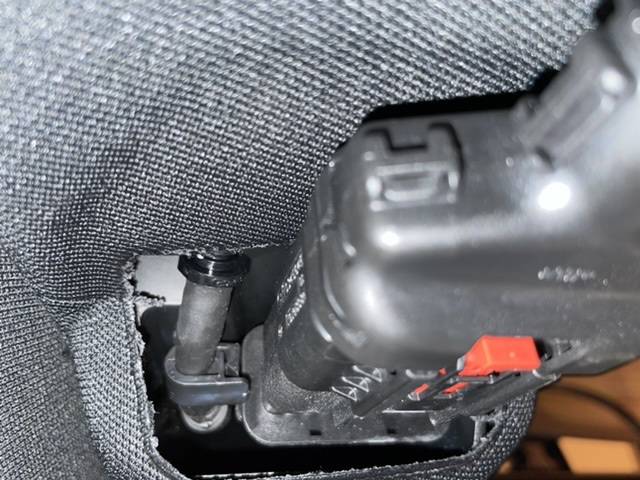

Thanks, I couldn’t see the hose barb because it was tucked behind the trim, but I got my camera into the space and found it, managed to fish it out and reconnected it…all fixed!

Cool. And your comments above are correct. This line is the water for your wipers. When taking the hardtop off be sure to disconnect both the water and electrical 1st.
