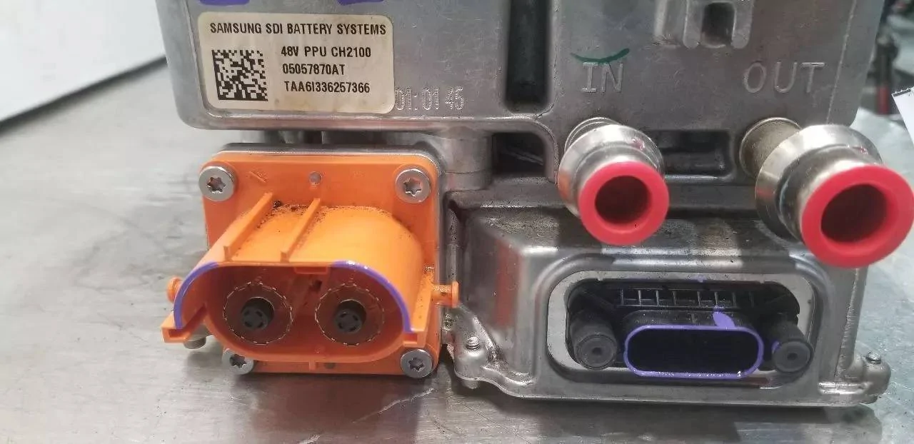

Hi there Jeepers,
i own 2022 XR with 50K Km. its E-tourque battery died. i
few Q:
1. WHAT is the avarage cost of a new one?
2. is it simple to replace (or any "coding" to the jeep ECM is needed?)
3. is it covered as part of the jeep warrantee period (for 5 years?)
much appreciate your help!

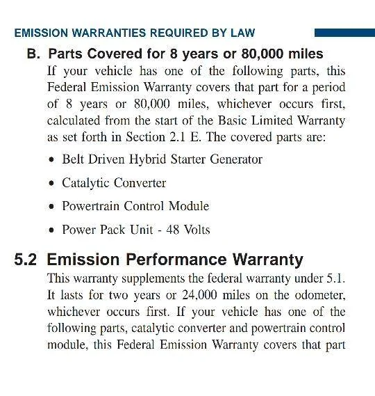

Not sure the cost but it’s covered by an 8yr/80,000 mile warranty. See thread I linked below and screen shot.
Did your main battery die also? If you haven’t replaced the OEM main battery it’s probably time.
I have a 2021 3.6 eTorque w/ 38k and just recently noticed the start/stop feature coming on less and a few random quirks with the radio infotainment. Turns out the battery was starting to go. Not dead but not good enough so I replaced it with a new one. The S/S now works all the time. My theory is that when the main battery goes it puts added stress on the 48v so I’d check it or replace it as preventative maint.
https://www.jlwranglerforums.com/forum/threads/e-torque-and-48v-battery-warranty-question.17413/

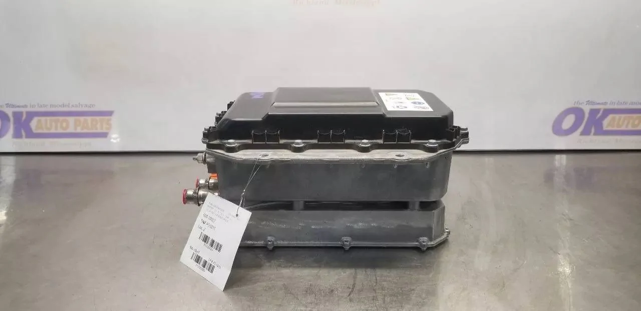

Rubitrux sells nearly new take offs fairly reasonably.

Unfortunately, if you're not in the USA, a federally mandated warranty might not apply to your Jeep...

Its a good point, but isn't it something the manufacturer standardized world wide? (after all, the faulty part is sent back to them and they replace it with new)

The battery itself is "probably" the same worldwide, but the law may only require that it be replaced in the US, or possibly even Canada. (Other countries probably don't care about our laws that much!)
That being said, I'm not a lawyer, nor an automotive engineer!
